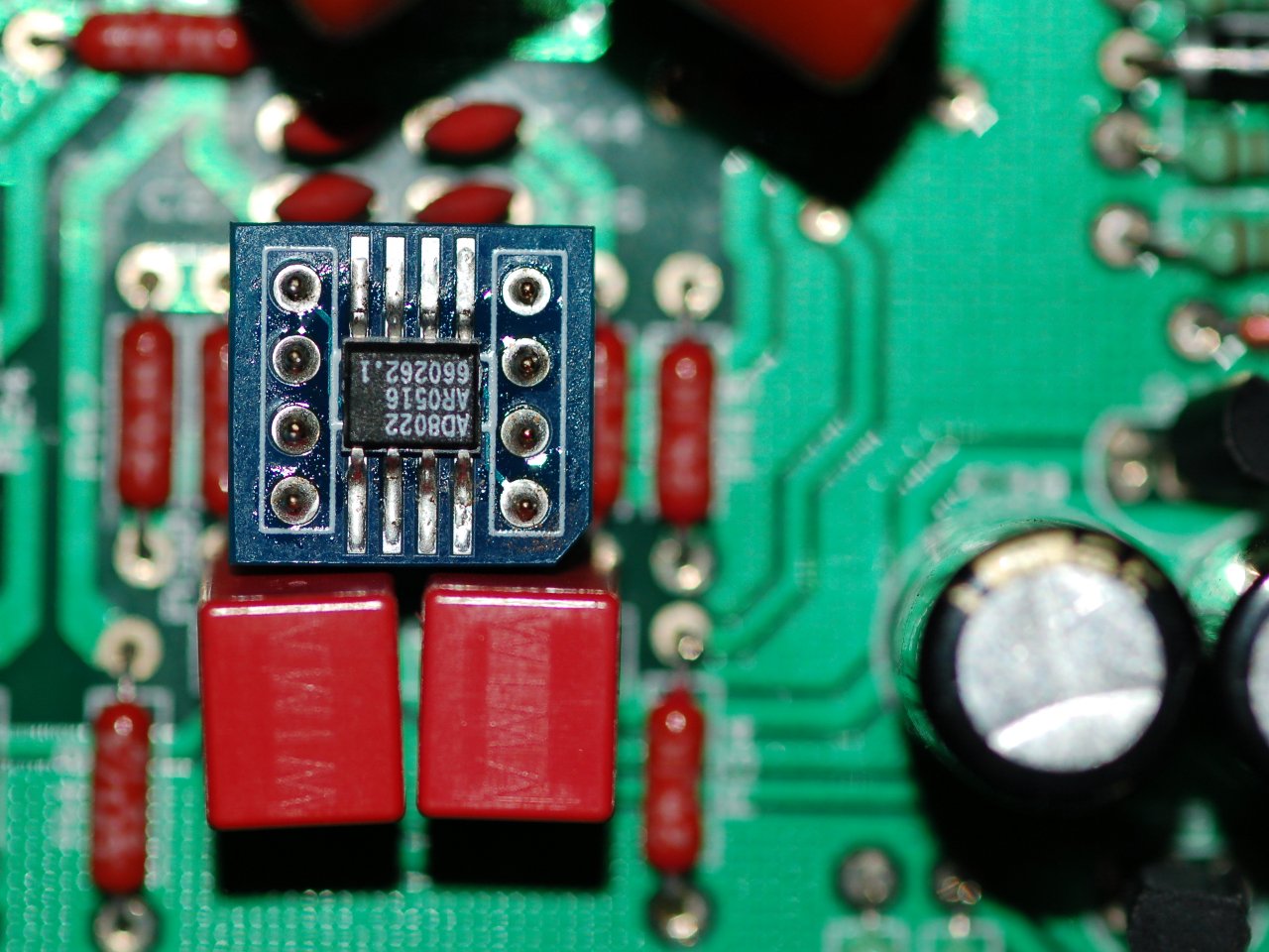

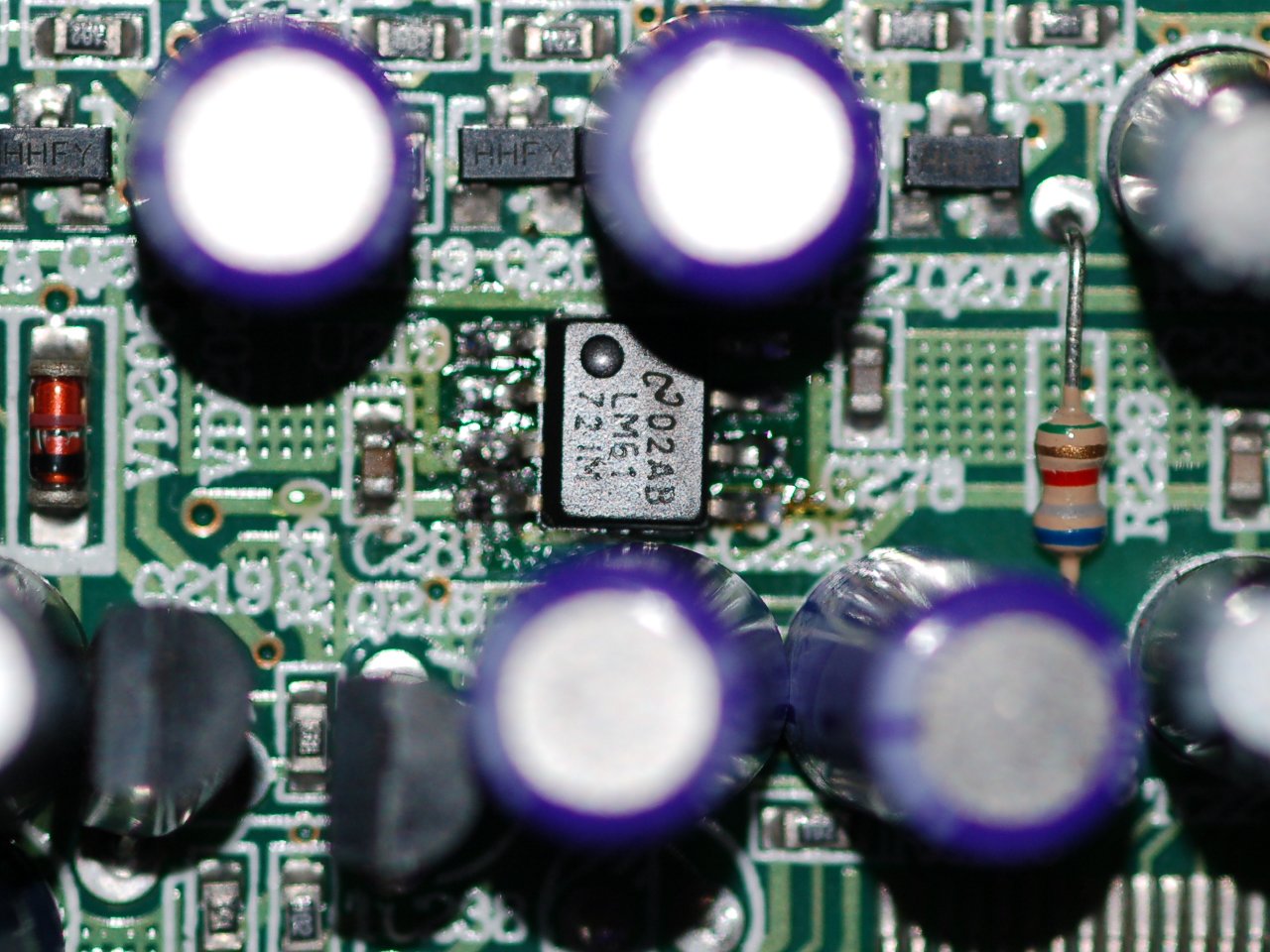

Old thread - just posting my Azur 540D DVDP mods for reference here. There are 3 sets of mods that I performed:
1. SMPS/PSU mods: Nothing exciting, just replaced all electrolytics on the secondary side with a combination of non-aqueous professional grade Japanese electrolytics like Panasonic FC, Nippon Chemicon LXZ, Nichicon PW and Sanyo Oscon. All values are retained the same as the original *except* 2x 1000uF/10V on the +CPU3.3V rail, replaced with 2x1200uF/6.3V. One small cap (47uF/50V) on the primary side is also replaced with FC.
2. Digital/Processor board mods: Lots of small caps could potentially be replaced with better ones, but I confined my upgrades to the analog signal path for the front L & R audio channels.
a) U219 RC4558 SOIC8 opamp replaced with LM6172IM (AD8022 is another good candidate).
b) TC225, TC226, TC236, TC240, TC241 (10uF/16V electrolytics) replaced with Sanyo Oscon 22uF/16V (4 of these are in the signal path, so other alternatives like Elna Silmic II or Black Gate PK could be considered).
3. Analog/Line output board mods: Replaced almost everything on the front left and right channel line amplifier.
a) C22, C23 (4.7uF/50V non-polar) and C54, C55 (10nF/100V Evox PFR) replaced with 2x Panasonic ECQ-E 4.7uF/50V.
b) R31, R33 (100k/1% MFR) replaced with 2x 100k/5% Panasonic ERD-S1 CFR (not critical).
c) R34, R35, R45, R46, R47, R48, R49, R50 (27k/1% MFR) replaced with 8x 26.1k/1% PRP GP1/4 MFR.
d) C26, C27, C44, C49 10pF disc ceramic replaced with 4x 15pF/2% Philips 2222 P100 plate-type ceramic.
e) U4 NE5532 DIP8 opamp replaced with DIP8 socket and AD8022 opamp in soic8->DIP8 adapter board.
f) Rail-to-ground bypass caps (2x 47nF polyester) near U4 replaced with 2x 47nF Wima MKP4
g) C37, C38 (470uF/16V rail filter caps) replaced by 2x 470uF/16V panasonic Pureism PXL.
The same mods could in principle also be performed for the centre, rear, and sub channels on both the digital/processor board, and the analog line amp board - I omitted them for the moment. Pics below show the front L&R audio mods to the digital and analog boards.
