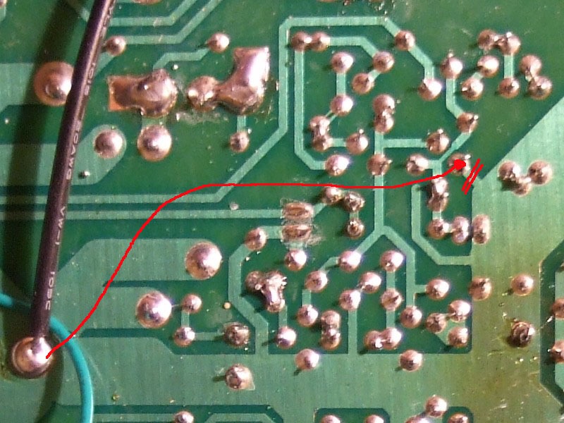

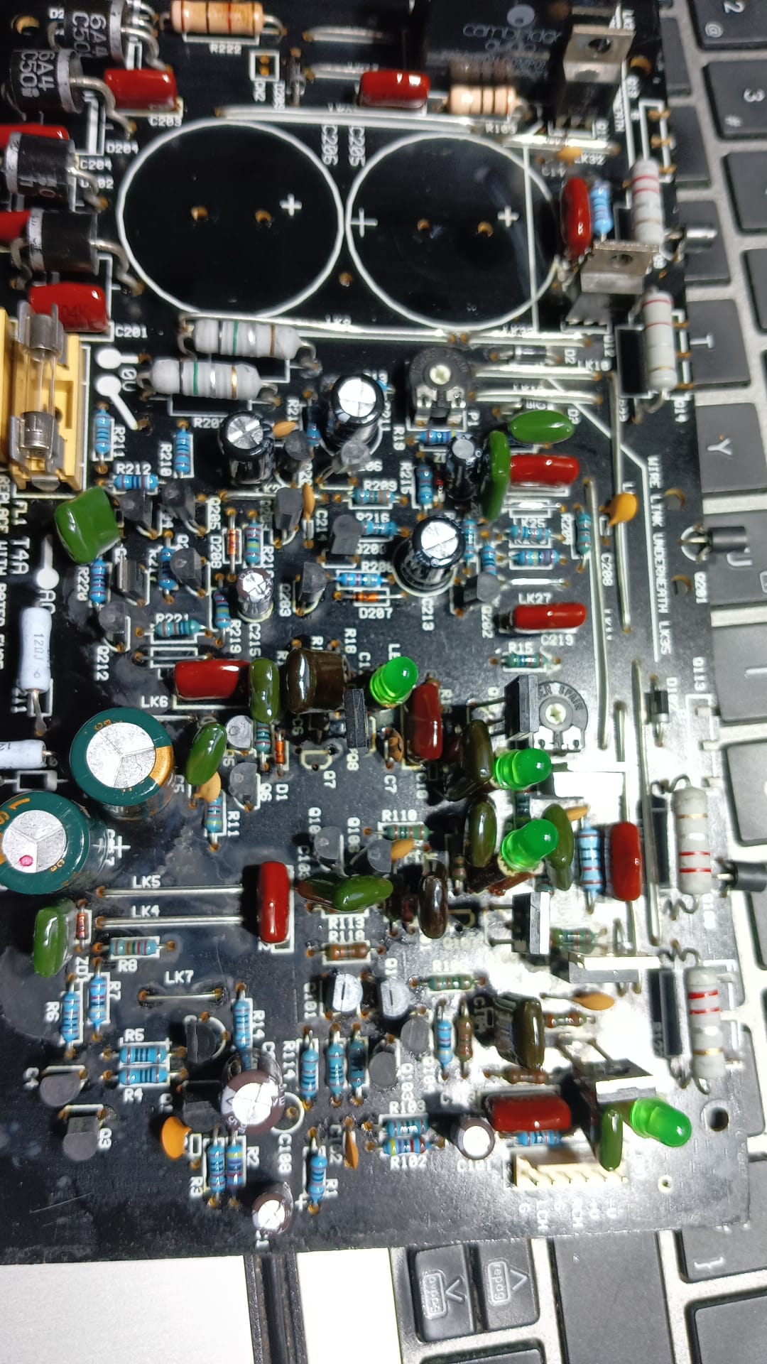

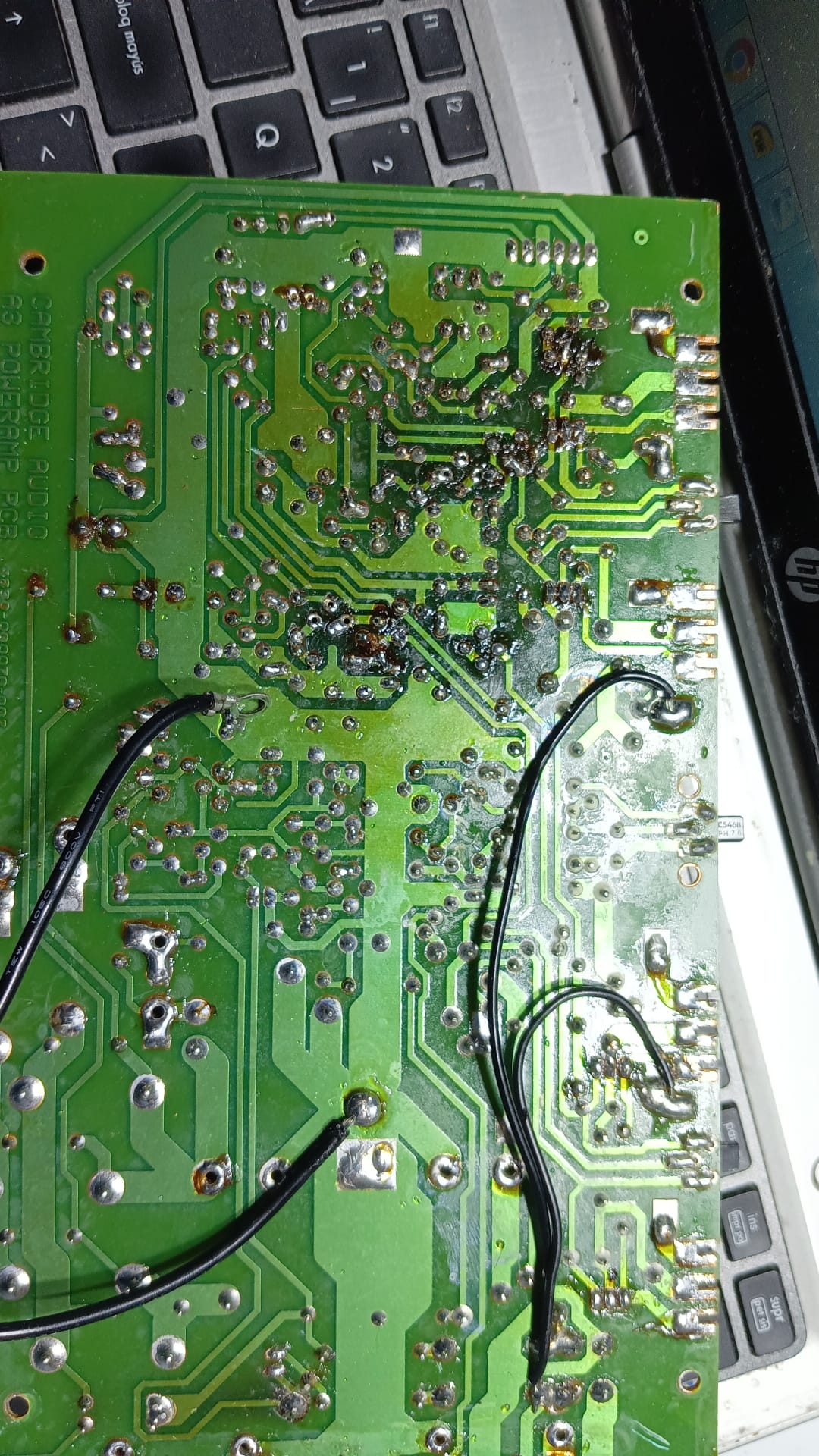

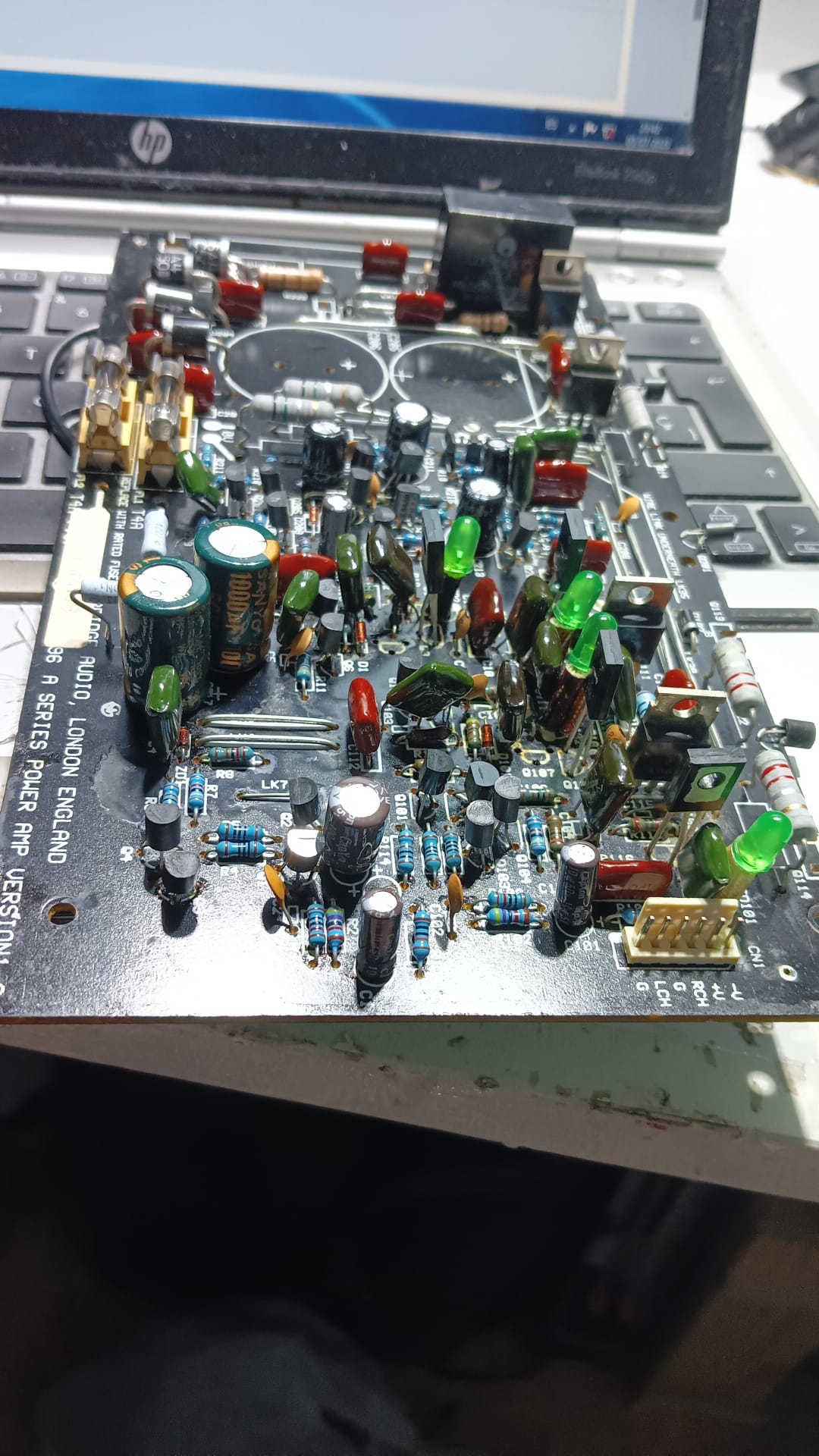

First three are the same device and either should work just fine in the A3i. Just be careful with the pinout.Which of these do you think is better? BS250
TP0610 VP0610L VP0106N3-G
Cheers
Alex
It is a much larger device, not suitable for this circuit.I have IRFD9110, so as not to wait until the BS250s come. How about?
Cheers
Alex
Check the "alternative" list that X-pro posted for the improved version of the A3i (check thread from start don't remember post number) but I would recommend to keep it as close to original as possible.
"ZVP3306A is available from Farnell. Possible alternatives are ZVP3310A, ZVP2110, ZVP4105, BSP254."
Check page 5 on this thread post 93 but again recommend read it from the start.
I'm driving to Portugal in August (I'm Portuguese) and could drop off a few of then for you (depending on location) or I can post 4 (have to buy them here in the UK) for around 5 euro + postage, just let me knowOkay, but in my spare parts store each one costs about 9.50 euros and it takes 15 days to bring it. Seriously, I'm not going to pay almost 20 euros for 2 overpriced transistors..
