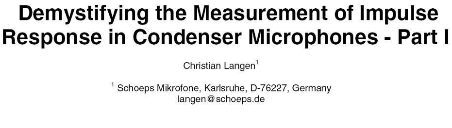

The Manger web site has a description of it.
If you have AES access the paper in the pic derives the spark response and talks about using the Manger driver.

Maybe the M-Transducer is a Manger driver?
Anyhow the duration of the spark is probably related to the energy available to discharge, the tuning of the discharge system, and the length of the gap.
If you were discharging a capacitively charged system, the duration would have a relationship to the capacitance, the current drawn in the spark and the breakdown voltage in the gap, as well as the charge voltage in the cap... then there is the voltage and current required to maintain the spark/plasma. So there are the start end and end parameters. How to manage them theoretically is probably well known to sparkplug designers? ;)

Is the M-Transducer in the AES paper the same? The performance is quite different. I have measured and heard Manger drivers before. I didn't see any real magic and some bizarre off axis response. And the measurements on the site don't match the measurements in his paper from 20 years ago.
