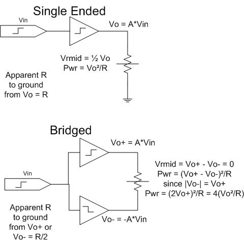

One side is swinging to the positive rail while the other is swinging negative. The load sees the differential voltage - twice the swing of either side. The current sources are not a voltage reference, the voltage at the "bottom" of the source swings with the signal.
There is a reason people say a bridged amplifier "sees" half the load. This refers to each section. Using Pinkmouse's example - one side at 1V, the other side at -1V, for 2V across the load. Let's say we have a 4 ohm load, the current will be .5 A. This current will be sourced by one side and sunk by the other.
What load would cause each side of the amp to deliver .5A at 1 volt? 2 ohms would - hence the reference to "seeing" half the actual load.

Maybe an image will help push conversations back to a productive level.
Danny

Would it help to think of the output as a see-saw, with the fulcrum being the virtual ground? As one side goes up, the other goes down. When one is maximum +, the other is maximum -. The absolute value of the difference in the "altitudes" of the ends of the see-saw is the voltage across the load. The current will behave accordingly.

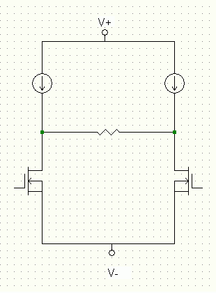

To answer the question that appears in post 1 of this thread....
Please refer to the schematic I've attached below ... forgetting all the supporting circuit, this is the output stage of the AlephX. Each of the current sources contain 1 fet and as you can see, there are another 2 fets, 1 on each side of the circuit. The resistor in the middle of the circuit is the speaker.
Now assuming 8 amps total bias and 4 fets as per your example.......
At idle, 4 amps flows thru each of the 2 current source fets and down thru the output fets. So, I hope this help you to see that for 8 amps total bias, at idle each fet carries 4 amps and 1/2 of the rail to rail voltage (at idle both of the output terminals are ideally at 0 volts).
If we then consider the current gain = 0.5, during peaks each of the current sources can double their current and so they can each source or sink upto 8 amps. Now because each 1/2 of the circuit IS IN SERIES with the the other 1/2 of the circuit, the maximum current that can be delivered to the load equals the maximum current thru one side of the circuit or in this case 8 amps.

I think the confusion is the statement in the spreadsheet.
One might asume that 8 amps total bias fot one channel with 4 FET's means 2 amp per FET.
Both the positive and the negative rail have to supply the 8 amps
Thus 2*railvoltage*bias=dissipation.
Perhaps it's clearer if the spreadsheet mentioned in cell D13 Total bias current per rail instead of per monoblock.
