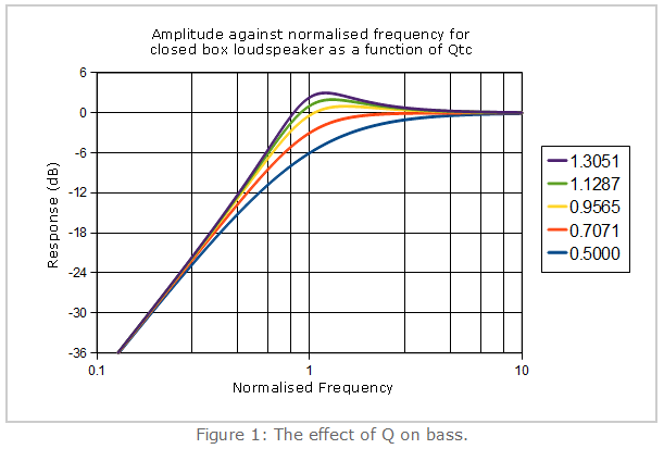

People should also understand that T&S theory showed that a sealed box woofer is essentially a 2nd order high pass filter. This ignores the voice coil inductance which if high can result in some slope in the pass band, but this is easily accounted for on top of the basic 2nd order high pass view.
Consider what we call a prototype filter design, which is where we scale Fc to 1 Hz and the amplitude to 0 dB. Then we plot a family of filter responses as a function of Q. This would represent Qtc for a closed box, and Qts for free air operation. This family of curves represents any 2nd order speaker. Simply scale frequency by Fc, and shift the amplitude by making 0 dB the pass band sensitivity and pick the curve for the particular Qtc (or Qts). If you can picture the prototype family of curves then you now know every type of 2nd order or closed box system that can be built. Simple, anyone can do it.
Some Qtc values of particular interest are .5, .707, 1, and 2. I'll let people look them up to understand why.
Think, critically damped (-6dB at Fc), maximally flat (-3dB at Fc), 0dB output at Fc, and +6dB output at Fc.
One could also plot a family of transient response, say step response curves as a function of Qtc.
I'll let those learning look up the characteristics for some interesting Qtc values.
This is why Qts and Qtc are so interesting and important.

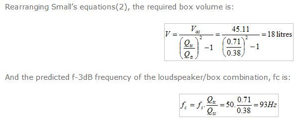

There's a bit of a masterclass on closed box here at diyaudio by BBC engineer Morgan Jones:
http://www.diyaudio.com/forums/diyaudio-com-articles/158899-arpeggio-loudspeaker.html
He discusses how Qes is affected by single ended triode amplifier output impedance and resistance of bafflestep coils. And it contributes to Qts when added to Qms.
Typical 8" SEAS CA22RNX bass driver:
H1288-08 CA22RNX

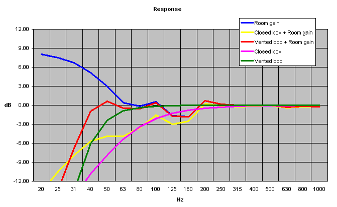

But really the closed box formula is all you need. And a driver Qts of near 0.5 works best for closed box, which means smaller magnets than your usual reflex Qts 0.38 driver.
Then decide what sort of box Qtc you want. Anything over 0.71 sounds a bit one note IMO. It's also modified by room gain. Big freestanding speakers in small rooms sound over bassy IMO. Best reduce the bass and put them near the wall IMO.
