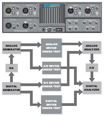

Fair 'nuff.
Below is the block diagram for the fully-loaded System Two Cascade. As you can see, the analog analyzer's post notch residual output can feed into the A/D and subsequently to the digital analyzer for FFT analysis. Since the System Two Cascade's analog notch filter is part of the analog analyzer, it's possible to do the measurements just as John is doing his, feeding the residual output of his 1700B into his FFT analyzer.
Even the System One had this capability (depending on which model and options) so I'm at a loss as to why Charles keeps claiming that not even the System Two can do it and demanding proof of it.
In any case, I'll confirm Bruno's setup and post his response here when I get it. He might be off for the holidays so it might not be until after New Years.
