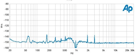

Pjotr said:
Shhhh… finally, over 200 posts later. Nice work Steve, but I am missing a “null” measurement that shows the residual distortion of the AP itself :cool: Anyway it speaks for itself.
Here's a residual from the AP brochure. I believe it was done at 2 volts, but don't recall what the source and load impedances were.
In any case, as you say, the plots ultimately speak for themselves.

Such a null measurement should be done with the same source and load resistance as the actual cables measured but without the DUT (device under test). But is doesn’t matter much, I am quite sure the result will be the same as with a cable. I just mentioned it for completeness. Thanks Steve for all the work and also a lot of thanks to Bruno for all his work. Until now I didn’t see such an extensive cable test.
