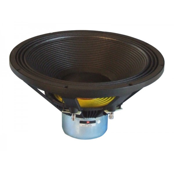

Cabinet for BMS 18N862

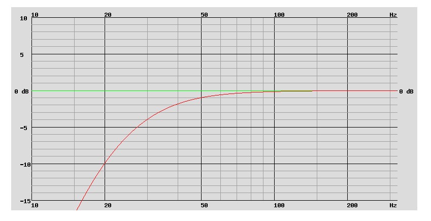

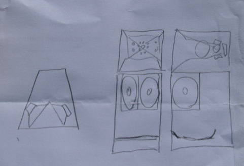

A quickie [no damping] offset driver ~212.5 L, ~25 Hz TQWT looks good with max power handling = 125 dB/m/~30 - 150 Hz/2pi.
Double it for ~125 dB/m/~22 Hz.
Shift the driver up to the top and you get a little more gain from tuning up to its ~100 Hz upper limit.
You're welcome!
OK, curious how low since with relatively minor stuffing the ~212.5 L is only ~17 ms/12 Hz.
FWIW, back on the long gone bass list this was a hotly debated subject for awhile, so simmed a few of my low tuned 'classic' reflex, [ML]TL, EBS alignments and the latter was worst case by far at up to ~35 ms/20 Hz with ~20 Hz Fs woofers corner loaded, they all were considered to be 'heart attack fast', so while I don't recall if there was a consensus, I concluded my types of vented alignments were plenty good enough even if starting to rise around ~342 Hz where our hearing acuity starts rolling off.
