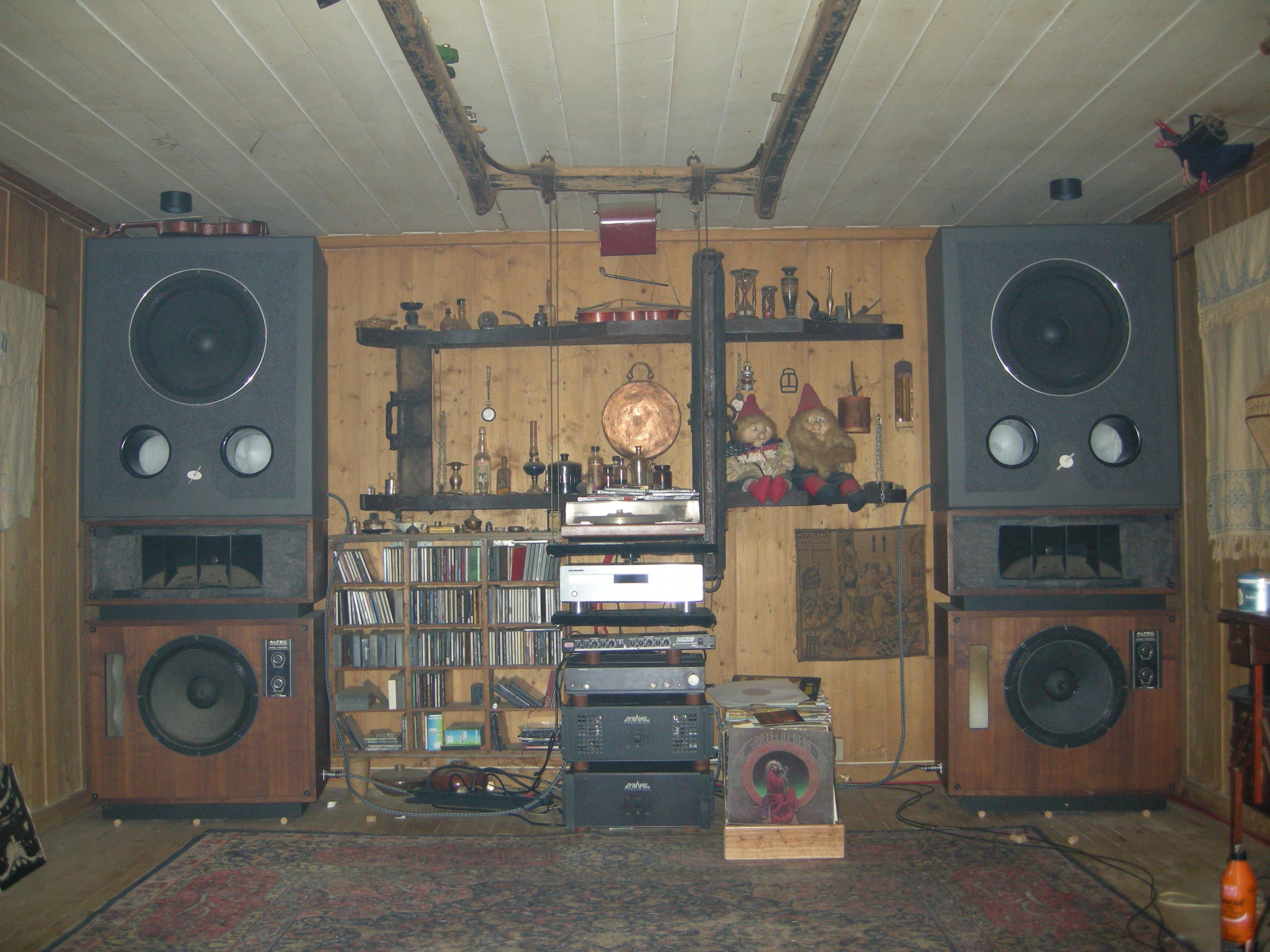

Also saw this, which i like ABSOLUTE AUDIO & VISUAL - Jadis OLYMPIA. Claims to go to 110Hz with the WG and the onken below that.
Horns will have good midbass, but will be more likely bass shy in lower octaves. First design is very tempting, combining horn and Onken qualities, but unsure of its performance. I don't think the large mltl will be bass shy, being limited mostly by the cone area more than anything.

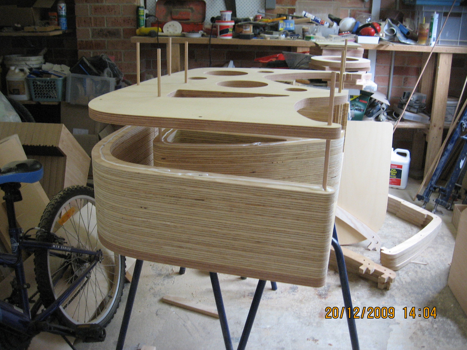

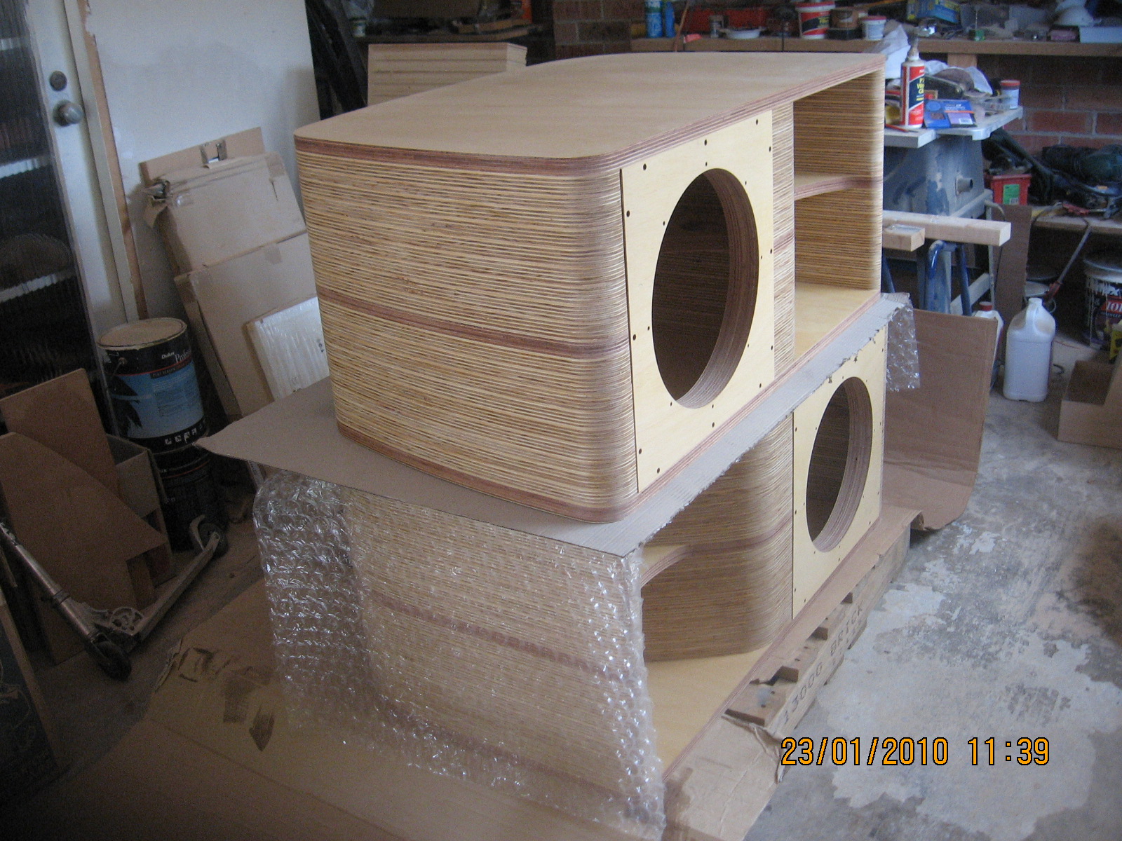

I built large bass horns for GOTO, using the 416 as a model. You could place the cabinets on the side or upright. CNC approach made for an easier build. See Stereophile link here -
Capital AudioFest 2011 | Stereophile.com

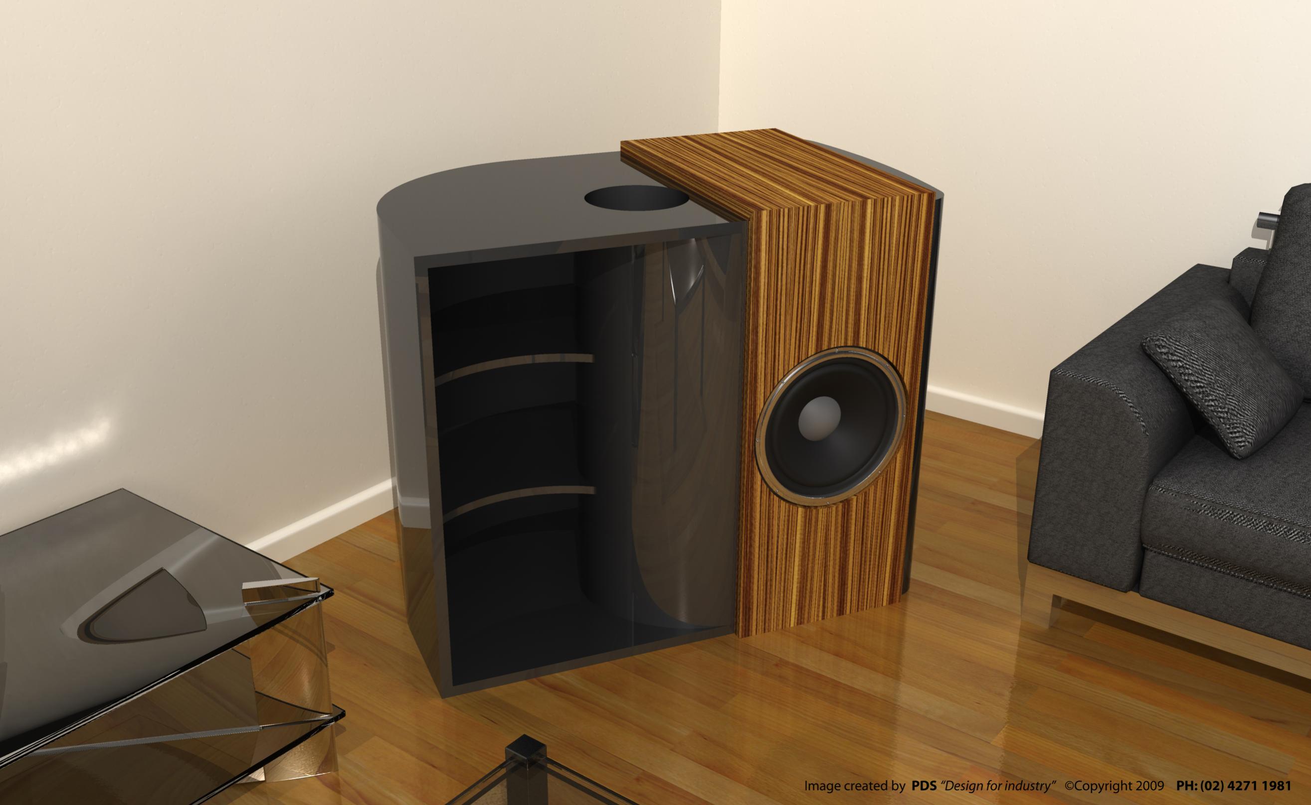

Ming Su (US GOTO rep) demo'd these at Rocky Mtn. The design mirrors the Jensen Imperial, which I've re-created in a modern version drawing in 3D, see attached.

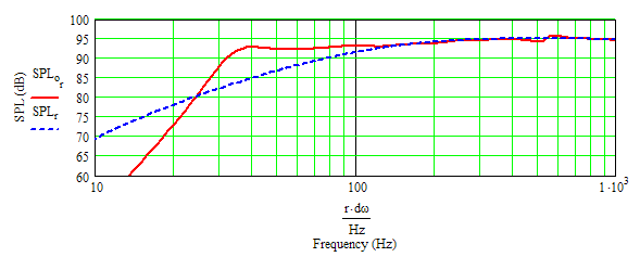

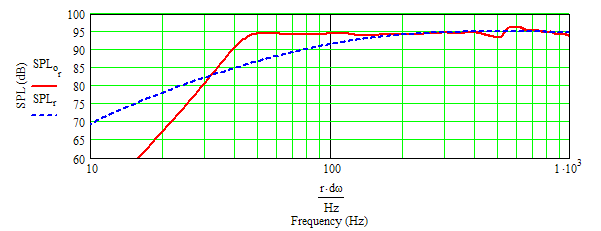

Well, the MLTL is a simple to design/build/tweak, higher sound quality [SQ] vented alignment, so hard to go wrong with it IF it meets the needs of the app.
No, its net Vb has nothing to do with its Sd, nor is it proportional to it. MJK just chose to use it to define CSA for his own reasons and to make CSA larger, just increase the multipler and of course you can increase the length. Personally, I change the worksheets to input a net Vb, then CSA is found by dividing by its length [L].
Hmm, my mid ‘50s era 515Bs are currently in a ~45 degF room and I had no problem softening one of them up enough to brush/remove some excess after only a minute or two using an old, inexpensive 1600W 125 V/60 Hz ‘Salon’ hair dryer, so maybe yours have reached the point that they need to be chemically restored.
Anyway, ~32” isn’t long enough to have much TL action, so the cab will need to be folded in half in an inverted ‘U’ with a vertical divider to get a ~61” path-length assuming ¾” [19 mm] void free plywood with the driver at the top front and the vent at the back bottom side or rear.
Using some averaged measured specs, there’s sufficient length, net Vb to tune all the way down to around 32 Hz or up to an Onken-like ~45 Hz max flat alignment depending on the vent area, so should be reasonably tolerant of driver specs even if driven with a high output impedance.
Sims are minimally damped, so plenty of flexibility if there’s any in room ‘boom’ due to the 4th order roll off.
~32 Hz Fb with a 5” diameter x ¾” long vent
~45 Hz Fb with a 10” diameter x ¾” long vent
GM
