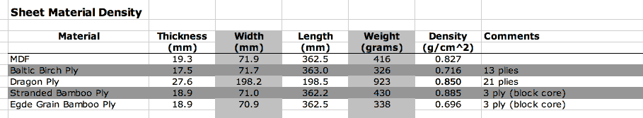

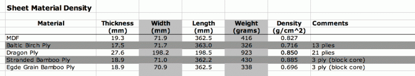

Attached is a table from some samples Chris dropped off.
It should be noted that from the point of view of getting panel resonances up, if you have 2 materials with the same stiffness, the lighter one is better.
Density will have some effect on damping & impedance (don't know which direction this goes), but the detail of the structure is likely more important.

It seems your calculations are a bit off kilter. Your results are in units of CC/G. Take the inverse of your values and that will be G/CC and thus the result for BB becomes 0.716.. , close to what I measured. If you don't believe me, take a piece of BB and drop it in a bucket of water. If it floats, its density is < 1.0.
You are right... don't even need to open the SS to verify, i can see the mistake in the formula in my head.... trying to squeeze that job in before going up to cook dinner.
I've just replaced the incorrect picture above.
Attached is the fixed spreadsheet if people want to add stuff to it.

We've built boxes with all but the dragon ply, IOE materials from best to worst are stranded bamboo, other bamboo, BB, and MDF trailing a long ways behind.

...still have to get my MDF measurement done. I'm curious to see how close it comes to your 0.827.
