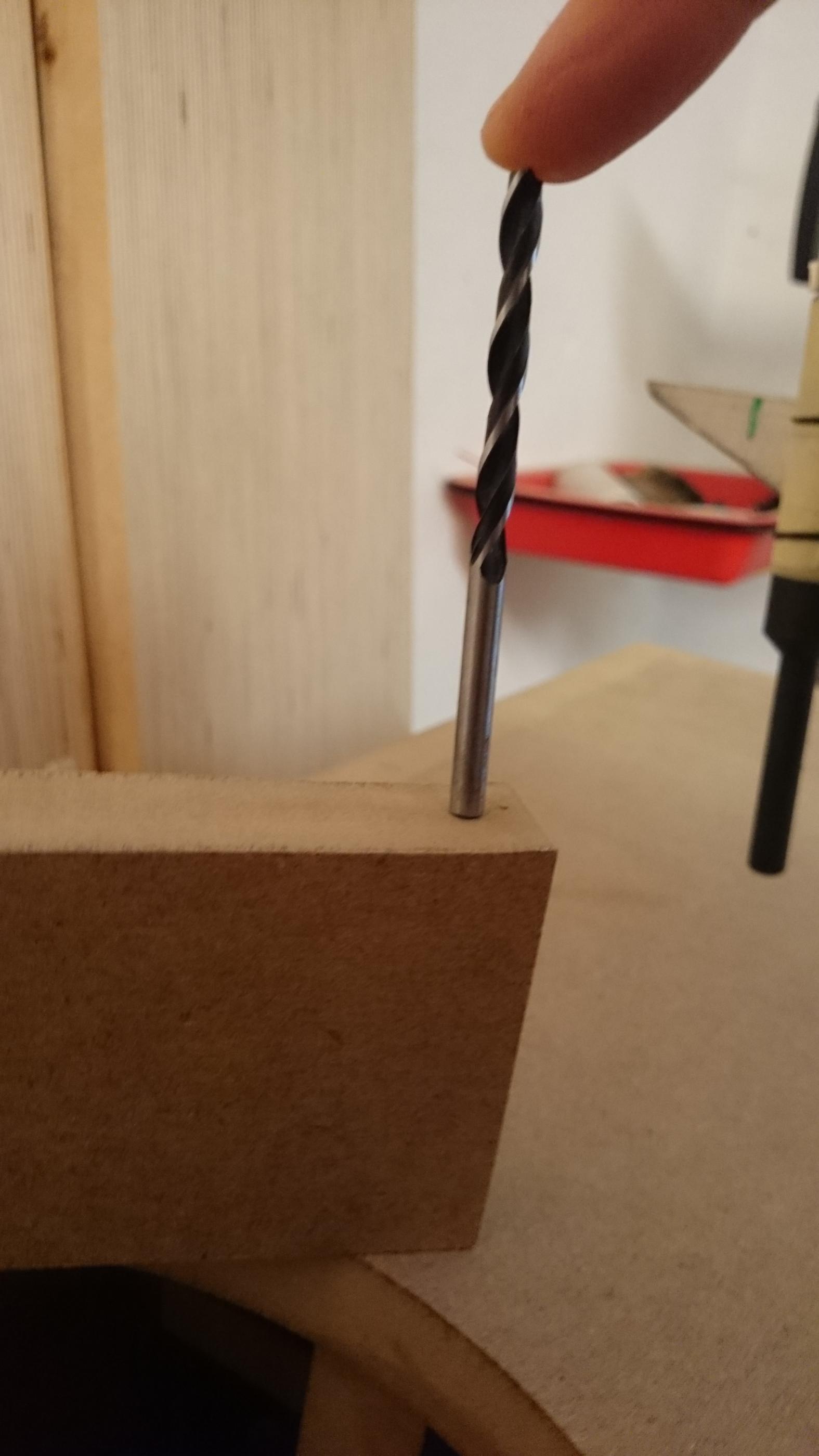

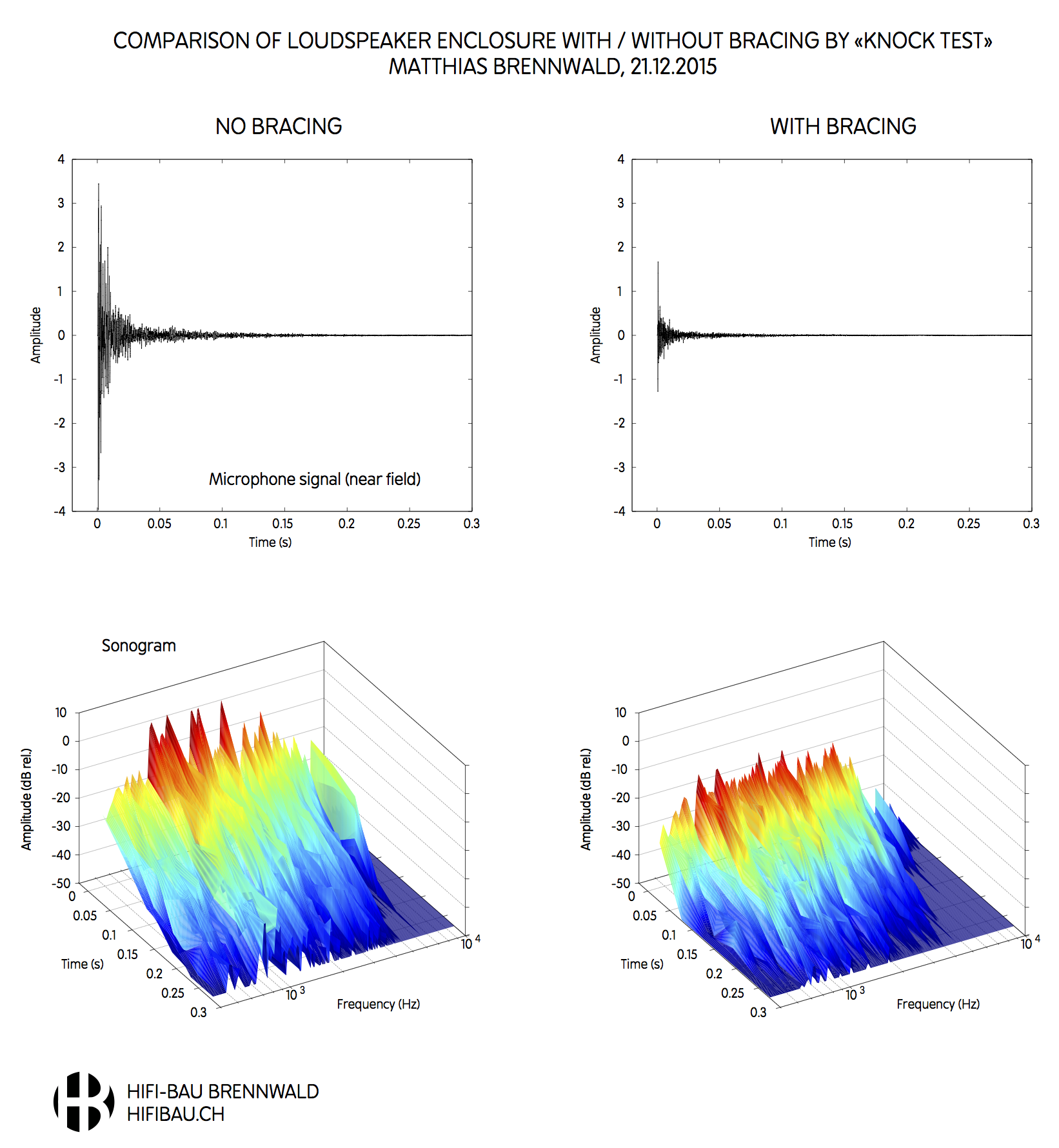

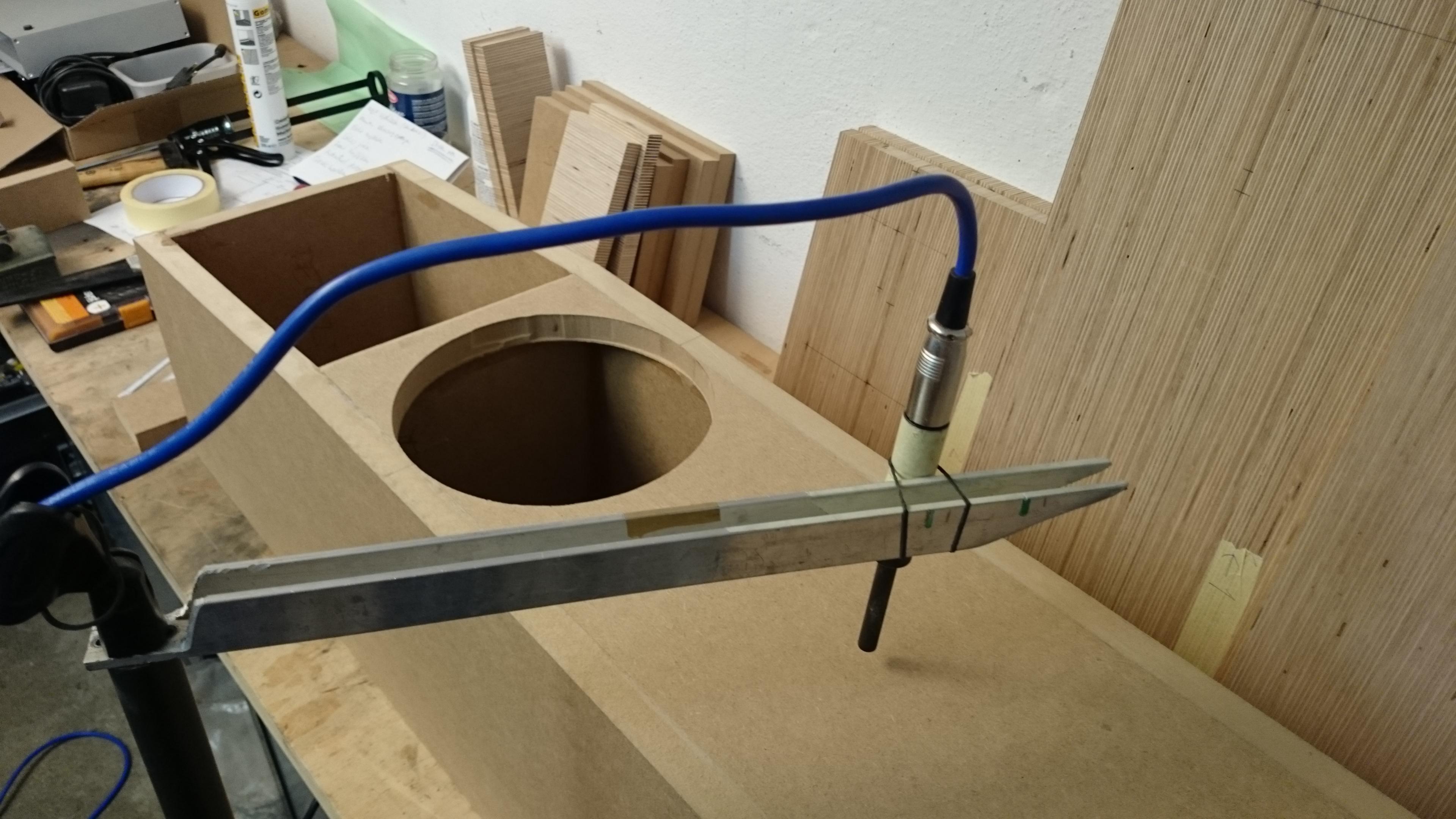

I made up a simple knock test set up that provided surprisingly consistent results using the partially built enclosures of my current loudspeaker project (see also attached photos):
  • Enclosures are rectangular 22mm MDF boxes (238 mm wide, 251 mm deep, 591 mm high). Bracing was installed in first enclosure, bracing was not yet installed in the second enclosure (I will post a drawing of the enclosure and the bracing once it's complete).
  • Enclosures were positioned with rear wall on bench, front baffle pointing upwards.
  • The microphone was placed 8 mm above front baffle (nearfield measurement), 225mm from bottom of enclosure.
  • I used a 5mm drill bit as 'hammer'. Held the bit in vertical position, 7 cm above front baffle of speaker enclosure. Then let drill bit fall on front baffle immediately below woofer hole (I used the wedge shown in the photo to get the 7 cm right in every experiment; I removed the wedge from the baffle before letting the bit fall down).
  • The microphone signal was recorded and processed with MATAA at 44.1 kHz sampling rate. The microphone was a Beyerdynamic MM1 with custom CS Labs calibration data.
I repeated this test about 10 times with each enclosure. Enclosures were placed at same positions (within 1mm precision). The microphone was not moved our touched when enclosures were exchanged. The replicate measurements were surprisingly consistent.
The results are shown in the attachment. The sonogram of the enclosure without braces clearly shows some resonances. With the bracing installed, the resonances are approximately 20 dB lower, and are hardly visible apparent in the spectrum. Overall, this seems to agree with the information I get from my ears: with the bracing, the sound is a short 'clunk'; without the bracing the sound is much louder, has a clear 'tone' to it, and it also seems to take longer to die away.
That was a fun experiment and I now know a bit better how to interpret the infamous knock test. But please don't use my results to abuse the knock test as the gold standard for enclosure resonance analysis (read posts 23 and 27!)
Now it's time to continue building those speakers!
