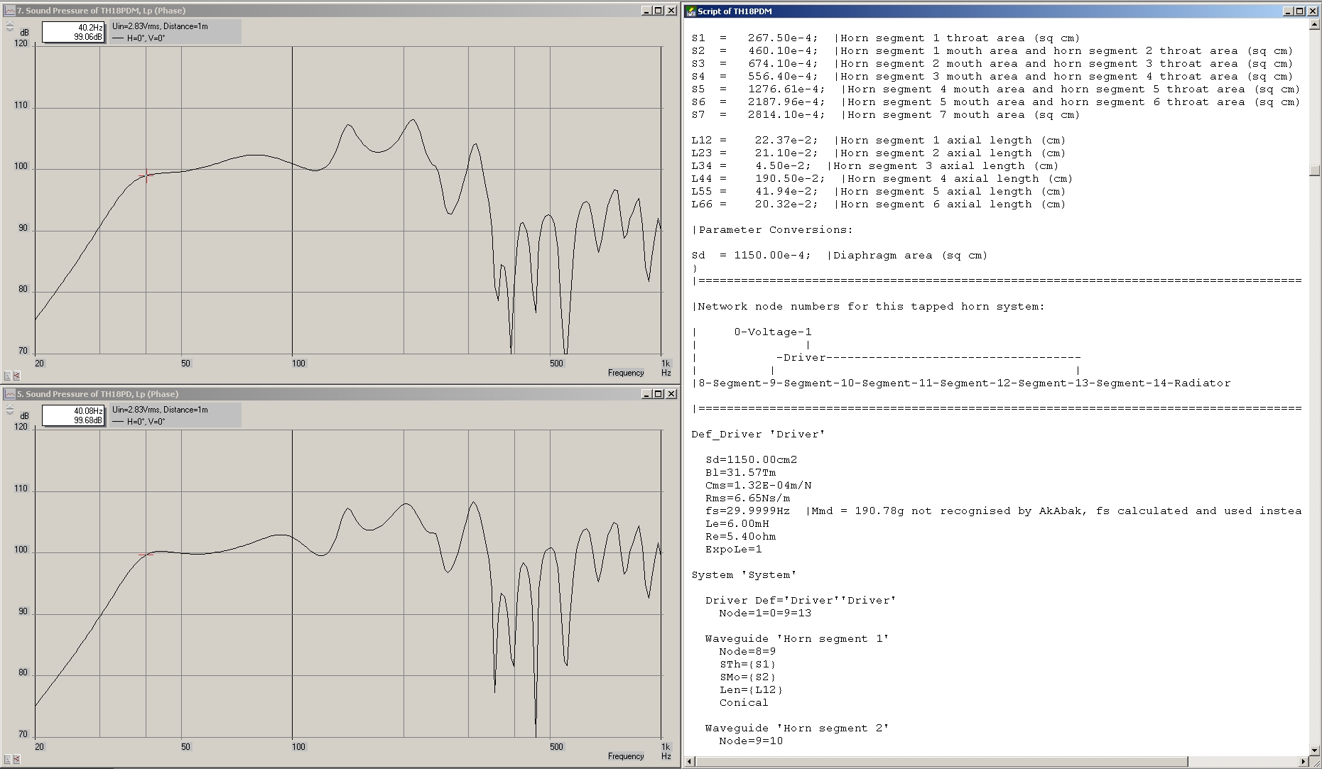

Akabak Analysis TH18
Hi
Results of 6 segment sim in akakak adding the extra area unaccounted for in the hornresp sim. As discussed in posts 292 & 293
The screengrab shows the data used and the resultant sim labelled TH18PDM
The TH18PD graph shows the 4 segment sim as exported from Hornresp - with the path length adjusted to take account of adding all the corner reflectors.
Driver is still the PD1850 but results are presented for comparison of the response curves.
The rest of the horn is as linear as I could acheive, with no great descrepancies from the horn taper.
Overall the result is a slightly smoother response - half a dB down at 45hz
and 1 dB up at 30Hz.
I suppose this is the effect that might be expected by adding a small bandpass chamber.

I think you are right there. It's only a pity Akabak doesn't have the ability to show how the design would be influenced when the driver is loaded with max power. Nice work again Martin :up::up:

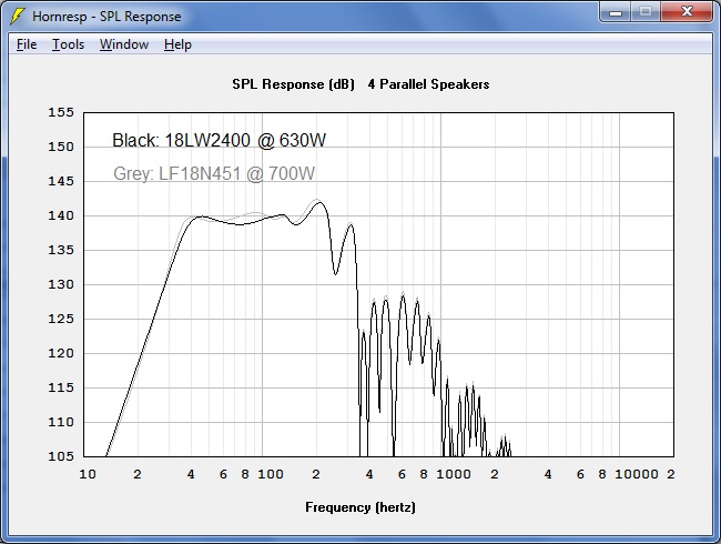

I wonder how the 18LW2400 driver would compare to the RCF LF18N451 in the real world.
Note: Both drivers are at (xmax + 1.6mm) and are being modeled in Xoc1's TH18

So the 18lw2400 is theoretically hitting xmax with only 630 watt input, yet it was mentioned before that they need at LEAST 1500 watts to get anywhere near xmax?
Either way i just grabbed the xti4000 last night so I have some power to play around with. Now I need to get the drivers and some wood! yayy!
i didn't do the math(djim is better @ it:D)
but first you got powercompression.
second hr only shows sine waves excursion,so in real live use excursion wil be much less.
so you might need that 1500 watts to get to x-max in real live use:).

I wonder how the 18LW2400 driver would compare to the RCF LF18N451 in the real world. Note: Both drivers are at (xmax + 1.6mm) and are being modeled in Xoc1's TH18
For both drivers there is something to say so it really depends on what is more important to you.
i didn't do the math(djim is better @ it but first you got powercompression. second hr only shows sine waves excursion,so in real live use excursion wil be much less. so you might need that 1500 watts to get to x-max in real live use.

Okay so the modeling is just showing xmax using sin waves not program power..got it!
Clean single sine waves always show higher excursion and do radiate better to air. That’s why bass sounds often have strong sine waves in them. If the Fb of an TH design is set higher than the Fs of the driver you can use AES power ratings as given in the Thiele-Small parameters of the driver.
