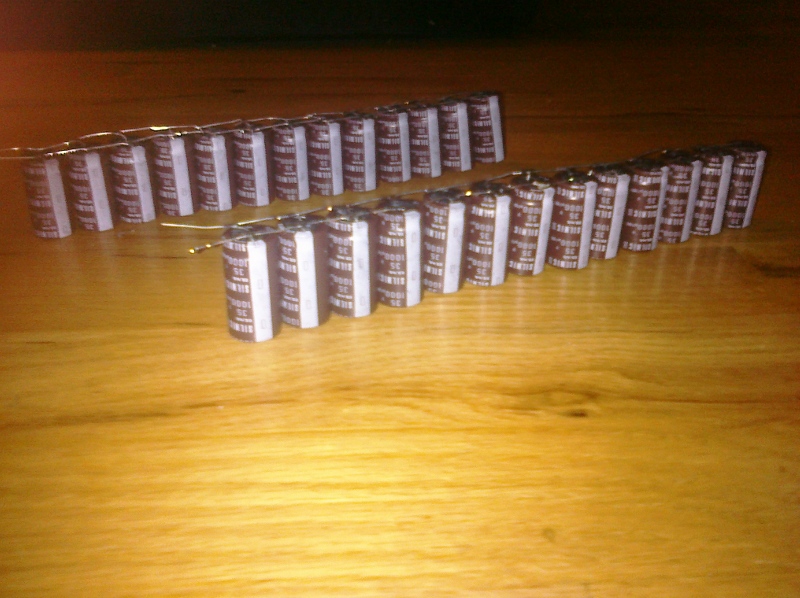

Im building an F2 amp. I read a few posts in the F3 build thread about the output cap. Some say to use a good one, and don't bother w/ the bypass cap. I'm willing to try soldering 10-15 Silmic II's together, and the cost would be about the same as getting a decent bypass cap.
Any thoughts?

Hmm... to be honest, I already ordered the 30 silmics before I posted this :)...
Maybe I'll save them for a possible future f3 build, if it doesn't make as much difference in the f2.
(ignorance isn't bliss.. it costs money!)
