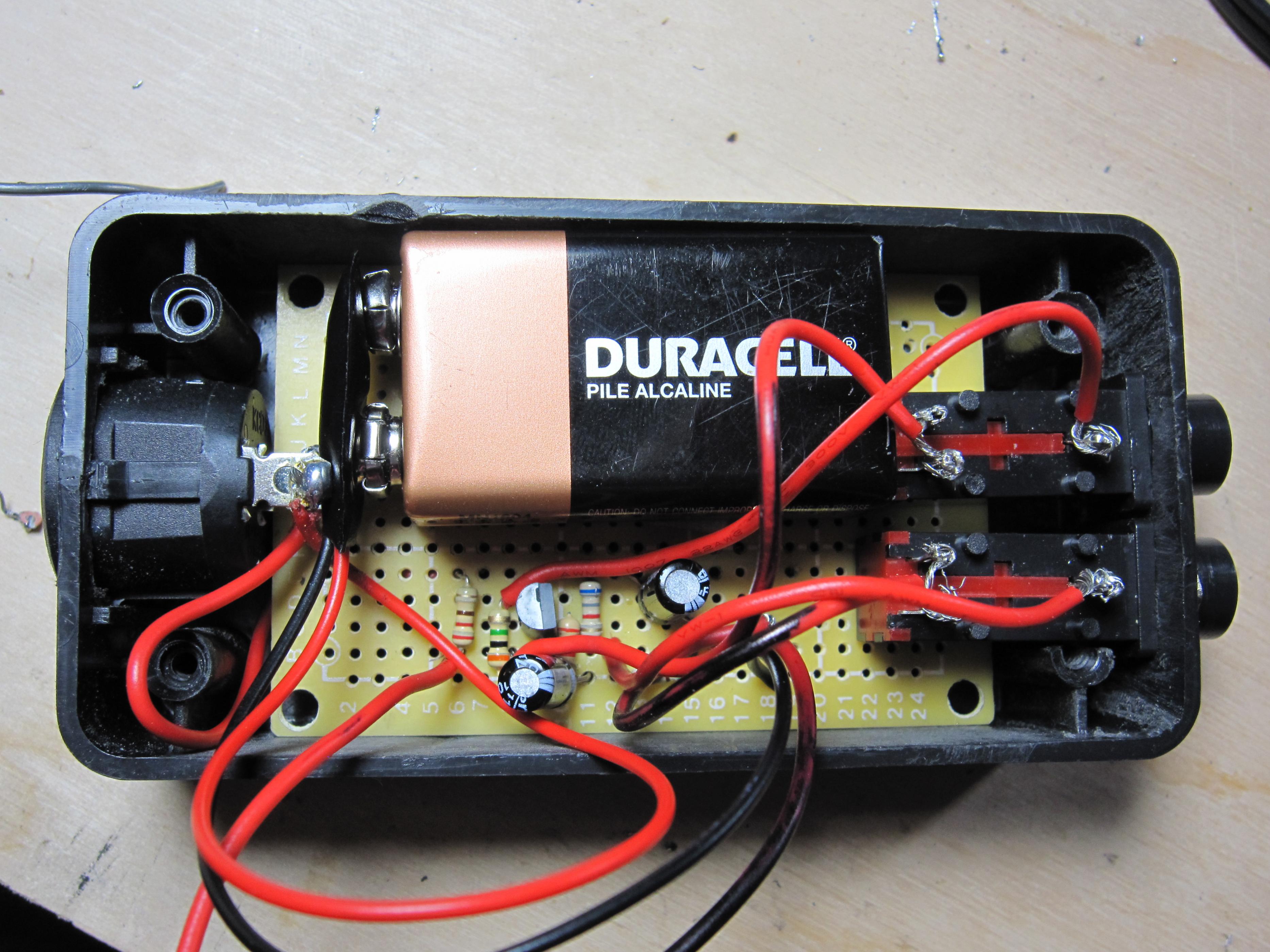

Different outlets? All I saw was a nine-volt battery. Why didn't you post photos of the AC-powered part's internals? (Or label what you posted, if it's already here.) And an actual wiring diagram might be a big help, and not the way the schematic is drawn (how it's supposed to be) but how it was actually wired, with each ground connection and path shown accurately, etc.
Maybe it's something as simple as letting all of the grounds run back to the supply in the same wire, or sharing part of some wire along the way. Then the 60 Hz stuff makes the signal input ground reference bounce at 60 Hz, which then arithmetically sums with the input signal.

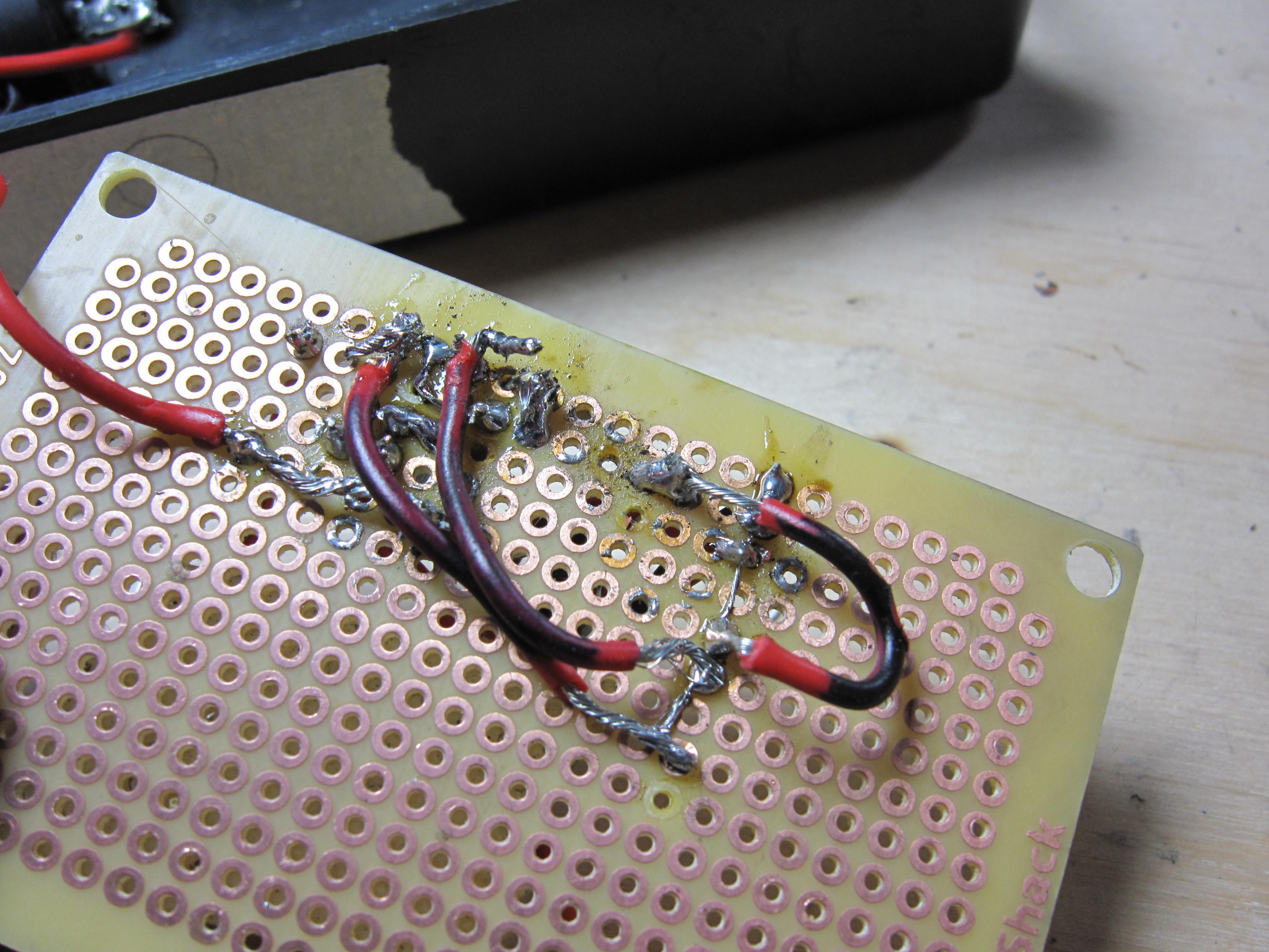

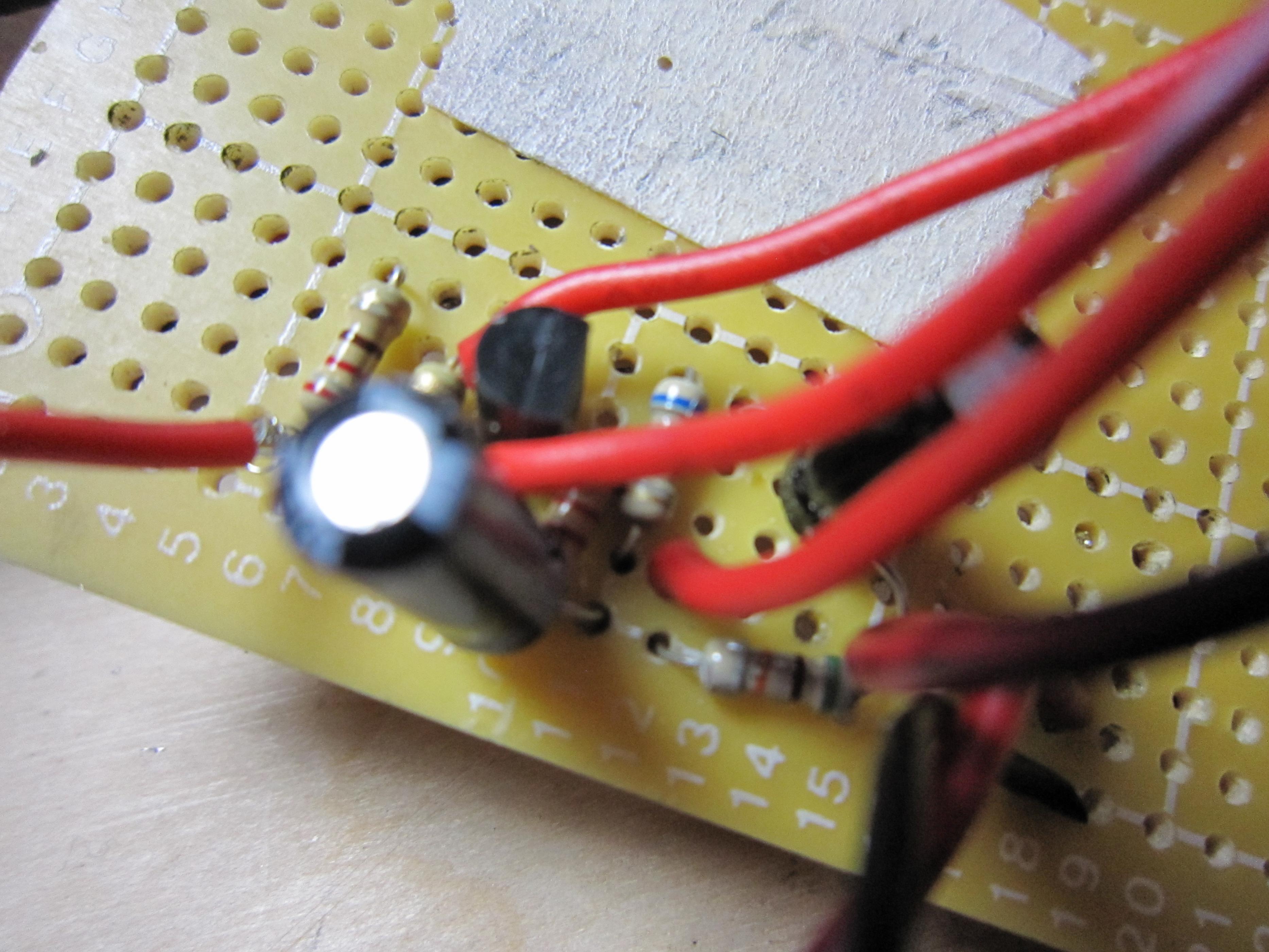

Anyways, here are some photos. Sorry about the poor image quality; I'm shooting with my iPad... Go figure.

From the looks of it, it's probably got something to do with excessive wire lengths and undressed wiring, or a poorly-shielded or grounded input cable, or a layout error, or a solder joint in need of reworking, or the lack of a grounded metal case.

Pay special attention to twisting the two input wires together, all the way from the jack to the resistor.
Also look at how your Nine-volt connections are layed out. The + and - should stay as close to each other as possible, everywhere.
But none of that might matter nearly as much if you put the whole thing inside of a sealed metal box, which would provide a lot of shielding against the 60 Hz that's propagating in the air. BUT, you would probably need to make sure that the input and output jacks were the type that are insulated from the case.
It is possible that you have the wire from the signal to the non-ground end of the input resistor coming from the wrong lug on the input jack.
Can you check with your ohmmeter, between the center connector of the jack, outside the box, to the negative terminal of the battery?
If that is a low reading, then reverse the wires on the jack lugs, inside the box.
On the other hand, if it's correct as is, then there should be a low reading between the ground/shield/outer part of the jack (outside the box) and the negative terminal of the battery.
You could plug your cable in, to do those measurements, if that would be easier, since the other end of the cable will have a tip that should be the center conductor, which should not have a low resistance reading to the negative terminal of the battery.
Even easier would be to plug in the cable and then measure the resistance from the tip to each jack lug, inside the box.
HOLY !@#$%^&* AHHHH THANK YOU SO MUCH TOM!!!!!!! The problem was indeed the jacks being reversed!! How it worked like that and how I missed it I don't know, but I have never been so happy in my life!! Tone sounds so good :D
