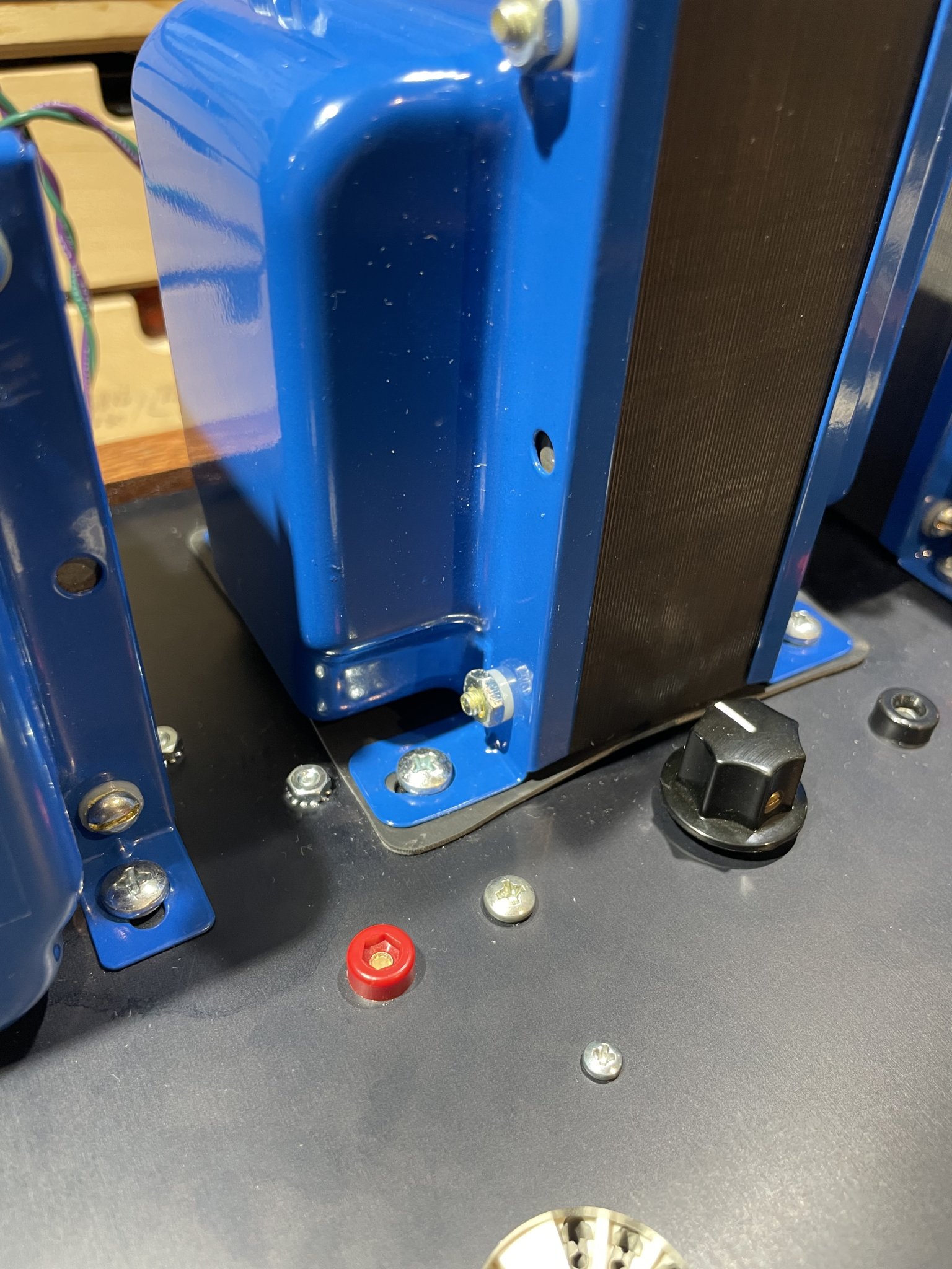

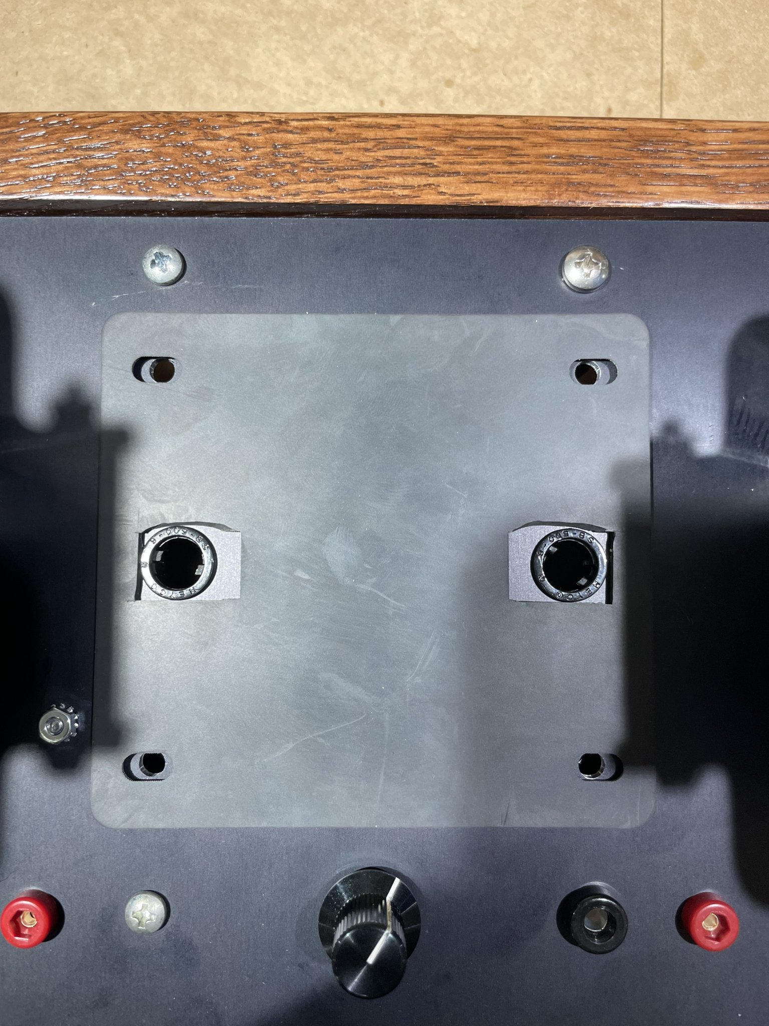

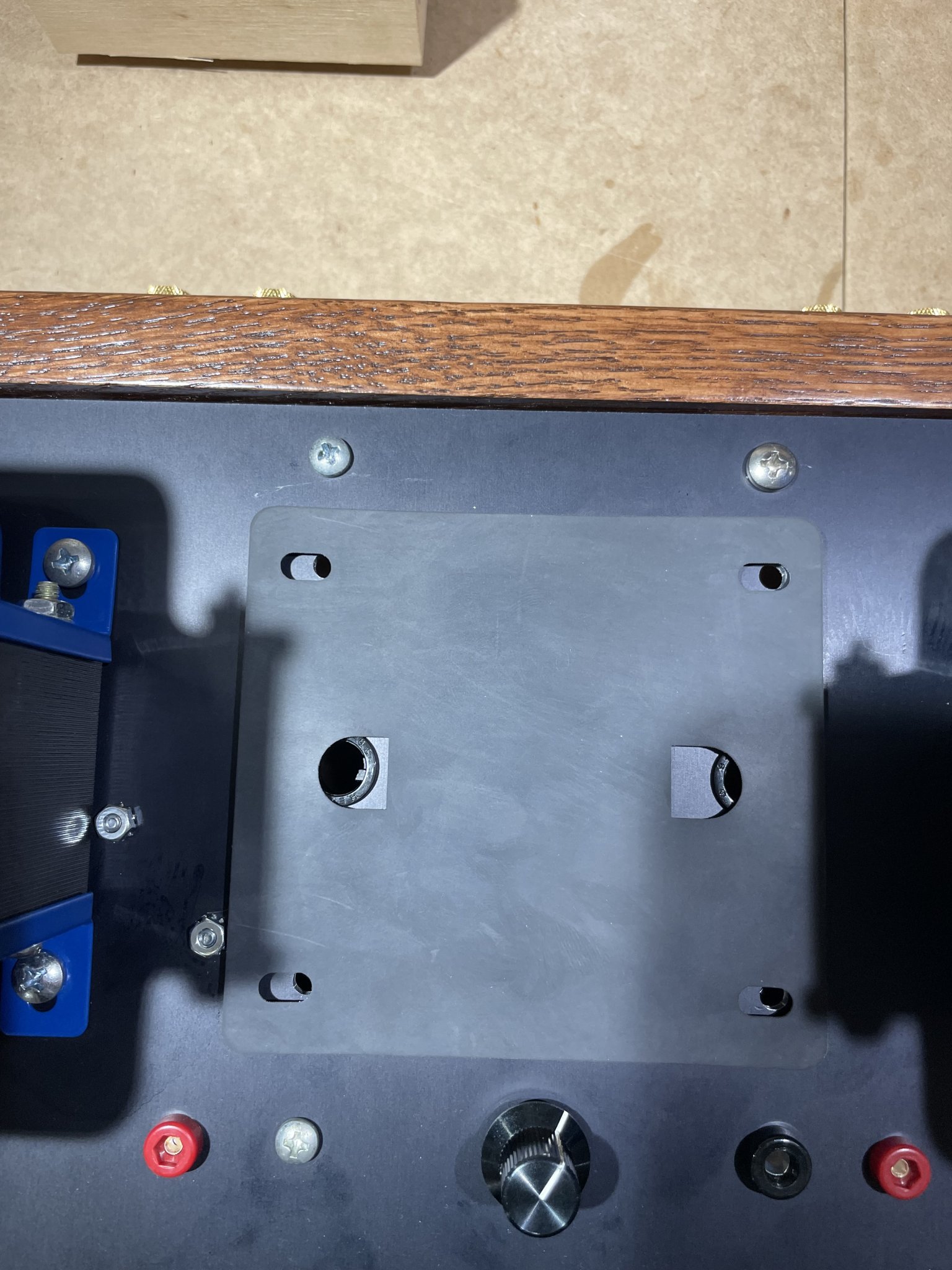

So I did have Edcor send me the insulator pad for my very loud power transformer. Before installing this insulator pad I actually measured the noise as 27.5dB from a foot away!
As you can see from the attached pictures it appears the pad was incorrectly designed as it does not fit the transformer. I had to cut up the rubber to get the wires to fit. It’s also possible that Edcor sent me the wrong insulator pad for my specific transformer.
It was a real pain to install!!! The entire time I was installing I was cursing myself, thinking this insulator would not do anything.
Sure enough though, even though the pad looks terrible (see finished installed pic) it does indeed actually works. The buzz is dampened. I can now sit in my listening position 8’ away from the transformer and not hear it at idle.
So the bandaid solution to a poorly designed/manufactured transformer does seem to work…

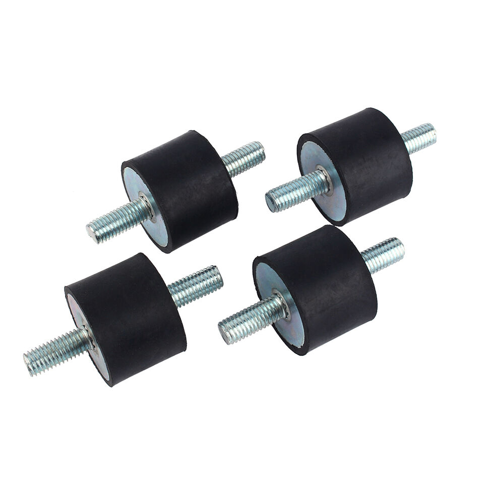

Thanks for the review! The anti vibration mounts I've used seem to do the job - not 100% but you can only hear the noise close to the transformers.

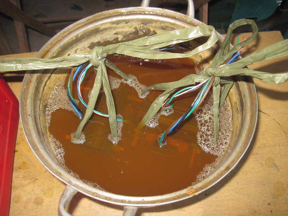

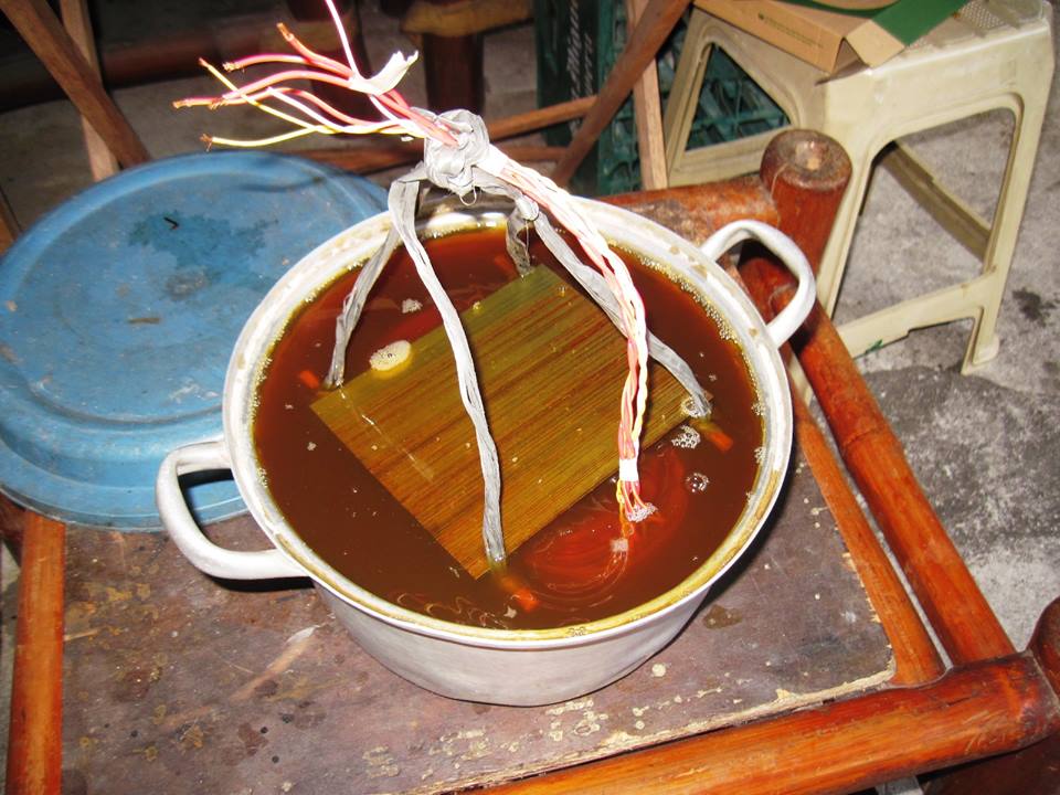

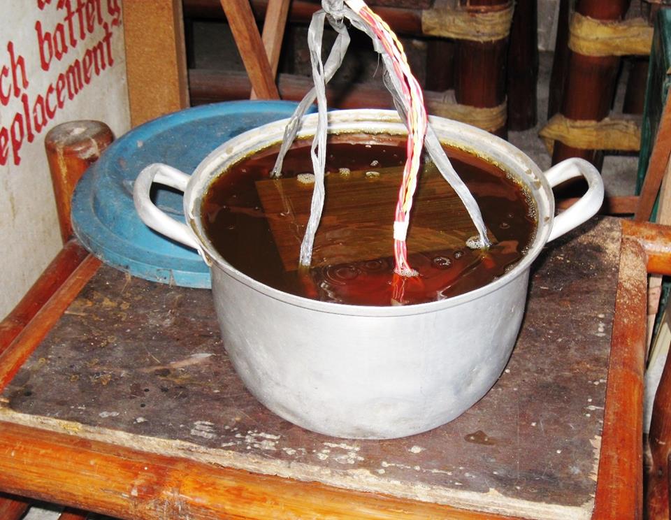

transformer vibrations are non existent in my traffo builds. Why?
because I made sure that the lamination stacks and the bobbins are a tight fit...
and add to that, I dip the whole assembly in a vat full of air drying polyurethane varnish..
the process takes about 30 minutes....
