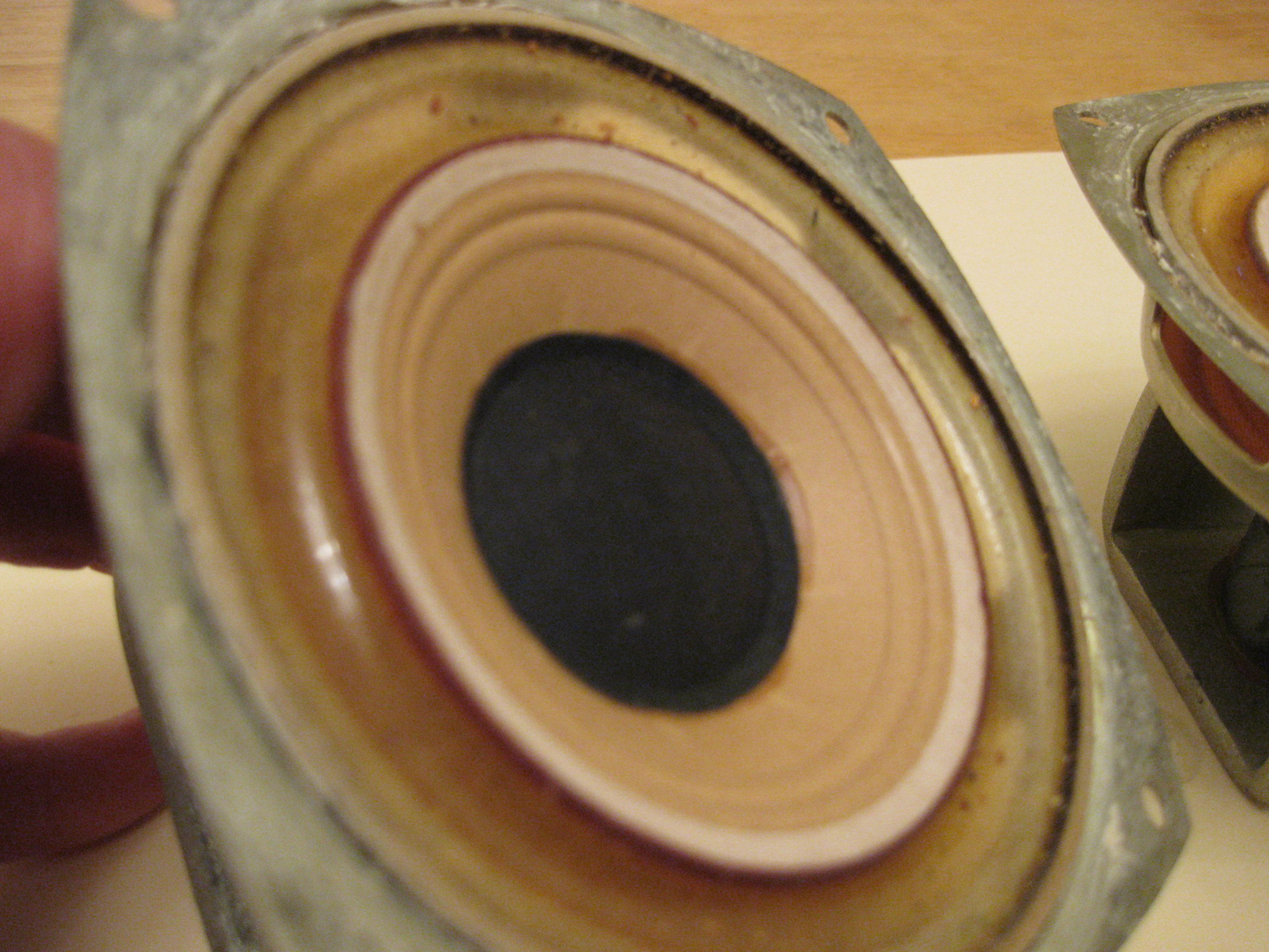

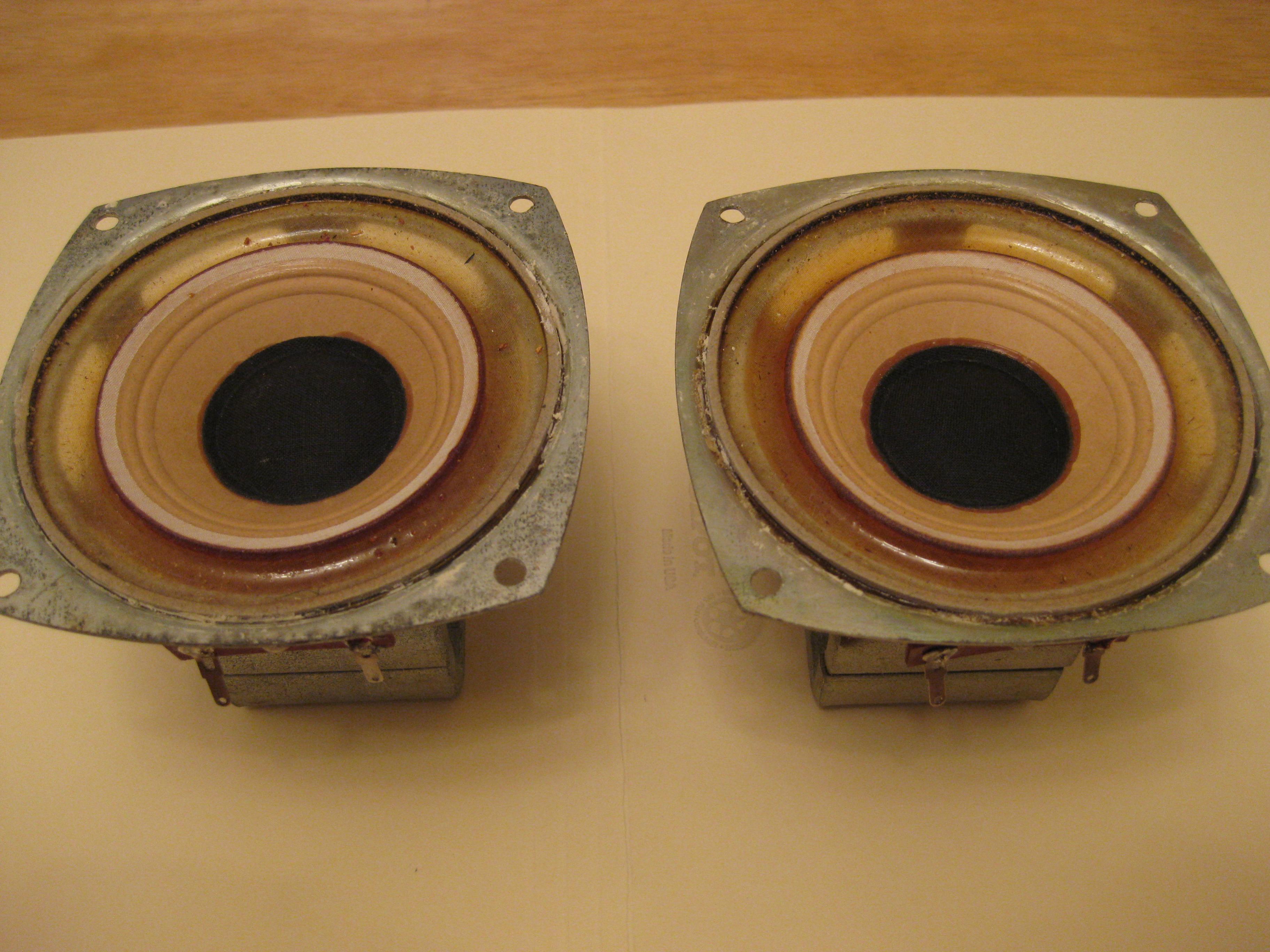

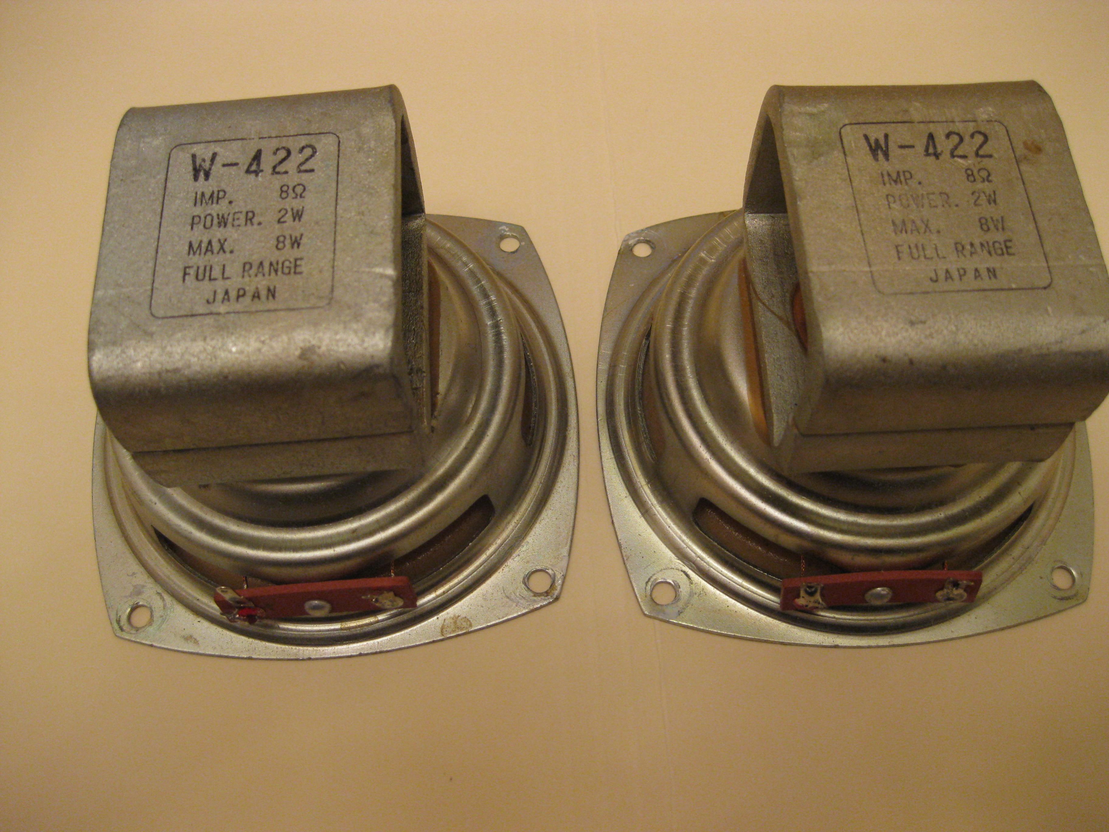

Here are some photos of the fe-103 type drivers that I have. You mentioned that they may have been made by Atomix. They are marked W-422 / 8 Ohm / 2 watt / max 8 watt / full range / Japan. There are small, radial ribs on the cone. They sound very nice. I had to completely dismantle (destroy) the original cabinets in order to remove the drivers. I've had them mounted inside a nice pair of Realistic Solo 103 cabinets for safe keeping. Please feel free to email with questions or advice. Anyway, I hope the photo posting works.
