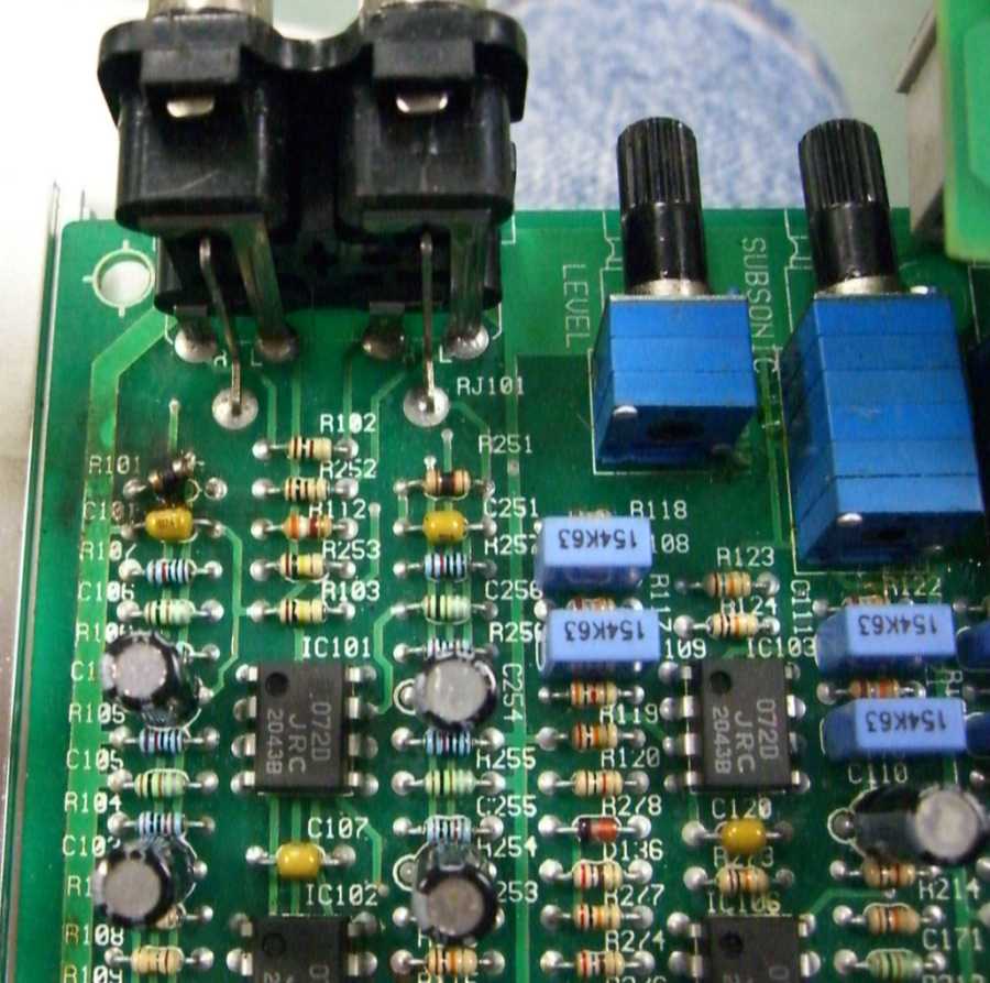

burnt resistors on PPI PCX-1250
I have a precison power pcx-1250 amp, and it just recently stopped working. While connected to the sub, all of a sudden it started to just thump the speaker randomly and make the cone stand out of the basket, so I quickly disconnected it and opened it up.
I found two resistors that are completely burnt and I am unable to determine the value of them. They are R101 and R201 and are located right behind the RCA input connectors on the board. If anyone has access to this model amp and could retrieve the resistor values for me, that would be great. I looked through the 'show me your guts' thread and actually found a picture of this amp, but it wasn't hi-res enough to tell. However, I do notice that the resistors on that board(picture) are different from the ones that burned up on mine. Mine aren't blue like in that picture. Maybe that has something to do with why they burned in the first place. Do those blue resistors dissipate heat better?

Cutlass, it looks like the 2 resistors that are burnt are the ground-coupling 10ohmers that 'isolate' the RCA(shield) ground to the audio ground. The fix is easy, just swap the resistors out with 10 ohm; 3watt parts. You won't like the cause.
Usually what happens is that the amplifier has a poor groung connection and the amp has to source its ground through the RCAs. As a result, all of the amplifies current tries to go through those resisotors but they cannot accomodate that much current. So, fix your ground and replace those two guys and you should be set. Let us know.

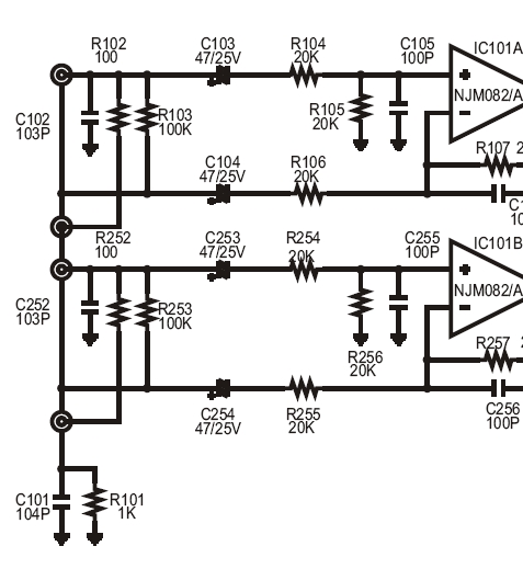

This input circuit is common to many amplifiers. For R101, they use values between 1K and 220 ohms. If you look closely, the parts in a parallel group on the board are identical. The designations have a difference of 150. If R251 has survived and you can read its value, that's what you need for R101.
Don't use a larger wattage resistor, if it burned, there's a reason. When it opened, it protected your head unit's shield ground. If you are concerned that it will further damage the board if it burns again, mount it ~1/2 inch above the board.
The attached image is part of a schematic for a different amp but it gives you the general scheme of things.

I can't remember seeing an amp that used a 100 ohm in that location so it's likely a 1k ohm resistor.
Did you try to measure the resistance with an ohm meter?
Before you reinstall it, check all of your speaker wiring. The secondary is likely isolated (secondary ground not directly connected to chassis ground). If that's the case and you have a speaker wire shorted to chassis ground, that could have caused this damage.
Meter showed something like 7k. Ya the speakers wires might have toched ground they weren't take care of properly. It is going in a different ride that I will be installing all the power and connectors. Mostly I see people with bad grounds on amplifier and it kills the power supply inside.
