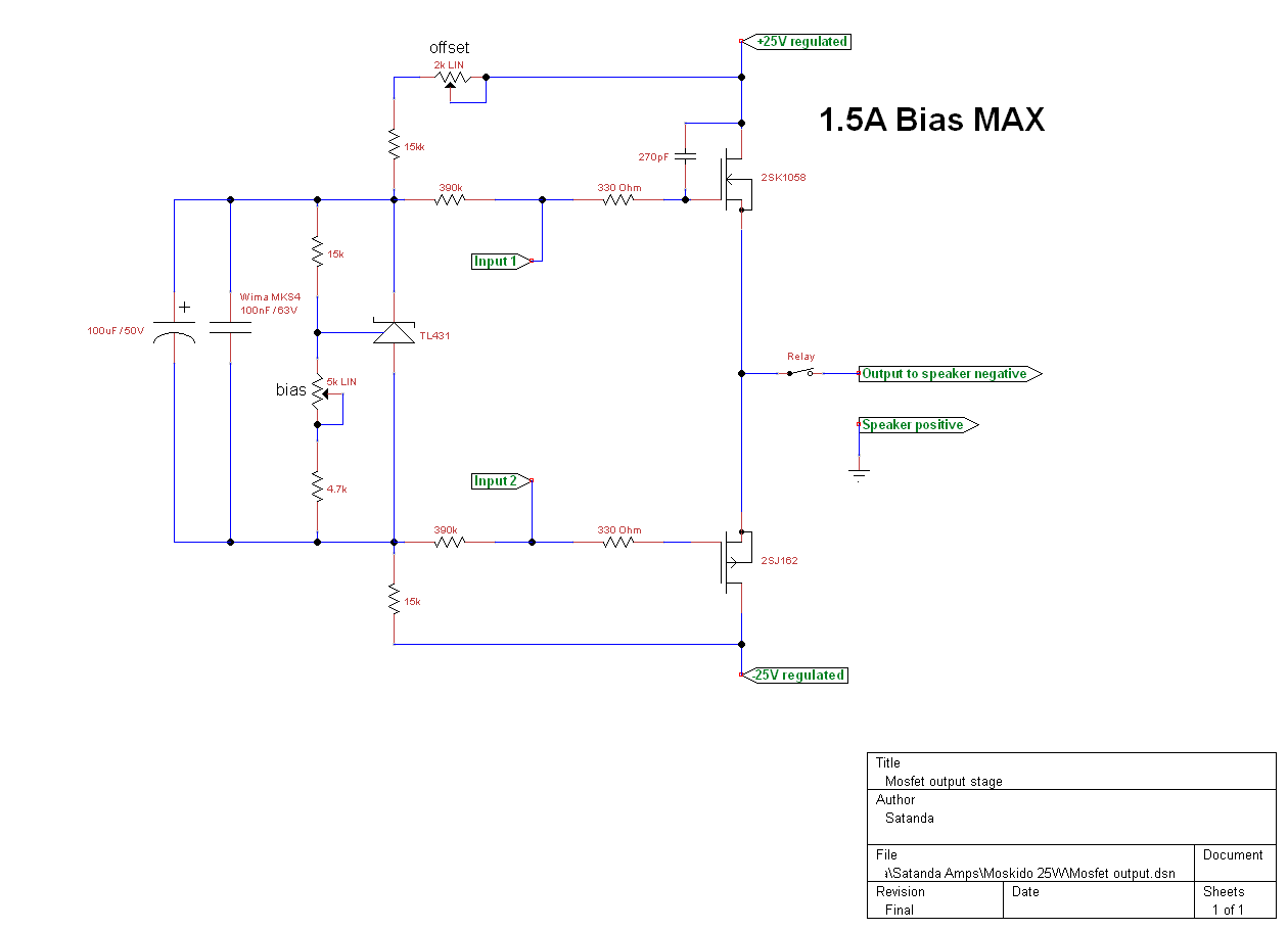

it will work ;
but somehow I prefer more that each gate see properly low impedance bias network , not via 390K
Why would you prefer low impedance bias network? With higher input impedance you can use much smaller (and cheaper) coupling caps.
....With higher input impedance you can use much smaller (and cheaper) coupling caps.
Wouldn't the cost of the extra components cover the cost of the 10uF polyester capacitors?
The 10uF polypropylene cap on the power supply. Is it ok to use several polypropylenes of smaller size as long as they add up to 10uF? I've just seen some rated at 100V which are much smaller than the ones I am using (thinking of the next project here). Would 8200pF be enough?
