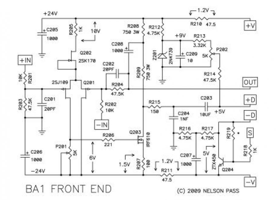

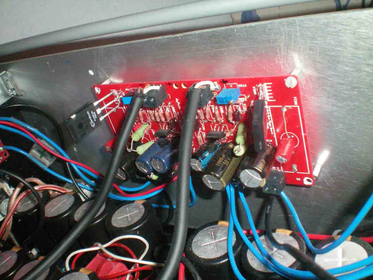

I got tea-bags semisouth and put them together with the semisouth I got from magura in a BA-1. I left the IRF240 on the negative side doing the job as a current source and ,like Nelson would say, not to spoil the performance of the output stage by the gainstage I changed the IRF610 by a semisouth R100.
Wonderful performance, more details, voices totally different and subtle.
So I can wait for J2 in any version much better!:cool:

Allow me a question. You are both longer occupied with substituting IRF with SS.
Is there a general recommendation?
I ask because of the replacement of IRF 610 in the gainstage of BA-1. Is for instance, more bias current advised?
please excuse this simple question, I am reading parallel all what Nelson wrote and try to understand it.....:h_ache:
Joined 2009
..... one answer I found from Nelson, corresponding to Mini-Aleph, I suppose, (correct Tea-Bag?) was
...."The R100 has a lower Vgs than the IRFP240, so you need to
lower the value of the resistance from the Drain of Q1 to V- in
to bias it correctly. I use a potentiometer there...."

Joined 2006
Not sure here about the IRF610,
but based on other statements, lowering value of P201 might bake the output sound better. This is based on his recommendation on the Aleph-J of lowering R7 on Aleph-J schematic. The lower Vgs of the R100's means that we dont need 5v across it, can be lowered down a bit. Of course keep checking offset when changing. Get it lower and listen, see if it sounds better.

:p Vgs is 1v for the SSR100 I put on the place of the IRF610 now and the Vgs of the SSR100 implemented in the outputstage is 1,1V for each SSouth.
I suppose these values are O.K. for SSR100 in action.
Is there anybody who can confirm that.....
or tell me what is else important?

do I understand Nelsons hint right, when I cancel the 10uF cap (for trial) I have to omit the positiv branch of biasing, but keep the negativ and I use the gainstage pot to put the output to zero?
The problem for me is to reverse Nelsons statement logically correct for the opposite case he mentioned.
:h_ache:
"Assuming you use C203 as recommended, you will also want the positive bias network consisting of R212, R213, R214, Z201, C209, and P202. C203 and all these parts are absolutely essential if you decide to use the output stage as a stand-along power buffer. The purpose of this circuitry is to provide a positive constant bias voltage to the input of the bank of power Mosfets which sets their output to 0 volts DC. P202 is used to adjust
this value.
There is also a bias system for the negative half of the output stage formed by R216, R217, R218, R219, C207 and Q204. Q204 is a generic NPN transistor which sees the voltage appearing across the 1 ohm Source resistors of the negative half of the output stage and sets their value at about 0.6 volts,
locking them in at a constant current value of 0.6A each.." (BA-1 manual)
