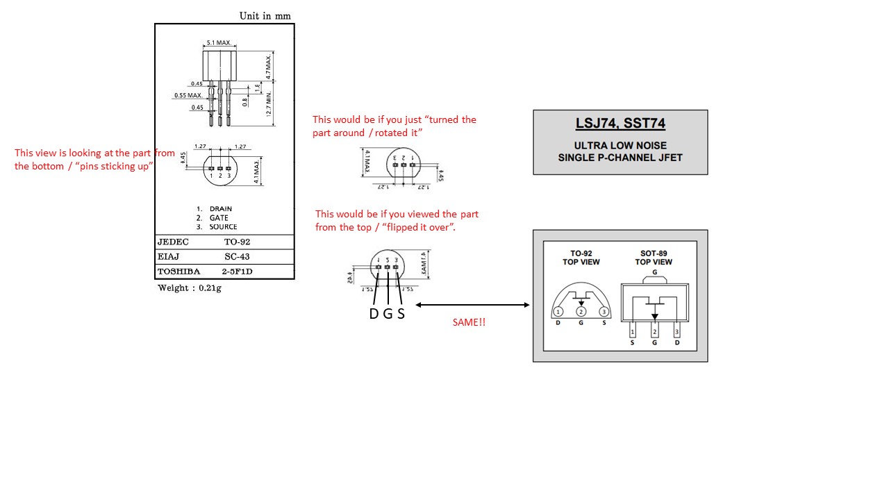

Makes sense. Why should LinearSystems turn the pinout 180 degrees for their
JFet which should be a direct replacement for the Toshiba SJ74.
But I remember that I spent a lot of time on the pinout of Toshiba 2SK170 /2SJ74 and the LinearSystems LSK170/LSJ74, when I was reading around here on DIYaudio. I remember my confusion when I was stuffing my BA-3 frontend boards and used Toshiba and LS devices.
Sorrry for the confusion! And tanks ZM for clarification!

Dirk,
Just for clarification. Like I had said earlier. The pin outs for the LS and the Toshiba devices are the same. They ARE direct replacements. See updated pic for one more try. In post #388, you originally had your LS correct, and Toshiba incorrect. We've shown that the Toshiba is the same.
The confusion seems to be that one company (Toshiba) shows the device looking from the bottom on the datasheet, while LS shows the device from the top. See the link to the conversation I posted for more clarification re: the standards.
Most importantly, just absolutely know and be confident that they're the same pinouts and that your original drawing of the LS device is correct, and that mighty ZM has confirmed that the Toshiba is the same. And.... for just once... I got something correct. :D

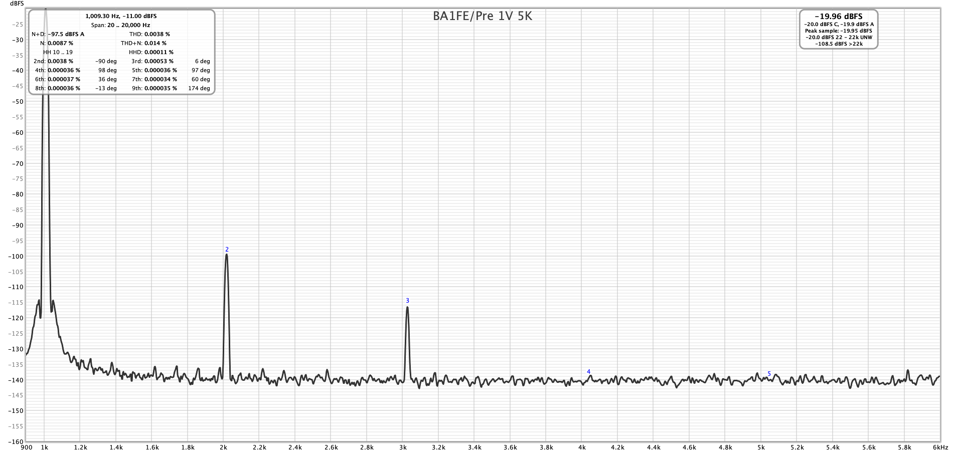

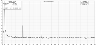

I finished up my little preamp implementation of the BA1 FE. Thanks again ZM for your help!
I've attached the distortion measurement. I tested with several loads, and it was pretty consistent all the way across. Not surprisingly, sounds a lot like (and measures like) the ACP+. I used 2SK2013 for both of them, which could be part of that. It sounds fantastic right out of the box, but I may play with the degeneration and/or current source resistors to see if I can tweak spectra and THD in general. I put a few key resistors on sockets in anticipation. Honestly, I just love tweaking this stuff :)
Offset is stable and under control at 0mv, so also thinking of removing the 10uf coupling caps, which could be one advantage it has over the single supply ACP+.
All in all, a great front-end!

I successfully dropped the coupling caps on output today. This thing is sounding really good, especially paired with my F5. Has all the things I like from the ACP+, but also a nice bipolar, regulated supply (Salas UltraBIB) and less caps. I'd like to think I'm responding positively to the positive phase H2, but at .0036%, I'm not sure that's true :)
