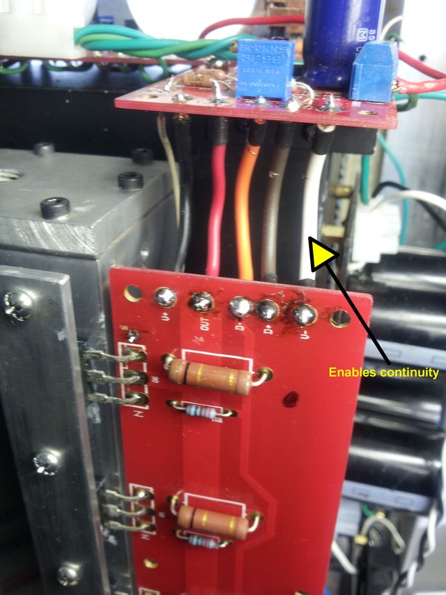

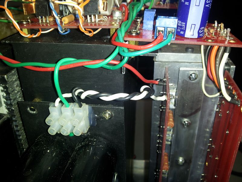

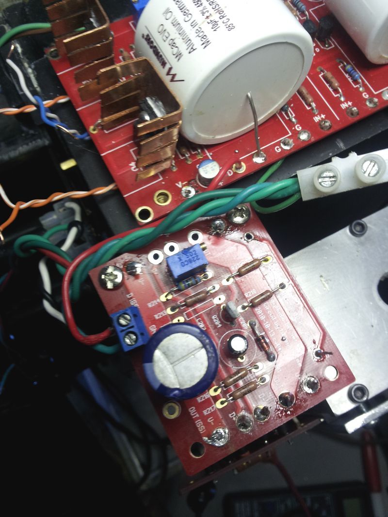

Still got gremlins. As soon as the output boards are connected the bias trimmer becomes inactive. The first picture shows power coming through the OBs. The second is feeding the bias boards directly. Both produce an unmovable 0.574 mV accross the resistors..
FIY - yesterday's high voltage readings on the resistors were due to a bad connection on the "S" link.
I did complete the full setup as described by ZM but could not make adjustments. I cycled back (4th time) and confirmed trimmer activity with PS and bias boards only. PS + bias bds + output boards is thermally stable but still no adjustments possible.
Configured one channel for sound and found good music and no hum or distortion. There is no continuity on any fet pin on that side, but a few developed on the other - probably over tightened and will repair.

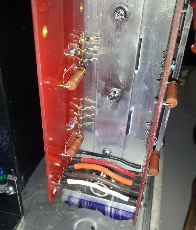

Third pic is just the star ground used for both measurements and the music test.
Is anyone aware of an independent test for some kind of loop or back-feed on the output boards?

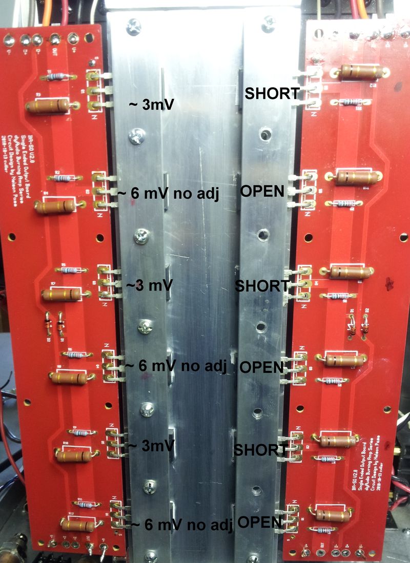

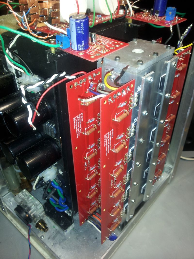

Being both suborn and curious, I put the amp back together one more time before completely dismantling.. Found some interesting things:
1st channel plays music and three of the mosfets do adjust between 0.203 and 0.325 mV. I can hear the change in volume thru the speakers. The other three are stuck at 0.596 mV.
The second channel produced continuity before I could apply power again - but it is the same pattern as the first channel. My first thought was to replace the shorting three, but after taking a better look at the traces on these SE boards, see the alternating bus arrangement of the fets. The D+ and D- feeds follow that same alternating pattern and each D trace has it's own diode.
Could that indicate some of the diodes in the OBs are defective? Could be just a coincidence but looks suspicious.
Next step is swapping bias boards. New stuff coming but this has still got me pondering. Hate to give up without at least learning something.
and later that day.....
I installed one of the remaining populated output boards. Same results - no continuity to heatsink on any mosfet pin with physical mounting only. When all the signal and power wires were connected the same locations showed shorts. I pulled all the wires between the bias board and then added them back one at a time. Everything was clear till the last one, V-. Same three locations short. There are no solder bridges or other visible glitches on the V- traces on either board.
Can anybody make sense out of that one? :scratch:
