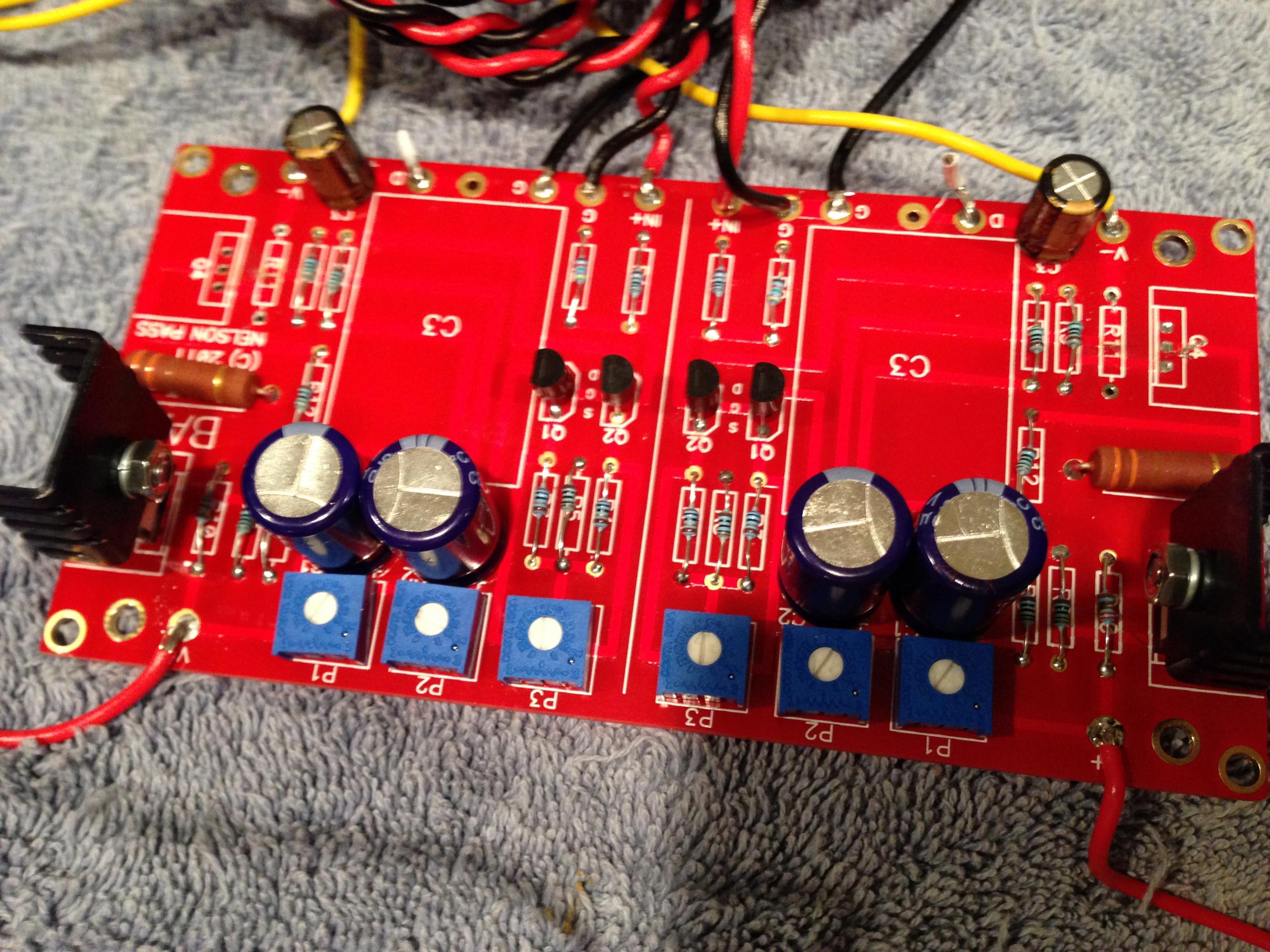

FWIW: This was my take. I did think an extra ground pad on either the BB or FE - or both - would add to convenience. I may end up with a traditional star lug, but needed to add a large terminal to get all three grounds together where I could see them - at least in the build phase..

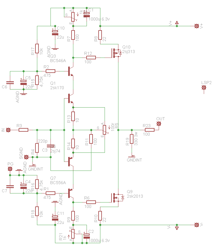

Hello,
I searhced for HV voltage version of BA-3. Could not find any so I decided to draw a schematic.
My aim is to drive class AB follower to with this.
I have tried many front ends before and I would like to try also this.
The rail voltage will be somewhere between +/-42V-55V
Any impressions on the design?
Generally speaking your circuit should work. I've built a similar version that ran fine at 36V.
However, you will need to recalculate the power ratings on a number of the resistors.
The cascode transistors Q3 and Q7 are also too small. I would suggest the 2SA/2SC parts used in the F5 Turbo. That's what I used.
Graeme
