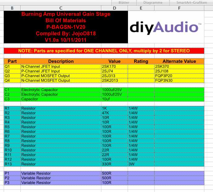

Hello gang, new to this thread. I have been following it for some time and decided to purchase the kits from DIY Audio. Had no problem with the BA2 pcb's - nice amplifier.
However, I did have problems with the BA3 pcb's. Once the smoke cleared, I noticed an error in the "P-BAGSN-1v20" BMO. I haven't scanned this thread completely to see if this has been reported before and there has been no revision to the BOM that I can see. My apologies if it has but I will repeat it here for the late comers...to save them from blowing expensive MOSFET's!
Q3 and Q4 are reversed on the BOM and the 2SJ313 is described as a N-channel MOSFET. Hence the smoke if you assemble the pcb using the directions on the BOM.
Took some time to figure it out but now, the boards are ok and the amp does sound very nice too. But boy these are hot babies.
Joined 2009
the BOM in the european store seems o.k. to my eyes.....:D
but you are correct it was wrong some time ago...

Thanks, generg.
The version of the BOM I got from the USA store back in September was V1.0 08/18/2011.
I just checked the site again and it has been corrected to the same version (V1.0a 10/11/2011) that you showed.
All is well in the world once again.
Hi!
I'm sorry to hear you got the V1.0 of the BOM. The error was corrected as soon it was discovered.
Making tens of BOMs at the same time is really bound to have errors I guess, but it's not an excuse so I checked everything again and again.
Please, if you guys discover anything suspicious in the BOMs, please do send me a PM and I'll gladly see to it.
