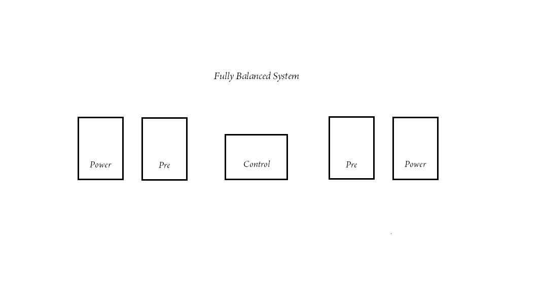

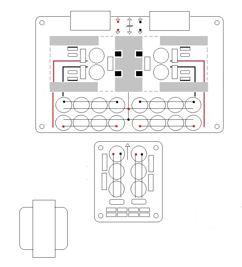

I would do what I have suggested and will be doing personally. Put output board and bias boards in main case with Psi and have FE separate in module with connection to both amp and psi.
not too late to change my mind about this

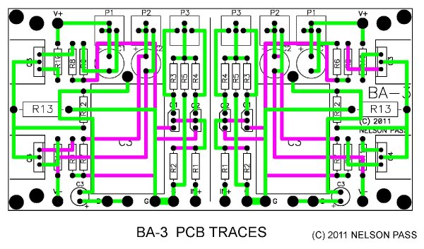

Skip Pack, I think its 0,5watt Bourns or Wishay, but watch leg configuration on the board
I just want to make sure I'm ordering the right pieces. What
is the appropriate wattage rating, and are there preferred peices?
thanks,
Skip Pack
ok, looking at the board
it seems like Nelson have made sure that almost all kinds of this trim pot type can be used

And they are so accessible!ok, looking at the board

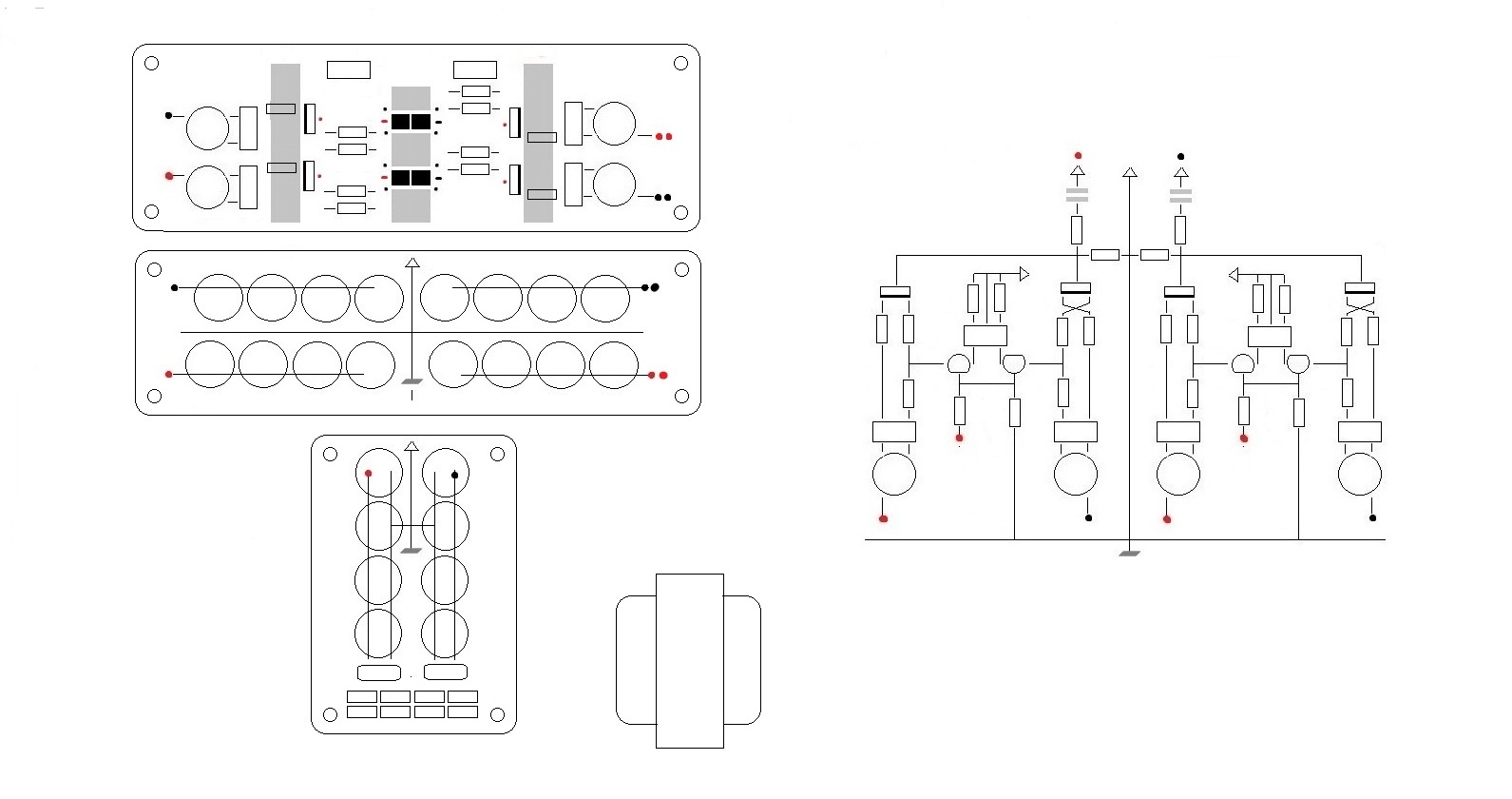

here is what I have until further happens
and some components still missing on layout
can't stop it now

The idea I referred to is bi-amping indeed; this means one driver stage (FE) does the hard work, the rest is -if needed different types - a plain follower stage with specific qualities. Some output stages sound different than others, as you know. Some better for treble frequency others for bass.
Switching around is a central theme with the new modular structure.
