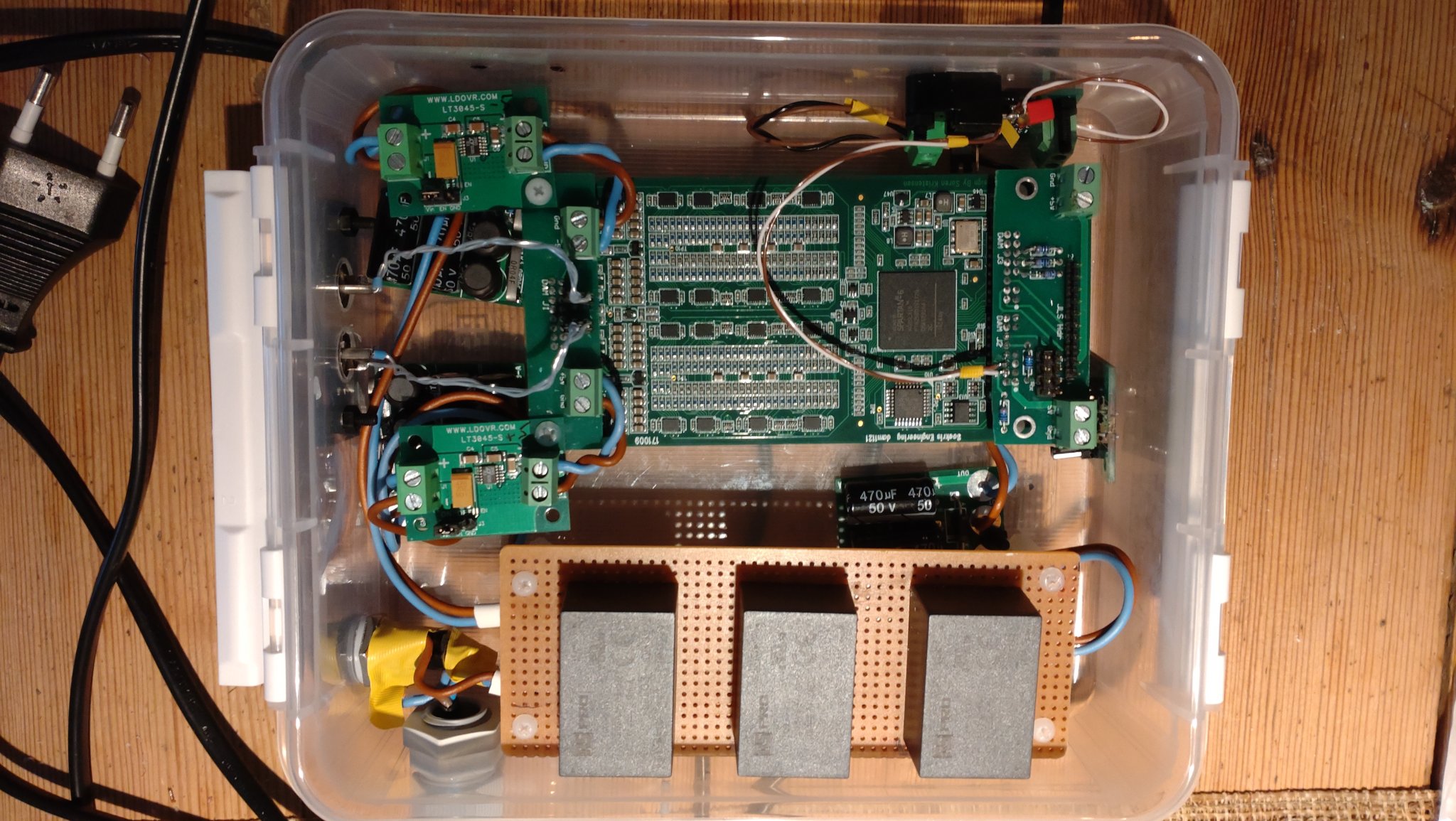

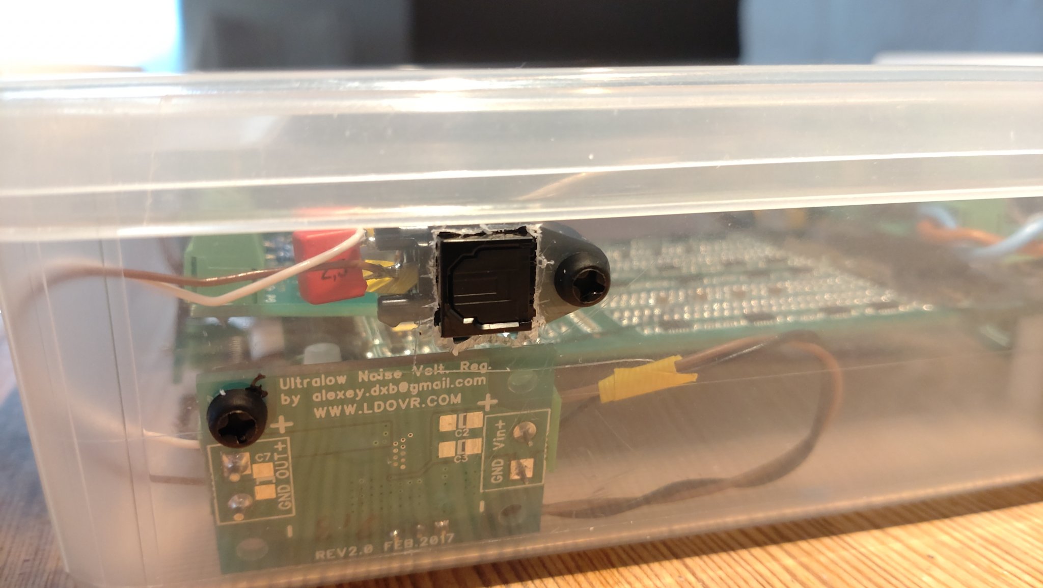

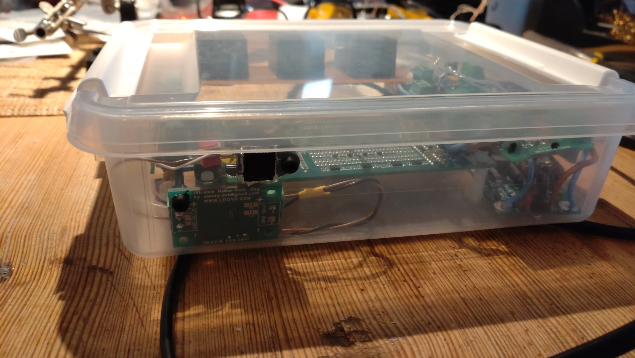

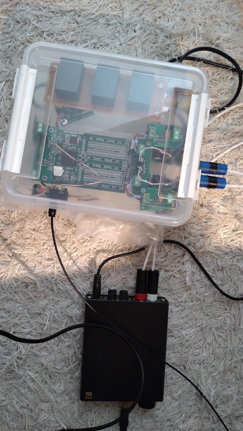

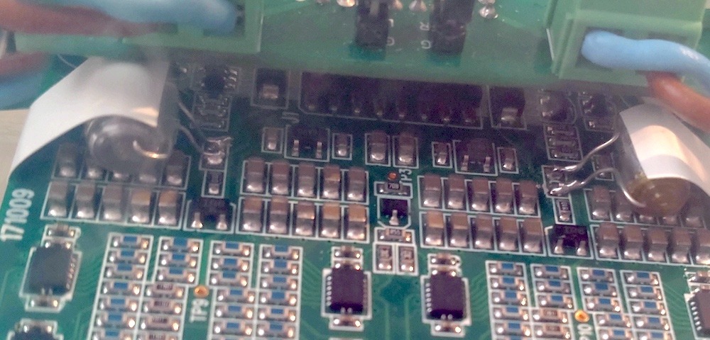

I built this for headphone duties and it turned out very nice indeed.
Receipt:
  • 3 pcs of RS PRO Encapsulated, Switching Power Supply, 9V dc, 330mA, 3W
  • 3 pcs of DC filter PO89ZB
  • 4 pcs LT3045 based stabs. Three 5V for the DAM and one 3,3V for the opto receiver.
  • a little bit of this & that...
It's hooked up to a Topping L30 and a pair of Philips L2 and the combo sounds absolutely lovely as I hear it - powerful, detailed, full, stable. I never enjoyed HP listening before really but this... :) ... with styroflex on the output and in +++ mode ;-)
Some pics below - maybe it will end up in a little more stable case later on...
c.jpg one shows the cap placement.
