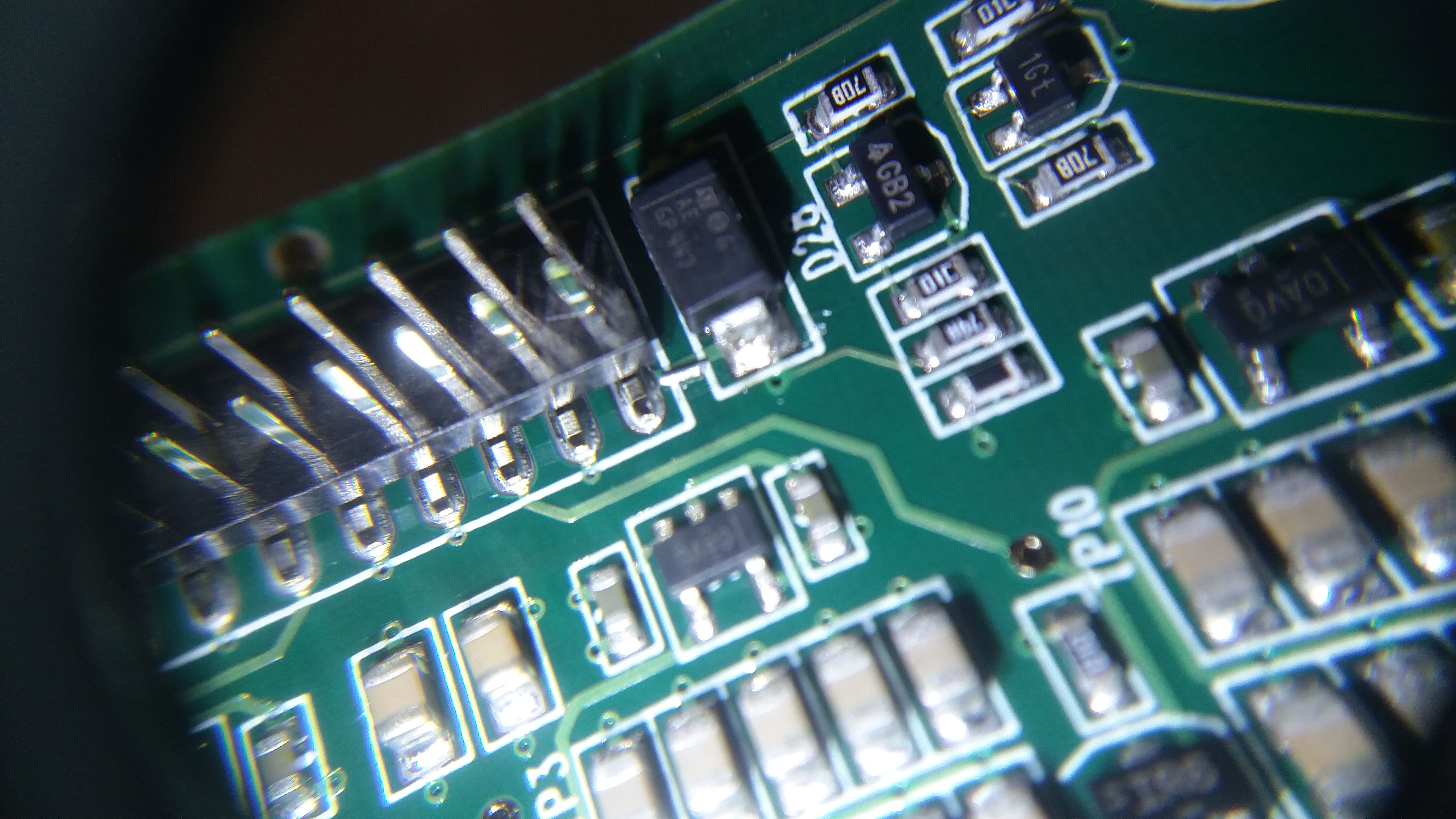

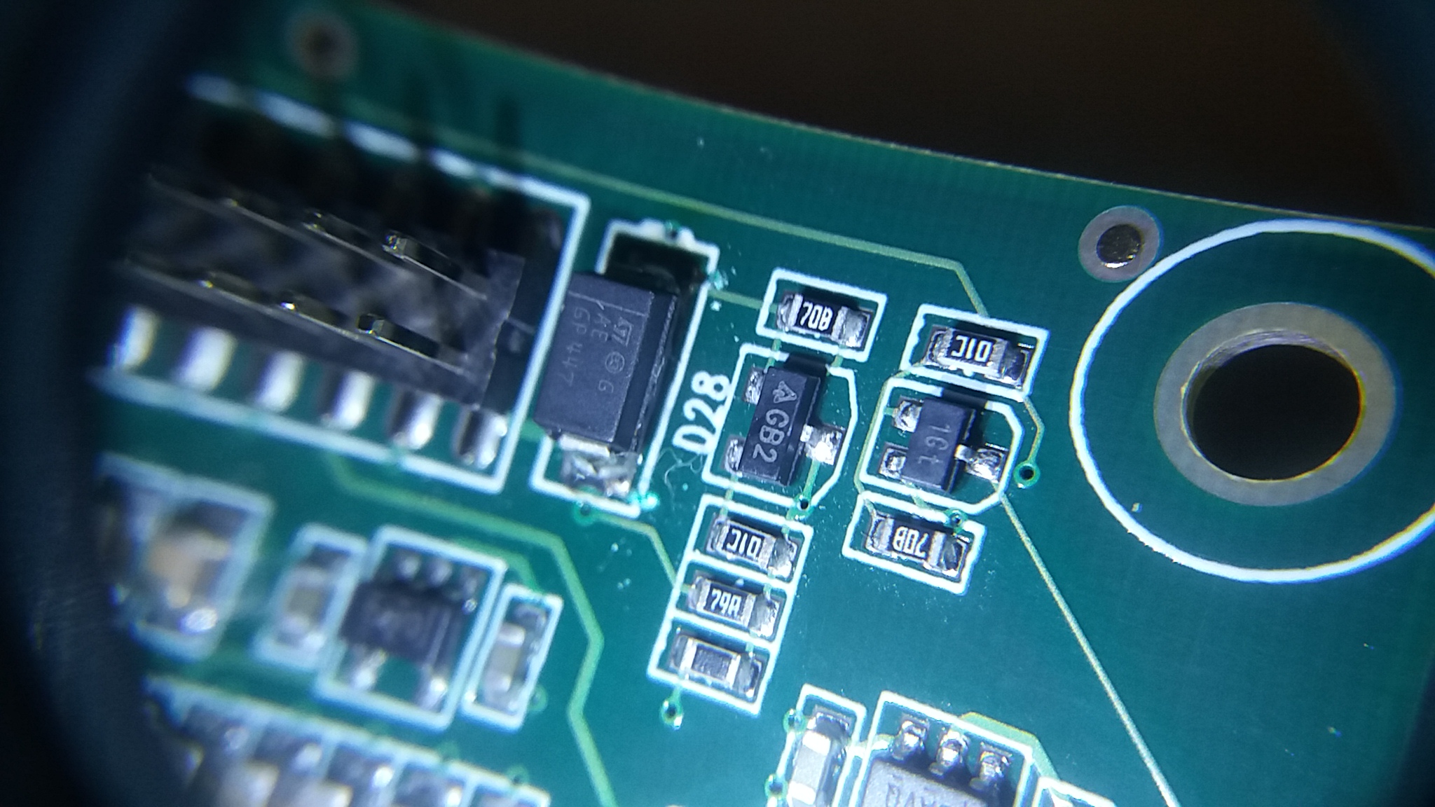

Just received and open box.
Surprise.
The problem is ? I actually had to reverse that power protection diode as the contract manufacturer made a mistake on the first batch.
The first board there might be a piece of solder left, just take a small brush and remove it. Anything else just looks like a little flux residue, don't do any harm.
The second one have scratch on PCB case by retouch.
I don't know why the factory accept the the pcb have scratch have retouch.
And the QA accept the piece of solder left on the PCBA.
Joined 2009
I can't see any problem with the PCB.... And they're all fully electrical tested anyway. Or at least specified to be, you never know with these far east PCB manufacturers....
Maybe because the rework QA (In this case me....) missed it ??
