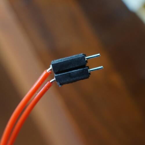

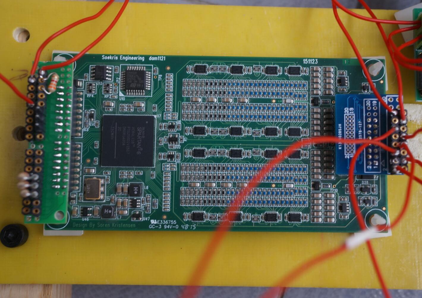

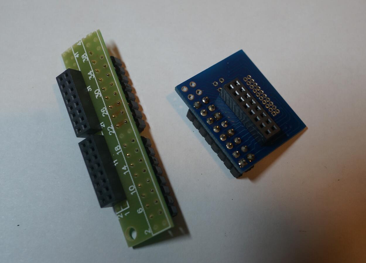

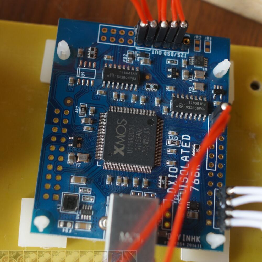

Hi, the blue one has 2*10 pins. And the green one has 2*30 pins pins. You only need 2*20 pins at most though. I just bought what ever I can find cheap from taobao.
Since it is just for testing it won't matter that much. And this approach won't damage anything of the DAM1121 board. Don't need solder nothing on 1121 board.
As for the socket pins, I like them so much that I use them everywhere. :)
I am not good at tiny things. My eyes cross whenever I have to deal with tiny little things. I have tried making those board to board connecting wires but failed to pinch wires into the connector/header sockets. There are wires with connector on market but the wires used are usually as thin as hair. So that is just my quick solution. Cheers.
