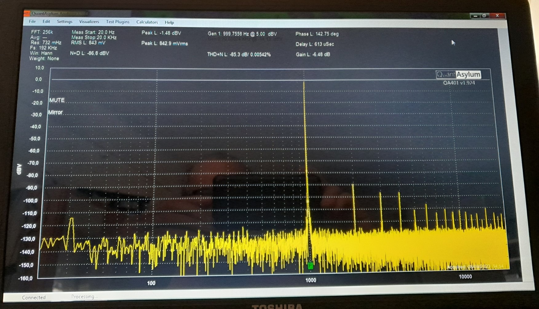

I finaly received the sowters trafos 1495 and connect them to my setup , after some testing it seems that i/v resistors are mandatory at the dac output to ground , I have 80 ohms , and no resistor at the secondaries , it does not work

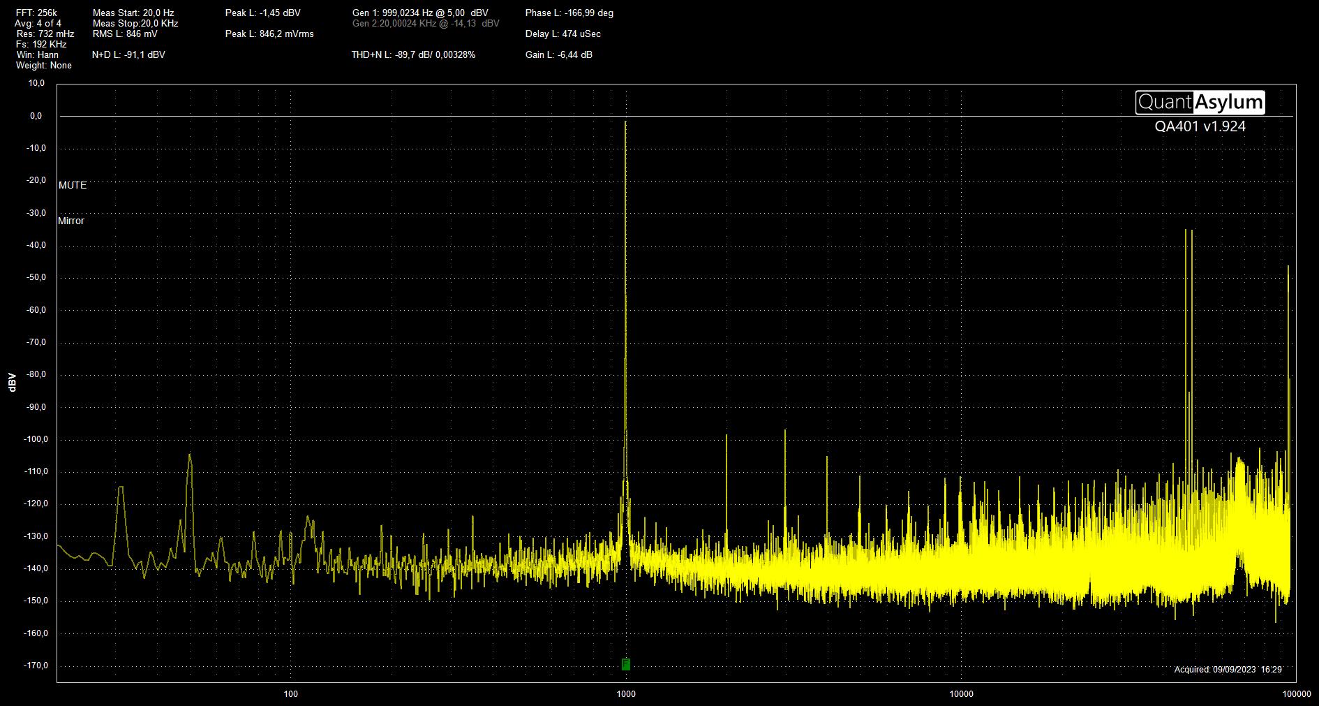

0 mv DC , thanks to the biais trimmer , and the lowest distortion figure thanks to the 10 ohm trimmer
things could get a bit better I think , matter of time

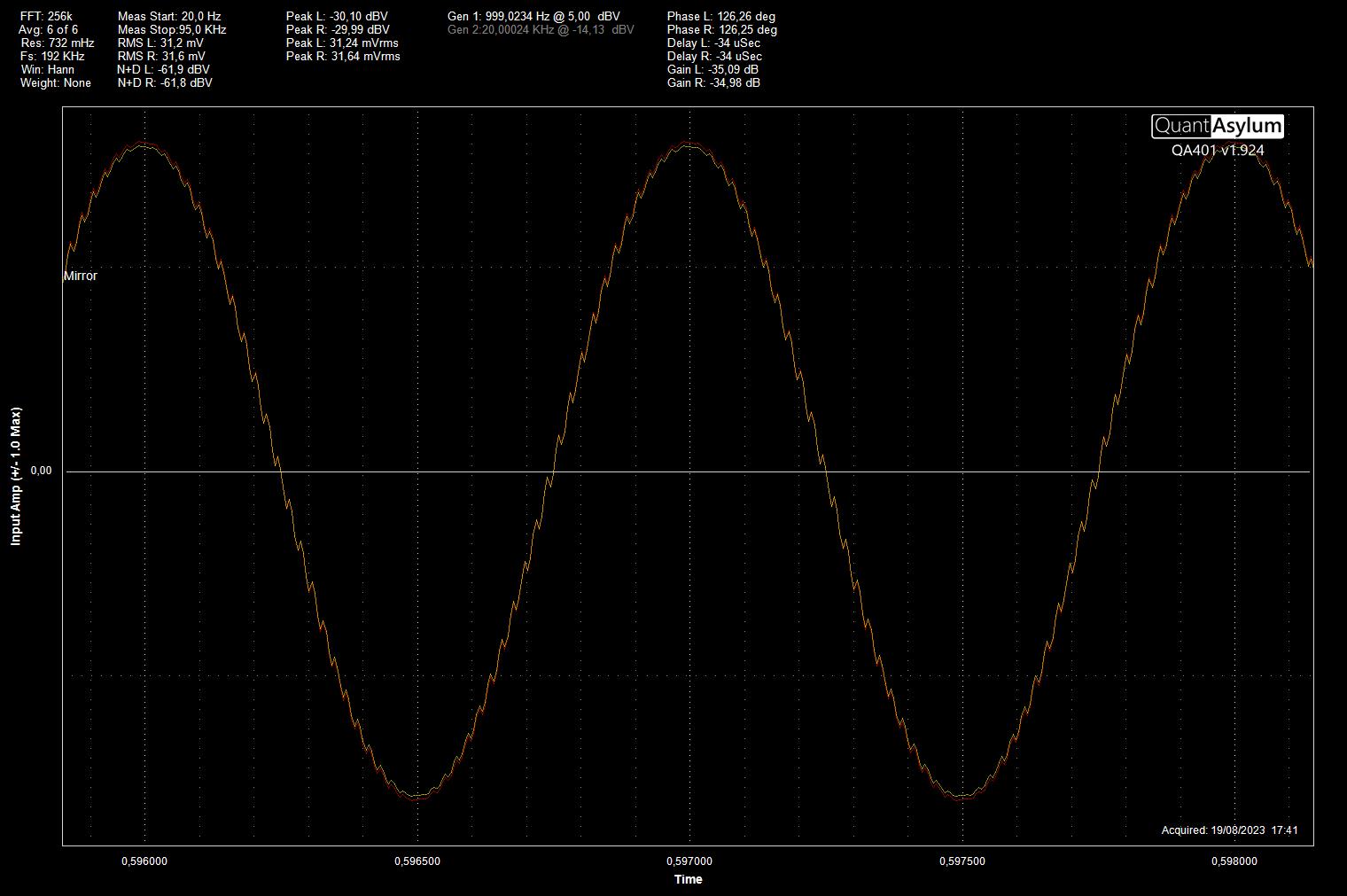

I decided to go parallel , and I got this first result in the audio domain :
secondaries in series give twice the voltage but an slightly higher distorsion figure
now I have to find the good HF filtering method , any passive advice welcome

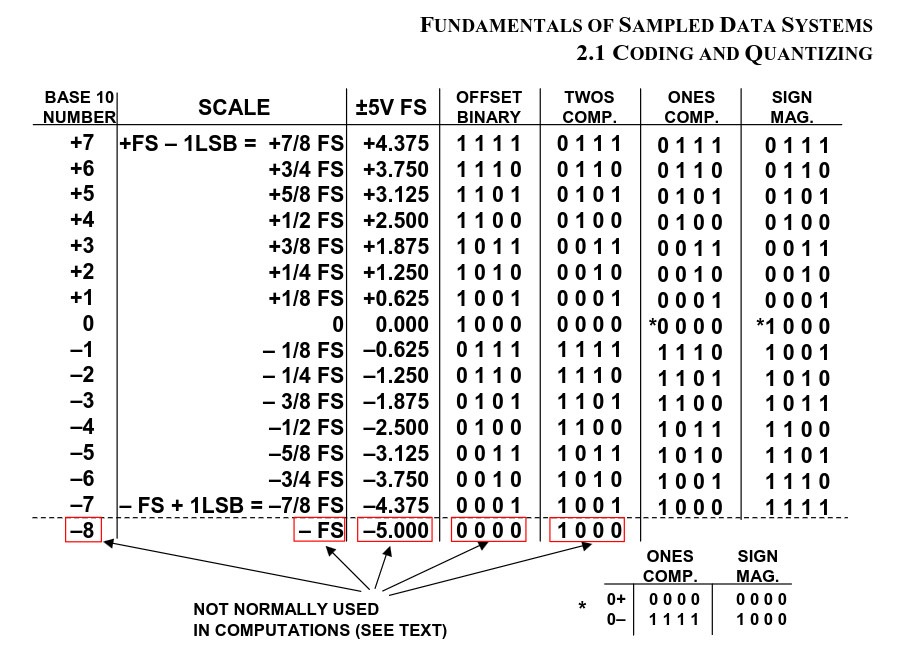

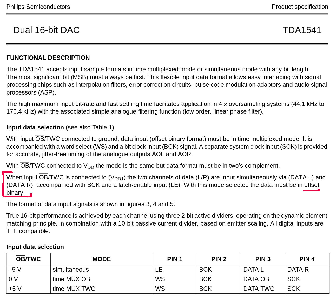

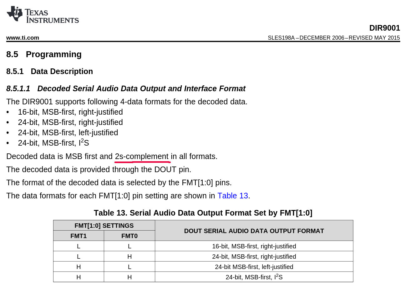

Look (taken from here):
John calls his solution "17bit signed magnitude" DAC, but the DIR9001 outputs "two's complement":
The TDA1541A expects "offset binary" if used in simultaneous mode:
Correct me if I am wrong, but it seems there could be some confusion that leads to the problems you (and others) describe. Did John mention the modul or chip he used as a source for his 17bit DAC?

iirc John did make various versions of logic for i2s and left justified, but I don't know if he fed his simulations with 2s compliment or COB. What I know from my own TDA1541A project is that I need to program my PMD100 to output COB, otherwise the TDA1541A wont work. I am no fan of NOS, but I would love to use the PMD100 to feed the 17bit signed magnitude DAC. I think that should allow to further simplify the logic - but that's another topic...
