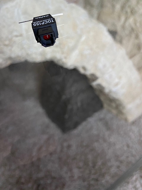

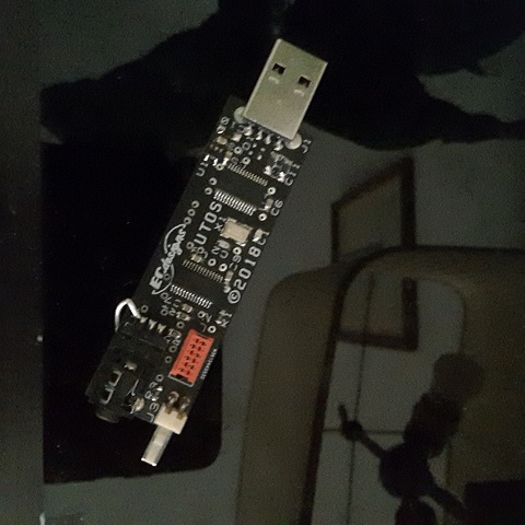

Here is a picture of the modded UTOS (not done professionally, unfortunately, but I put protective electrical tape around it), and the modded UPL with the ElectroTos cable supplied by ECDesigns. The modded UTOS can accept either regular toslink cable or ElectroTos using its small jack plug. Please note that they will offer, as they explained, a better designed cable with their next product line (RCA connector out, better Toslink in). P.S. on the back of the UPL there is a piece of scotch tape on the USB plug that is used for firmware update - just so I do not use it by mistake to recharge the UPL.

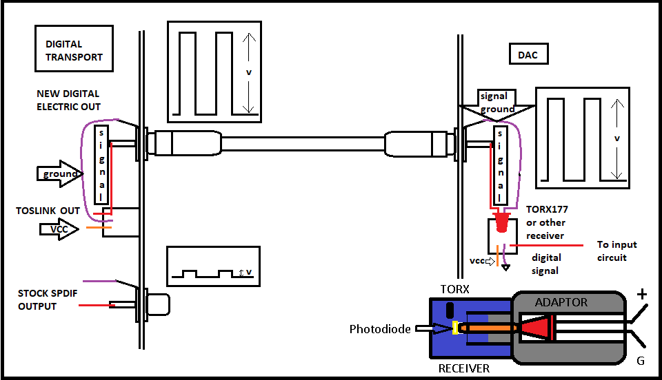

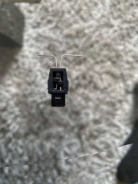

Just to make it more clear and to remember the other option of Elektro-optik connection...
This is a mechanical sort of optimal solution. I do not claim to be a perfect technical/electric solution...the adapter has a small fiberoptic portion inside the shaft, the orange part.

I guess...just try it and see if it locks signal OK.
The mechanical grip must be tried into the receiver, I believe, before final assembly and soldering, because the internal structure of the receiver could limit the entry of the connector. In other words you may have to install the LED a little to the back back. It could be millimeters...
Remember, the signal must be higher the the standard 0.5V. Mine are +/-5V. Guess 3.3V could also work, if light power is enough, and or your receiver is sensitive.

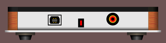

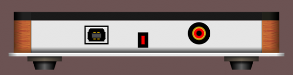

We hope to offer the U192ETL S/PDIF / ElectroTos translator and DA96ETF Fractal DAC in roughly 1 month.
These products will appear on our website as soon as these become available. Pre-orders (email) will have priority.
Specifications:
- USB bus powered (5V).
- Power supply CLC filters for bus noise attenuation.
- XMOS XU208 with built-in Flash program memory.
- Low jitter system and audio clocks (comparable with NDK), 24MHz, 22.5792MHz, 24.576 MHz. Each oscillator has separate RF supply noise filtering.
- Advanced synchroniser / driver circuit for XMOS jitter attenuation.
- Supports standard S/PDIF and ElectroTos low jitter protocol (jumper setting on the rear of the module).
- RCA (coax) output for driving the ElectroTos interlink (3.3Vpp).
- Power consumption approx. 500 milliwatts.
- ElectroTos interlink (supplied with module), 1 meter (39").
- Supports 44.1/16 ... 192/24.
- 160mm x 160mm x 30mm (6"x 6"x 1").

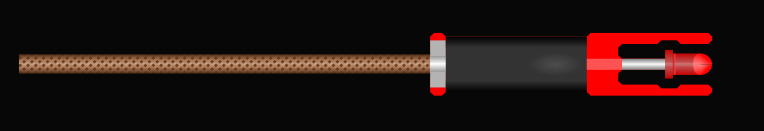

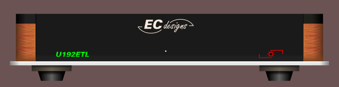

I attached sketches of the front and rear view. and a sketch of the planned ElectroTos interlink. The optical plug has integrated spring clamp mechanism that locks the connector into the Toslink socket and accurately aligns the ultra high speed LED with the optical receiver chip inside the Toslink socket. The LED wires are supported by the PCB. We use professional Hi Temp MIL spec coaxial cable.

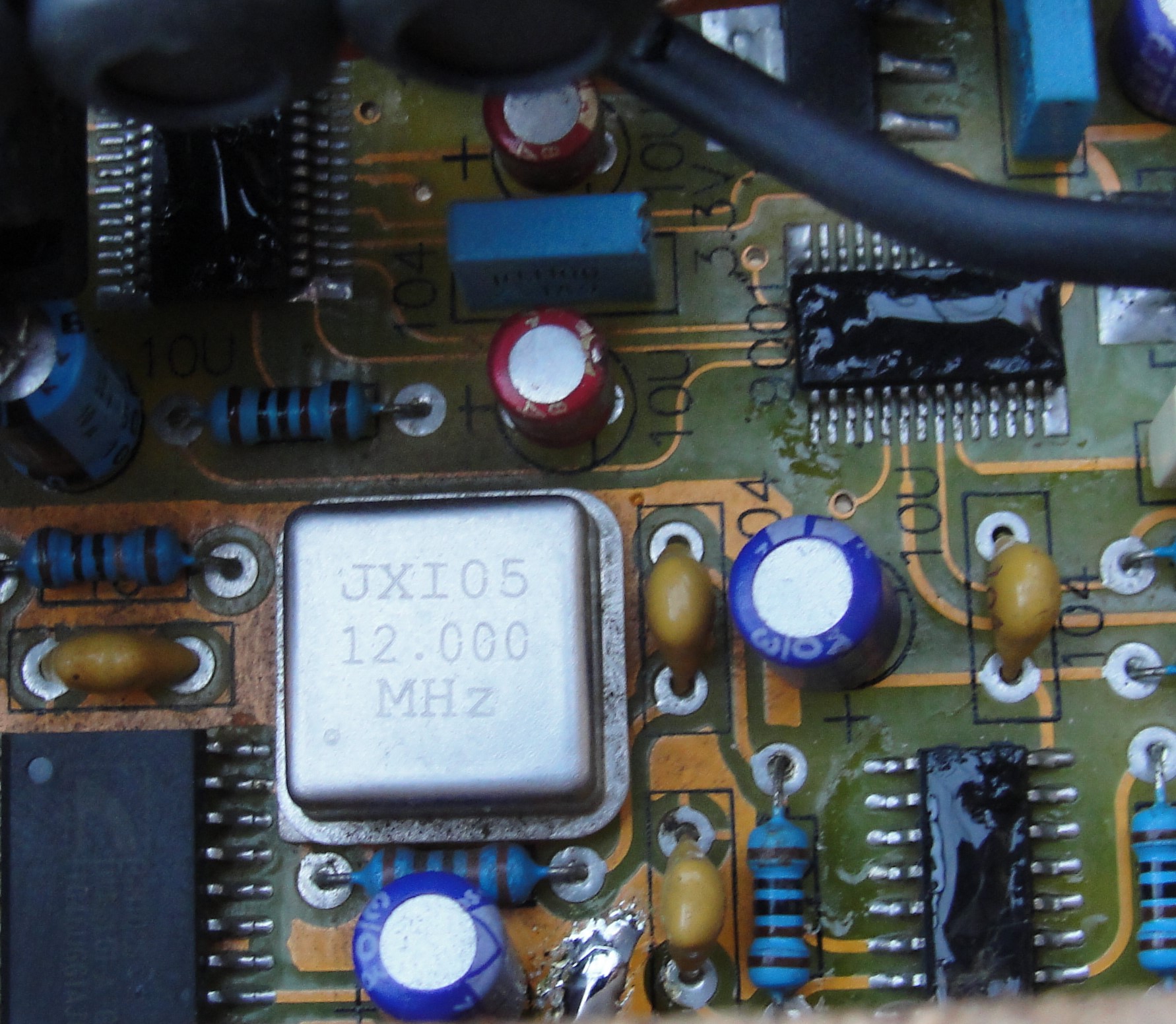

I wanted to re-visit my favorite digital tweak. :cool:
I have commented previously,without much success to be completely honest :D,about the wonders of organic varnish made of Linseed oil and turpentine to improve sound in woofers' cones, applied in summer to accelerate drying time.
The same varnish with added graphite powder, "pencil grade" :D, does wonders for digital chips, meaning digital receivers, DACs, shift-registers, etc, provided you do not paint the leads...my last version, a 50/50 mixture of the above ingredients, was resting for eons under sun light, and now it is a thick and nice varnish,turpentine being evaporated. I put the unit belly up for some days until it completely dries. It can also be made on a 70/30 mixture to make it thicker and avoid long waits.
In case you do not like the effect, simply remove it when dried. ;)
The effect on the MOSAIC UV was astounding. Organic, tight but expansive sound.

Did you try the graphite pencil grade alone on the chips but applied with the pencil directly ? same but no varnish to improve the cooling ? or an adhesiv paste made of thermal paste mixed with plenty of graphite powder hat may also allowing a copper hat grounded at the gnd pin of the chip ?
OT, while I believe the linseed double boiled oil that is typcaly used for wood being outside (all have not the luck to have auracaria tules ;) ) or veenering has changed the Qts because the weight, what do you think about a sticky not-drying layer as for Dynaudio Esotar tweeter ? Targett : better damping and breaking mods !
Asking myself about your original mixture on polypro cones for breaking their "muddy" sound due to break modes that polypro gives ? Could be very good too (or an usual organic/vegetal shellac instead linseed oil) !. Sorry for the OT.
im confused about the electrotos interlink... is the U192ETL S/PDIF suited for the MOS16/Mosaic T DAC?
is there only one spdif toslink output?
what is the expected price?

Hi Max,
Good ideas, worth trying, especially pencil over tinny logic chips where varnish could be risky.
I believe that Dammar varnish has also especial effect, as the sound changes (improves) during the days it dries.
I have not tried shellac.I do use other more stiffer gums mixed with Dammar which remains the main ingredient.There are two ways in which I have made this varnish: one is the usual disolving "à bain Marie"and the preferred slow dissolving through direct exposure to summer sunlight. I am not an organic chemist but I believe this method produces better characteristics by naturally modifying the terpenes, as commented by Fry (if I remember correctly) in his famous book about "Old Italian Violin Varnish" ;) a must read for any violin lover and collector as yours truly.
I have never tried the varnish on tweeters (nor on polyprop) but I may on my test speakers.
I believe the added weight has lower effect (QTs?) than improved visco-elastic properties of treated paper woofers, probably the former varying linearly with added substance and the later varying non-linearly or exponentially(?) due to the improved mechanical properties of the cone, so it always did a good job IME. Curing time could be weeks though, depending on weather.
