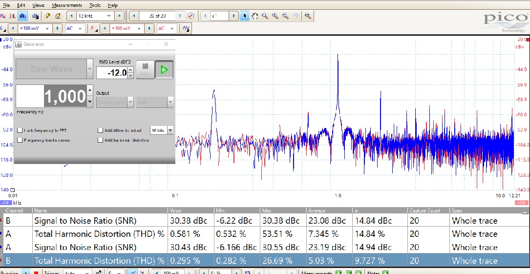

GROUNDING CT REDUCES DISTORTION..
I tried an experiment in grounding the centre tap. The distortion at 1Khz was reduced by 2/3rds.
See traces - one channel has the CT grounded, the other doesn't. (I can't explain the peak at 1.84Khz.)
-9 to -12db was the optimum signal level and equates to about 2v p-p output from the Sowter transformer secondaries which is enough to drive my Quad 405 to full output with vol pot on max.
The signal generator is part of REW room equaliser software, and an el cheapo usb to I2S adaptor is used, and connected to the second I2S input on an IanCanada Fifo II.
I checked the sig gen output using the laptop's headphone output yesterday and although the SNR is poor, the distortion was lost in the noise at -50db.
My next step is too try current injection with the CT grounded or not.

Were you grounding CT without applying 2 mA bias?I tried an experiment in grounding the centre tap. The distortion at 1Khz was reduced by 2/3rds.

Yes it was primary CT and yes, I know it needs current injection to cancel the 2ma offset.
I was just curious. I wonder why the DC flowing did not increase the distortion?

I checked my software sig gens via the heaphone output again.
NCH was 3% at best at 1kHZ and REW v5.1 was 1.5% at 1k.
Now plugging in the usb-I2S interface and from the transformer output, REW was .6% and .2% with the CT grounded so looks promising.
(With the CT not grounded at -10db there were 2nd & 3rd harmonic spikes visible but with it grounded these were lost in the noise.)

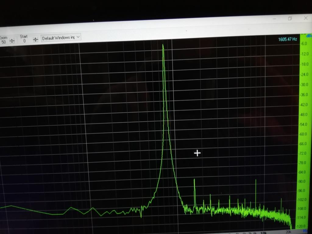

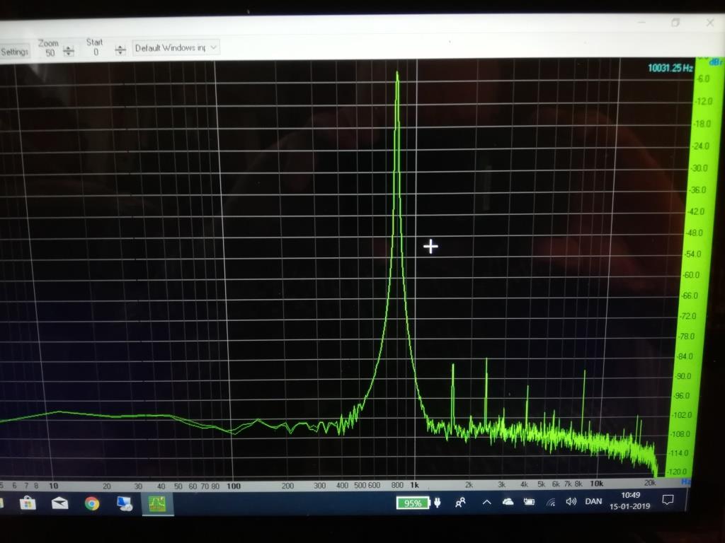

I cleaned up my measuring system with another input device.
All measurements are made with 2 mA bias.
First 0 dB digital with 100 Ohm from DAC out to ground and no secondary load resistor (Pic. 100 Ohm Riv)
Next 0 dB digital with no Riv and 56K secondary load resistor . This value made the same level out of DAC @ 0dB digital.
If I reduce the digital level with 10-12 dB all harmonics disappear in the noise...
Almost no difference.
Then I measured 0 dB digital with 10K secondary load resistor and more gain after the DAC.
Notice the 3. harmonic is reduced as a result of the lover level at the output of the DAC.
I am not sure it is noticeable sound-wise I have not listened carefully for a prolonged period.
It is only the 2. and 3. harmonic that comes from the DAC/Preamp the rest are there even if I turn off the Dac.
If I reduce the digital level with 10-12 dB (turning up the preamp gain ) the 2. and 3. harmonic disappears .
