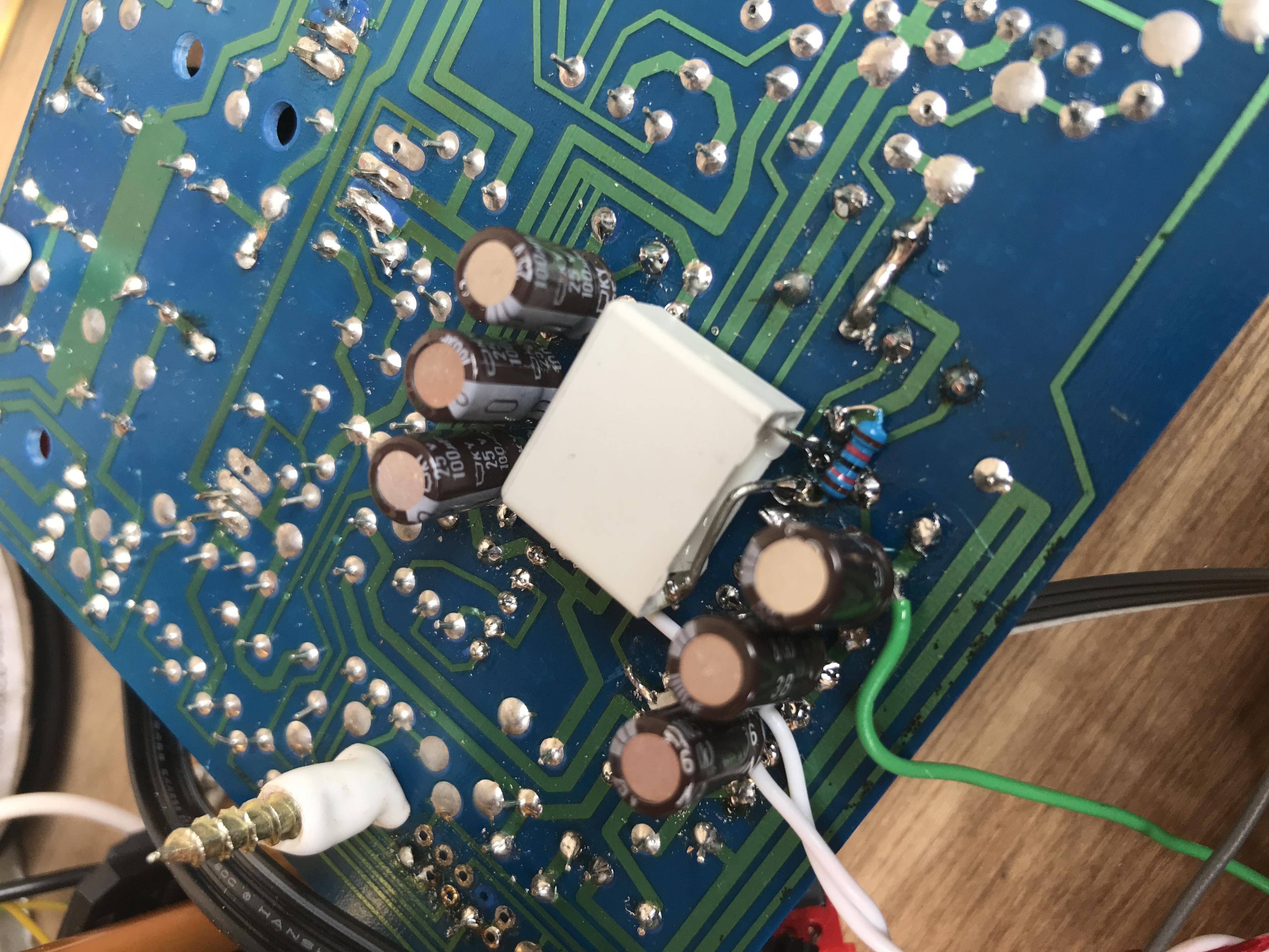

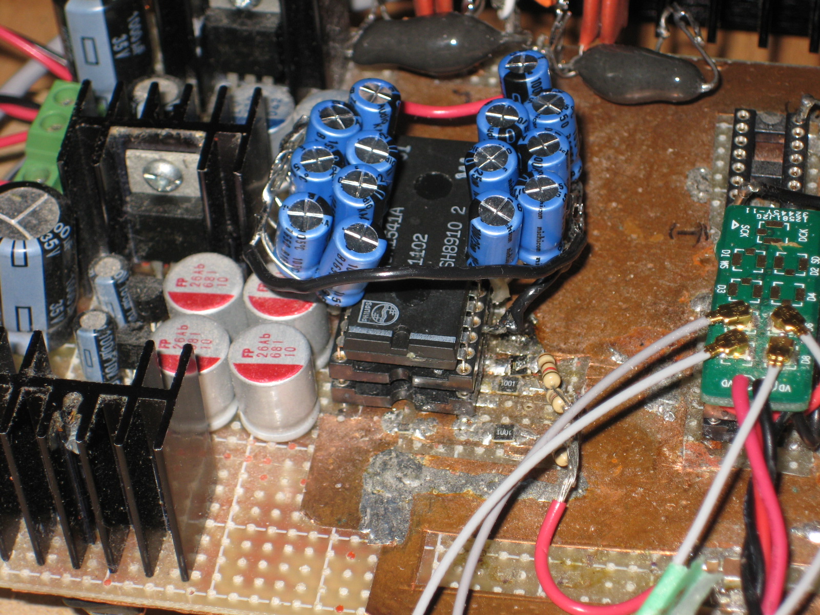

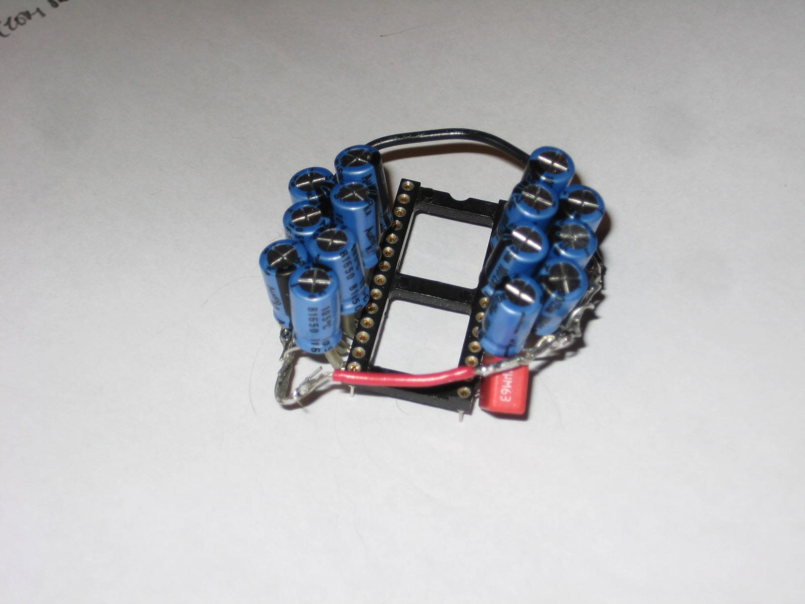

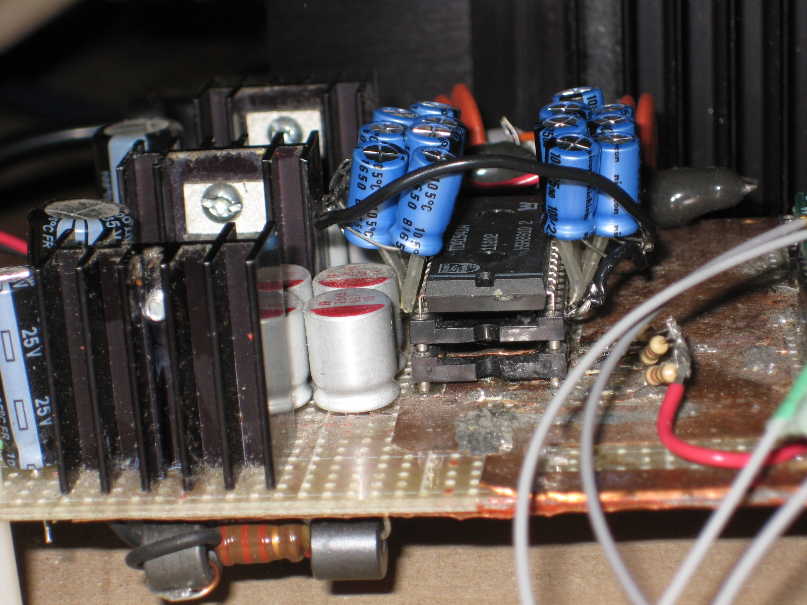

On my diy dac board, there was no room to install some and/or no access for connections of the 100uf capacitors. After some thought, I came up with an adapter which incorporated the 14 100uf capacitors and the one 1uf capacitor. The board already had 6k8 ohm resistors to pins 16 and 17 and also had a 2.2nf capacitor between pins 16 and 17. I left them in place along with the exisiting 14 smd capacitors on the underside of the board.
After listening for a while, I think I hear a higher level of resolution during quieter passages.
Prior to this work, I had replaced Ian's I2S to PCM board with Ryan's ECDesigns I2S to Simultaneous board, and I heard changes similar to what Ryan heard. My iv is passive with 63 ohm diy handwound resistors along with +2mA bias. This is then fed into my preamp.
So if you have a TDA1541A dac board that has no room to install the large capacitors but you want to try the 50Hz DEM, perhaps a diy adapter such as the one that I built may work for you.

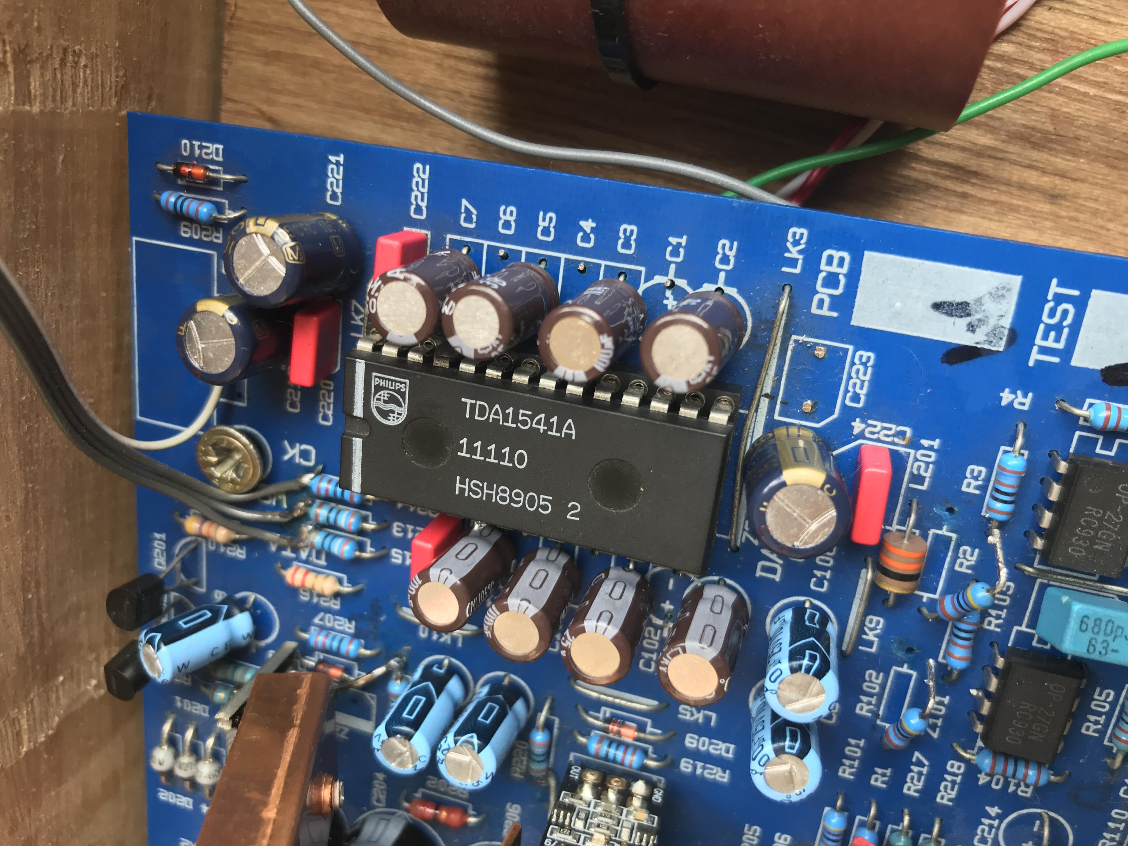

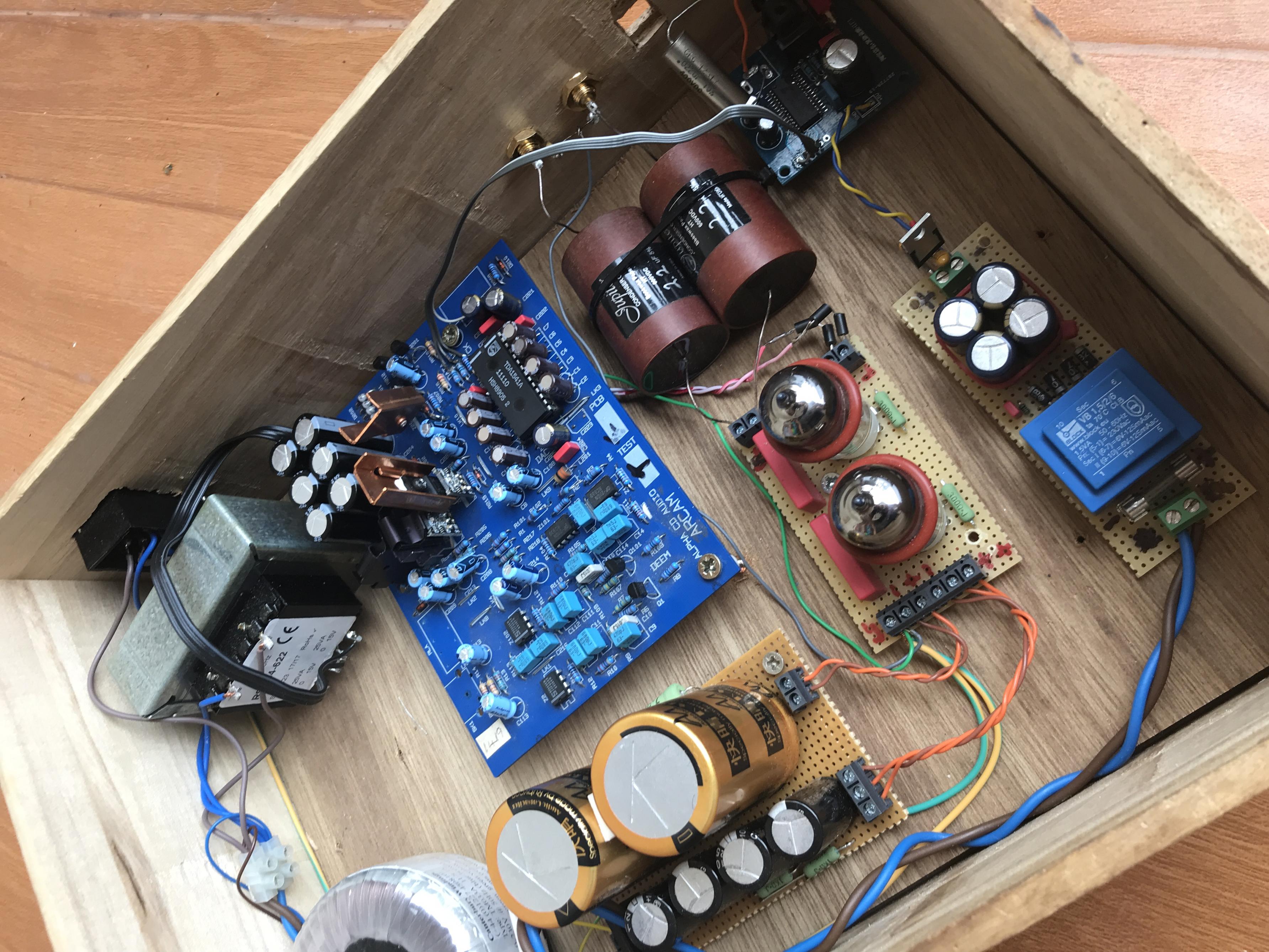

So I got around to pulling my DAC apart and joined the 50hz DEM club.
Obviously because I had to pull my old caps etc. I can’t do a A-B but I like what I hear.
Still running I2S (as I am still to get BOM for making up convertor boards I got from Ryan)
Previous version was
pin 13 & 18: 2.2 uF PPS
pin 12 & 19: 470 nF oscon
other decoupling caps: 220nF mkp
And some other DEM reclocking that I can’t remember - but was probably 6.8k x 2 and small value cap?
Now 14 X 100uf/25v Nippon Chemi-con KY, with the 12k pin 15/17 and 2.2uf PPS on pin 16/17
As you can see from the pics I alternated the caps top/bottom to fit them to the board.
(In the process I found some errors elsewhere from my dodgy work and I was surprised that my DAC was working at all!!)

Have you check the new dem clock frequency? I use 1uf on pins 16/17, with 10k to -15 from both pins and dem is about 50Hz. (not sure whether any difference would be audible).
Simultaneous operation + stopped clock you will find, makes a big difference to sq.
