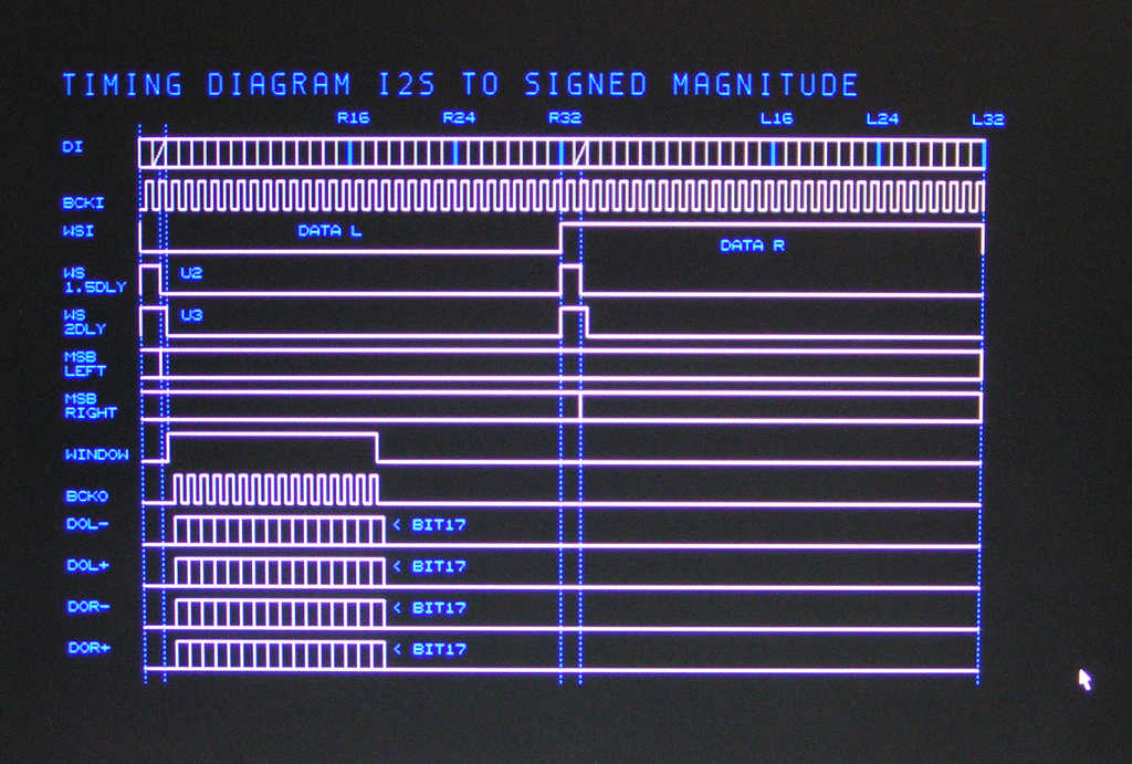

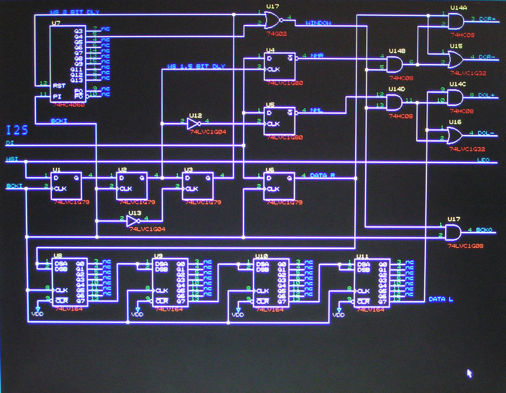

Hi
I have a couple of questions to the suggested I2S to signed magnitude proposed by John in post 6126:
The way the DOL- and DOR- is made with an AND gate and an OR gate , isen't it the same as just inverting the DOL+ and DOL+ ? I guess the reason for doing it the way John does is to avoid propagation delay between - data and + data?
But dosen't it then produce the infamous LSB error?
Another question is :
If I want to make a balanced DAC with signed magnitude TDA1541, I would have to have 4 TDA1541 and for the 2 TDA1541 producing the inverted analog signal, I just have to connect the DOR+ and DOL+ to Data L input and DOR- and DOL- to Data R input... Right?
Have anyone tried this at home?

look at the post I pointed to. John has made a circuit so that TWO tda 1541 can work AS signed magnitude.
I have been studying this Signed Magnitude converter a couple of times, and finally I got the point.
To explain it in a more common language:
John uses one TDA1541 for each channel. Lets call the two DAC´s inside for the positive DAC (DAC+) and the negative DAC (DAC-). The output from these two DAC's are connected together and form one of the two stereo cannels.
Lets just look at the right channel.
The converter looks for the MSB to see if it is 1 or 0 and this controls the data stream to the two DAC'S(DAC+ and DAC-). If MSB is 1, DAC+ gets data, while DAC- does not get any data. If MSB is 0 DAC- gets data and DAC+ does not get any data.
The data the two DAC's (DAC+ and DAC- ) receives is selected by the window generator in the converter . This selects 16 bits , but not the normal 16 bits from bit 1 to 16, but bit 2 to bit 17...
So MSB controlles witch DAC (DAC+ or DAC-) is active (this now becomes MSB in the combined DAC (DAC+ and DAC-)) and the data clocked in to these two DAC's (you know by now ;-)) is bit 2 to 17 . And voila a 17 bit DAC with no zero crossing problem.
The rest of the converter is doing the job of delaying the Left data so the Left DAC (consisting of two DAC's , DAC+ and DAC -) receives them simultaneous with the Right channel.
Most of you probably have grabbed this a long time ago, but it was a good exercise for me to write it down, and perhaps someone can benefit from it (I hope :eek:)

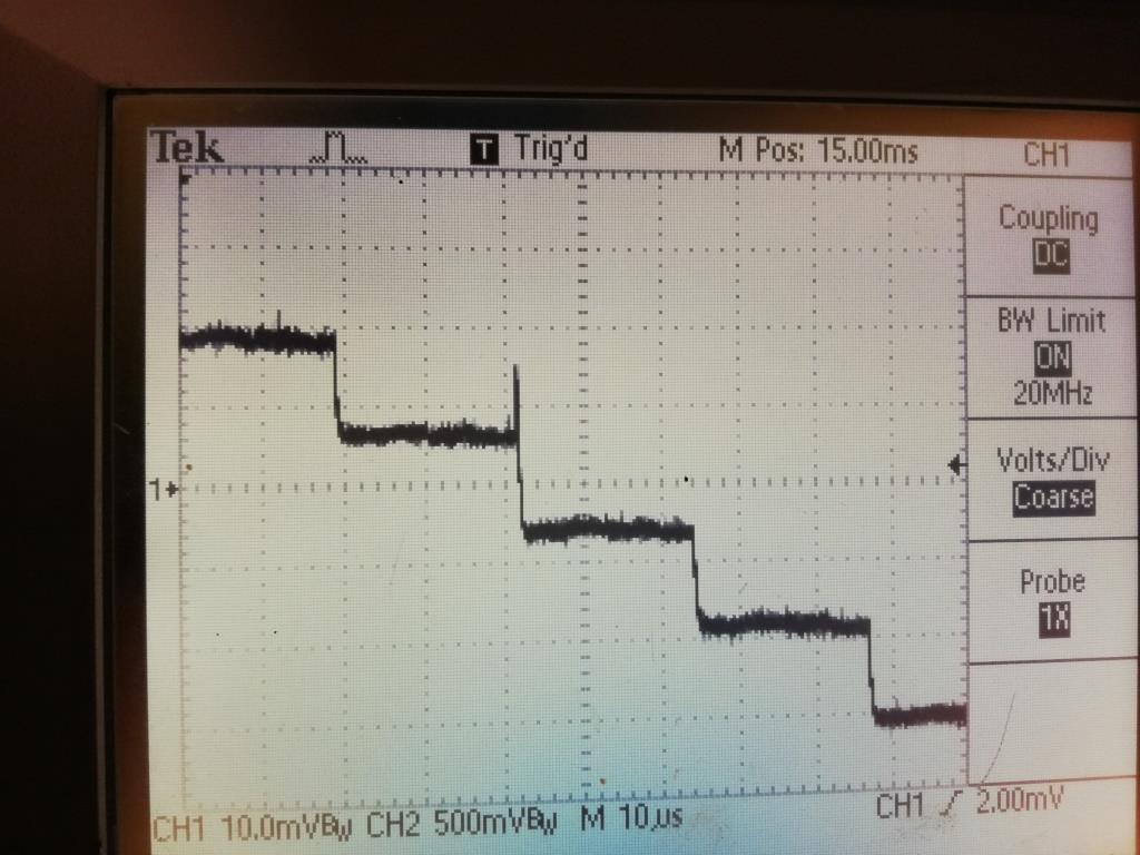

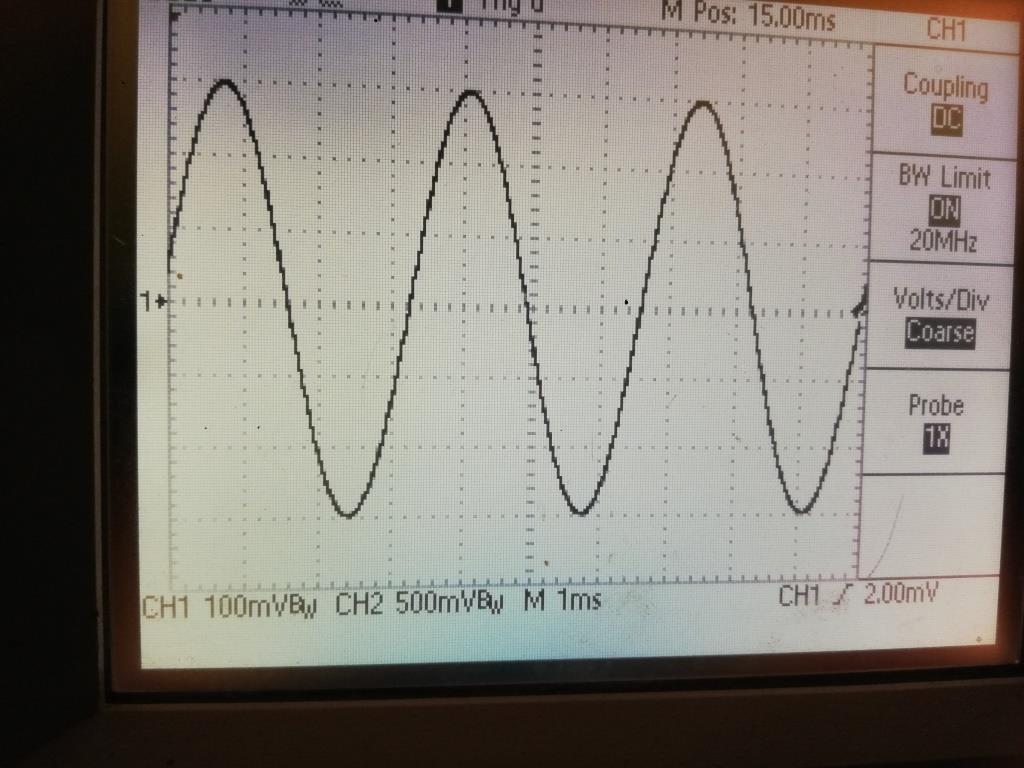

Forgot to mention that the data to the DAC- is inverted. And -no- you can not just swap the DOL+ and DOL- to get an inverted signal out. It makes no change. You must either invert all the data lines (DOR+, DOR- , DOL+ , DOL-) or invert the sampled MSB out of U4 and U5 and the feed that to a duplicate of the AND and OR gate complex U14 , U15 and U16 in order to get the same propagation delay for the inverted DAC's.
Attached: the second picture is a picture of a 5% full scale digital 300 Hz sinus from a TDA1541A running simultaneous mode with stopped clock.
The first is a closeup of that around the zero crossing. It is easy to see the big spike, when TDA1541A is changing all the bits at once. No spikes on any of the other transisions. Good reason to try Sign Magnitude :D

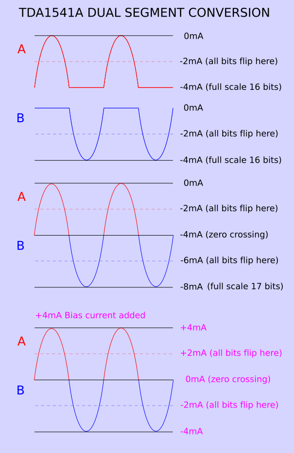

Hi koldby,
I attached a drawing that explains how both TDA1541A D/A converter segments are combined.
Segment A = TDA1541A #1 L channel (DOL+)
Segment B = TDA1541A #1 R channel (DOL-)
Same for the other stereo channel
Segment A = TDA1541A #2 L channel (DOR+)
Segment B = TDA1541A #2 R channel (DOR-)
All bits of each converter / segment flip @ -2mA, this is fixed inside the chip and cannot be changed externally. Using a single chip, all bits would flip at the critical zero crossing (-2mA).
Because the MSBs are now also included for low level signal generation we need extreme accuracy for these MSBs (this is one of the problems with multibit converters).
The audibility of bit errors is most noticeable at low signal levels (around the zero crossing area) where small bit errors will no longer be masked by much louder signals.
The segmented mode fixes this, all bits will no longer flip around the critical zero crossing but halfway between the zero crossing and signal maximum where the TDA1541A output current equals -2mA.
The MSBs are no longer needed for -dynamic- low level signal generation. The MSBs now only apply a static DC current. Bit errors in the MSBs only translate to very small DC-offset current in the zero crossing area (0 ... +1023 and 0 ... -1023).
Low level performance depends on the bit errors in the passive dividers (10 bits) only. When the bit errors in these 10 bit passive dividers are say 0.1 LSB then we get 0.1 LSB error in the range of -1023 ... +1023 while the total LSB error (MSBs included) could be say 1 LSB over the full scale as specified in the datasheet.
The circuit I posted will not produce a 1LSB error but only a fixed 0.5 LSB error around the zero crossing. The LSB of each segment (A or B) will now represent 0.5 LSB. Because of the coding scheme, one LSB of one segment (representing 0.5 LSB) is added, so we end up with 0.5 LSB error instead of 1 LSB error.
The error is a result of a double zero code around the zero crossing that results in a 1 LSB error if not corrected.
Single plain A TDA1541A will produce a similar 0.5 LSB error or even higher depending on chip grading, plus the bit switching noise plus the ripple current noise on the MSBs.
So even with comparable bit error, things will improve significantly because there is less switching noise and less ripple current around the signal zero crossing area.
But when we let the other (still unused) bit 16 of the other segment follow MSB of the I2S input stream, this error is fully compensated by adding another LSB (now total of 1 LSB is added). We now end up with a converter that offers improved low level performance and very low (switching) noise. This cannot be achieved using a single TDA1541A.

Thanks for that explanation, I too now understand ECD's approach. I will be closely examining the outputs from my balanced dac next week although I do not know how IanCanada's dsp chip generates the bit perfect inverted data.
Hi John
Thanks for clarifying that. Could you comment on my thoughts on using 4 TDA1541 in a balanced Sign Magnitude DAC. Is it ok to just use inverters on all the 4 datalines (DOL+, DOL- DOR+ DOR-) or should I use the approach with inverting the sampled MSB and build a copy of the AND- OR complex U14 , U15 and U16 ?
koldby, thanks for the clear explanation. It is not clear (at least for me) how the analog outputs of DAC+ and DAC- are combined, knowing that both has -2 mA to 0 mA output.
The TDA1541 produces -4mA to 0 mA. So if you combine two you get -8mA to 0 mA. Midt point (no data to either DAC) will result in -4 mA.
So only one of the DAC's change output if the data is anything else than zero's
DAC+ adds to the -4 mA when the MSB is 1 and DAC- subtract from the -4mA when MSB is 0. Providing a bias of +4 mA to the joint output of the two DAC's results in a output of +4mA to - 4mA. Look at Johns drawing.
