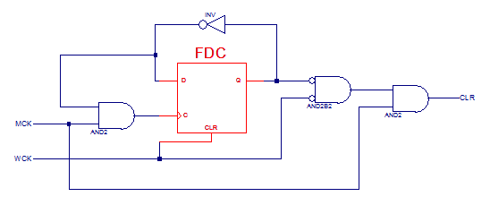

I came up with this neat circuit in case WCK has to be an input. It makes a pulse with the falling edge of WCK, the duration of which is half the MCK period (provided that WCK and MCK are in sync). Use it to reset a counter (or cascaded counters) with asynchronous clear. If you do it right then the counter will be in phase (Q7 will coincide with WCK if MCK is 256FS).It has only two inputs: MCK_IN (at 256FS) and DATA_IN. The rest are outputs
(BTW the 74HC74 has active low clear, unlike the Xilinx macro, adapt as needed).
-Alex

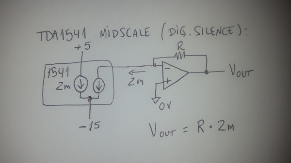

I can hardly see anything there (I'm on the phone and I cannot magnify it), but more than likely it is a biasing circuit with RC filter built-in. TDA1541(A) can only sink unipolar current from 0 mA to -4 mA. Such circuit injects a DC current of 2 mA resulting in a final bipolar swing of -2 mA to 2 mA, so no capacitors are required to remove the DC offsets normally introduced by the DAC itself.
Sorry!I still can't understand why do we needs to feed a DC bias into the analog output.
The input is +8V DC with series 2k2R 2k7R and shunt cap 10uF betwenthem
Hi
3lite said correctly that the midscale is not zero milliamps, it is 2mA. Without said circuit the output won´t be centered between the opamp supplies.
However, there is another thing to consider before using the circuit. Some opamps like the old 627 operate better when they are only outputting current. Folks used to put a resistor from output to V- and called it class A bias, others (Bruno Putzeys) explained that something else is happening (better supply rejection when using only one of the transistors of the class AB output stage. Only the NPN in the case of the 627).
So you may be better off without the circuit if your opamp is like the 627. Apparently it has worse +V PSRR, so the trick may apply to any opamp like this (worse +V PSRR).

No, it will work without the compensation. It might work better without it, depending on the opamp.
The opamp output will sit at 2V (positive); the opamp will be always sourcing current, never sinking. Can you see how this is similar to the old trick of resistor to V-?
