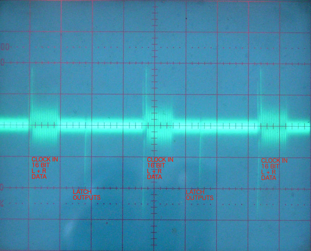

I attached an oscillogram showing TDA1541A (simultaneous interface) on-chip ground-bounce that leaks to its outputs. vertical setting 2mV/div, probe 1:1. BCK and data signals have 1K series resistor to slow down the edges, LE has 33R series resistor. Drive level of the digital interface signals equals 2V4pp.
We see ground-bounce during clocking in L + R data and one single bounce during output latching with the LE signal (using the TDA1541A in simultaneous mode).
We can clearly see that ground-bounce has reached zero when we issue the LE impulse that is highly critical for sample timing.
Average switching noise is reduced by 75% as we only have digital interface activity during 16 of the 64 bits in a frame.
Full scale output voltage equals 560mVpp, one LSB represents 8.5uV. The ground-bounce amplitude equals 2mV! see why it is important to reduce switching noise?
With say 5.65Vpp full scale output I measured roughly 20mVpp on the active I/V converter output. LSB now corresponds with 86uV.
We can't solve the on-chip ground-bounce, circuits have to switch and circuits have parasitic capacitances that need to be charged and discharged. This in turn pulls local ground up and pushes local ground down while the parasitic capacitance is being charged and discharged.

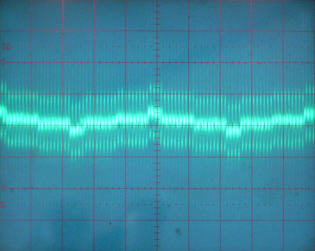

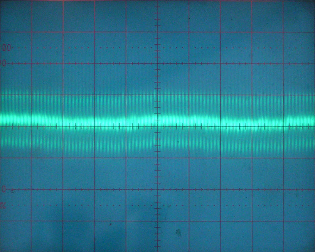

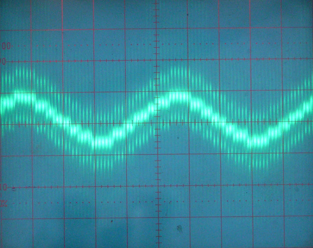

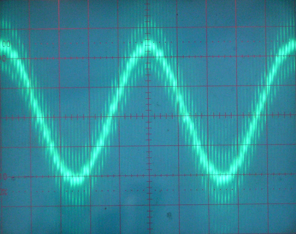

I attached oscillograms of low level measurements with the TDA1541A (plain A) in 17 bits (102dB range) segmented (signed magnitude) mode. This DAC runs on a 50Hz DEM with 100uF/25V decoupling caps. The slightest errors in the 6 MSB currents and low level performance is lost instantly.
Oscillogram 1, 1 KHz, -70dB (11.7 bit range).
Oscillogram 2, 1 KHz, -80dB (13.3 bit range).
Oscillogram 3, 1 KHz, -90dB (15 bit range).
Oscillogram 4, 1 KHz, -100dB (16.7 bit range).
So where exactly does DEM go wrong? I can resolve 17 bits using plain A chips, DEM cycle takes 80ms (80,000us) to complete while sample period time equals 22.6us (44.1 KHz NOS).
The biggest problem is digital interface related switching noise, it's all over the oscillograms.
With the "Aikido" drive method (segments driven with 0.5bit delay) I might possibly fix that too.

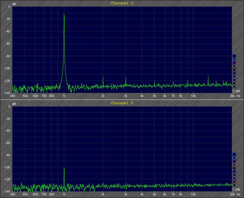

It seems to me that you confuse two things: the resolving power of conversion and the accuracy of conversion. If the DAC has responded to a weak signal, this does not mean that this response is accurate.
To estimate the accuracy of the conversion, it is necessary to watch the frequency spectrum of the output signal. On it we will see the products of distortions caused by the nonlinearity of the transformation.
The output spectrum makes it possible to give a comprehensive assessment of the quality of the conversion, taking into account various interference and distortions.
In order to understand what is meant, I give an example of the output spectrum from my DAC to TDA1541 (signal level -10 dB full scale).
Where are your spectra, John?
