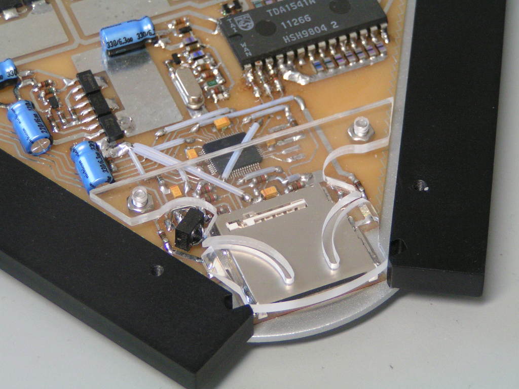

I use a DEM frequency of around 900 KHz now (2 * 6K8 plus a silvered mica SMD 100pF timing cap) and 14 * 330nF 1206 size SMD film caps for filtering.
I cut off the thin part of the TDA1541A pins and soldered the chip directly to the PCB. The film caps are soldered very close to the pins (few millimeters) and to the solid ground plane on the other side of the PCB (attached pictures).

Hi Oshifis,
This is a logical step: no oversampling - no analog filter - no DEM capacitors. Trying it is very easy...
You were right, I have corrected my mistake /tks to John/ and removed the 14 caps there - first impression is good ! So many diferent approaches here - I am getting confused - but you know the bad feeling havent trying all options:)
