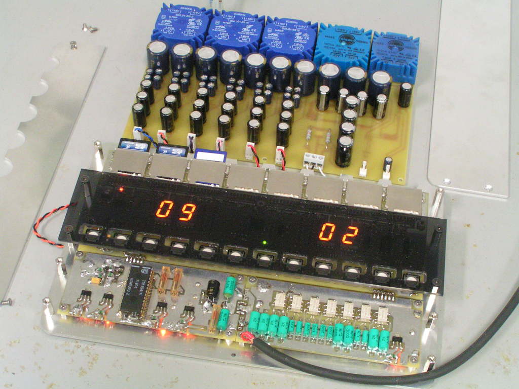

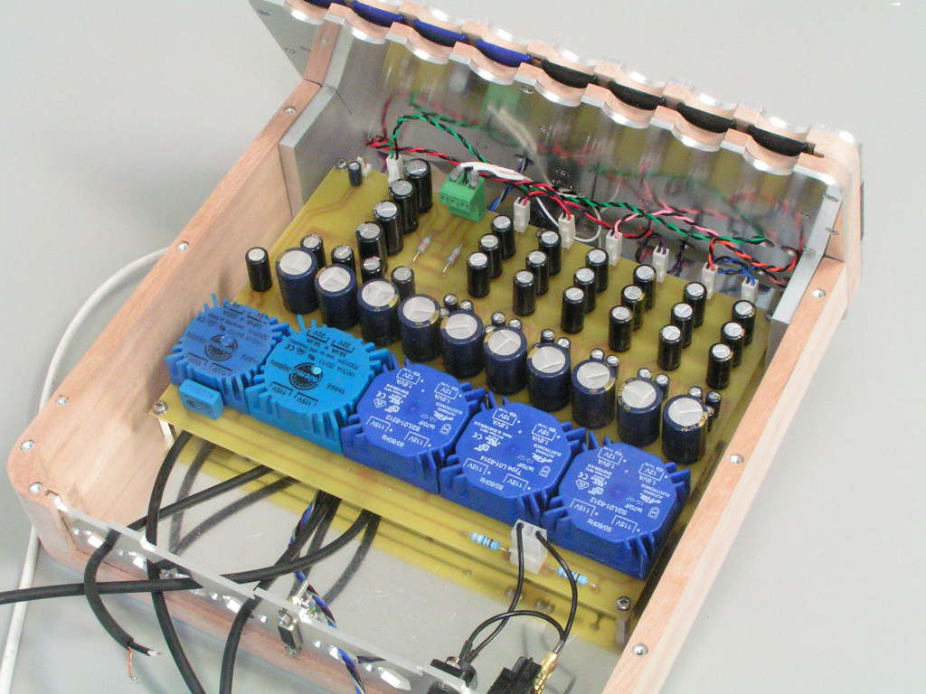

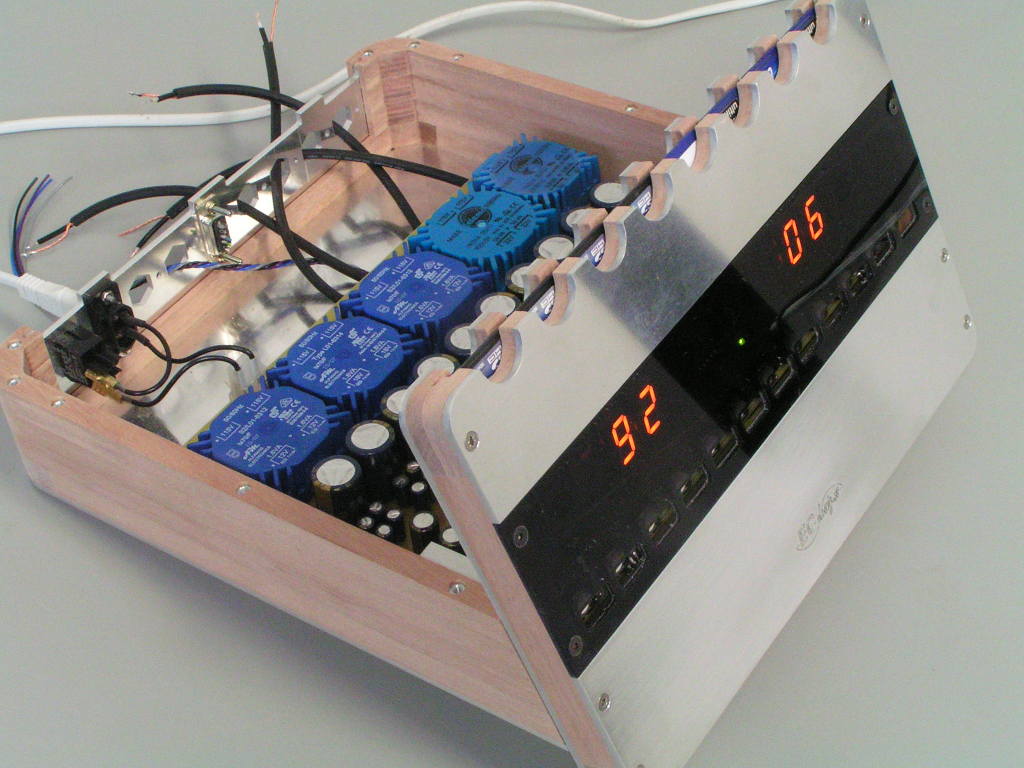

I added some pictures of SD8-project progress.

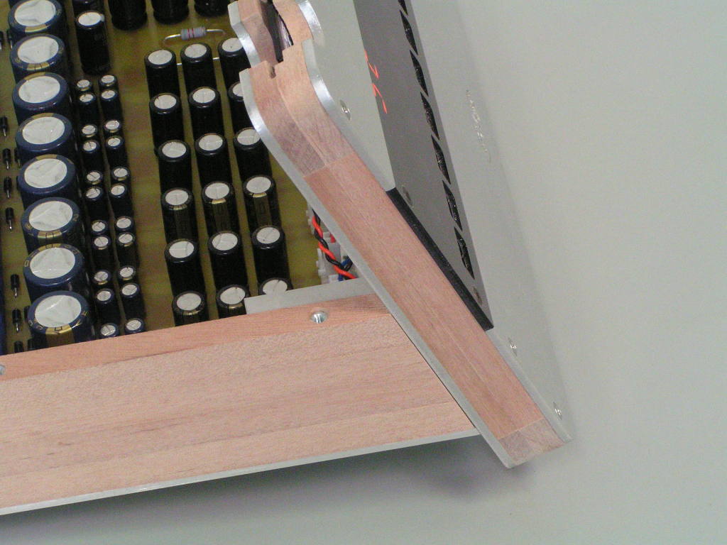

The power supply module is finally completed and I am now making the housing. The housing consists of CNC milled 3mm thick aluminium sheets and CNC milled wooden parts that are fixated on hexagonal spacers. The front panel housing consists of eight pieces of wood, the base of 9 pieces of wood. After fixating the wooden segments are sanded for over an hour to get a smooth finish.
I still have to make the front panel keys, top plate and insulator plate for the RCA sockets.
I added ventilation slots in the housing that provide convection cooling. The TDA1541A chip is cooled through the aluminium front panel and can remain powered-on.

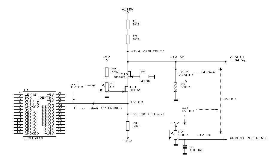

The SD8-player has latest TDA1541A-MK14 DAC installed. This DAC has 44.1 KHz synchronised DEM clock and a new I/V converter.
The I/V converter is built around a RF JFET cascode current buffer that places a low impedance on the TDA1541A output. Two passive current sources are added to provide 2.6mA negative bias current and 7mA positive bias current.
I tested many conventional CCS circuits and none of these were able to offer natural and transparent sound quality. The best sounding conventional CCS circuits were the simplest one's (one JFET or one transistor with LED reference). The more complex the CCS circuit, the worse the resulting perceived sound quality. The problem could be non-linear impedance and / or feedback loop delays. Passive CCS has no feedback loops, only a power supply and a single resistor.
The positive bias current is obtained by a 115V DC supply with 16K4 series resistor. The 500R passive I/V resistor is connected to cascode current buffer output / positive bias current and GND. Output voltage is now 2Vpp but can be increased by increasing passive I/V resistor value. 2K2 I/V resistor would give 8.8Vpp for example.
The power supply module provides a number of isolated, very clean currents for the local discrete shunt regulators. Each supply now consists of a transformer with pre-post filtering, 4th order capacitance multiplier followed by 3rd or 4th order balanced RC filters / current limiters. There is a separate switchable 5V supply for remote ON / OFF (mono blocks).

Hi John, nice work.
I'm pretty curious to understand more about your new CCS, and your IV stage. Whats it input impedance of the IV stage? What voltage have you now got on the analog output of the DAC? How thermally stable is the CCS? Whats the benefit of having the CCS running off 115VDC?
I would love to see some schematics if i may.

Hi ryanj,
BF862 has yfs of 45 (typical) and Ft of 715 MHz. So we have both, high gain and high limiting frequency. That's why I chose this specific JFET for this application.
The input impedance of a grounded-gate circuit equals approx. 1 / gm. So current buffer input impedance equals approx. 1 / 0.045 = 22 Ohms. With 4mA full-scale current, max. ac voltage amplitude on TDA1541A current output equals 0.004 * 22 = 88mV or +/- 44mV.
1.94Vpp with 500R passive I/V resistor and PCS impedance of 16,400 Ohms.
It is actually a Passive Current Source based on a stabilised voltage and a series resistor. Thermal drift is very low (combination of both, power supply and resistor thermal drift). Thermal drift is much lower compared to a CCS.
The higher the series resistor value (impedance) the more the PCS resembles an ideal CCS.
The problem is that when using relatively low voltage and relatively high series resistor value, the target current may not be obtained (too low). By increasing the supply voltage target current can be obtained and impedance can be increased.
Example:
3mA target current, 20V supply and 1V DC across the load would require 19 / 0.003 = 6K333 resistor. So the PCS impedance would now be 6K333.
3mA target current, 200V supply and 1V DC across the load would require 199 / 0.003 = 66K333. Now the PCS impedance is raised to 66K333 while maintaining target output current of 3mA.
Advantages of a PCS:
- Constant impedance over very large frequency range (use of RF resistors extends range).
- Instant response, no feedback loops, no delays.
- Very low distortion.
- Very low thermal drift.
- Very low noise.
I attached MK14 I/V circuit schematics.
T10 and T11 form a cascode current buffer. P1 sets DC voltage at DAC output at 0V DC. Bandwidth approximates JFET Ft (715 MHz).
R4 sets negative bias current of -15 / 5600 = -2.7mA. PCS impedance equals 5600 Ohms and is in parallel with 22 Ohm cascode current buffer input impedance.
R1 and R2 set positive supply current of +7mA, PCS impedance equals 16,400 Ohms and is in parallel with 500 Ohm passive I/V resistor so actual I/V resistor value is reduced to 485 Ohms.
The cascode current buffer output current is fed to the 500 Ohm passive I/V resistor that connects to GND.
Current / voltage swing:
DAC output current = 0mA (minimum current), I/V resistor current equals +7mA - 2.7mA = +4.3mA, voltage across I/V resistor equals +2.0855V
DAC output current = 2mA (bias current - no signal), I/V resistor current equals +7mA - 2mA - 2.7mA = +2.3mA, voltage across I/V resistor equals +1.1155V
DAC output current = 4mA (full-scale), I/V resistor current equals +7mA - 4mA - 2.7mA = +0.3mA, voltage across I/V resistor equals +0.1455V
The +115V supply now enables higher output amplitude.
Example:
10K passive I/V resistor. DC voltage (2mA bias) equals 20V. PCS series resistor equals (115-20) / 0.007 =13K57. This resistor is in parallel with 10K so I/V resistor value drops to 5.76K
Output amplitude now equals 0.004 * 5760 = 23.4Vpp.
This opens the possibility of using a unity gain bridge buffer (Circlotron) instead of a conventional amplifier to drive the speakers. With 23Vpp on each bridge half we would get approx. 16V rms. This would give approx. 32 watts rms in 8 Ohms.
When using 2 x TDA1541A (phase / anti-phase outputs) it would only take two power MOSFETs and a power supply to drive the speaker.

Hi ryanj,
Thanks for the detailed reply and posting your IV schematics.
Sorry, what i meant when i asked what the voltage is on the output of the DAC, i meant; What is the measured DC Voltage on pin 6 , and 25 of the TDA1541A, and how stable is this DC offset? Are you getting better than +-5mV in various temperatures?
Also, are you finding that what impedance the TDA1541A sees on its output (pin 6, 25) is clearly better (in terms of measured performance and listening test) when lower?
At one point you were finding that having -40 ...-48mV DC on the AOL, AOR pins measured better on your distortion meter, what are your latest findings with your current setup? Do you have any other measurements you could share?
Thanks again for sharing your work John.
Regards, Ryan

Hi ryanj,
The DC voltage on the DAC output can be adjusted so the ac signal swings symetrically around 0V DC. Depending on the circuit this requires a specific DC offset. The stability of the resulting DC voltage on the TDA1541A mainly depends on accuracy of the power supplies (-15V, +5V, and +115V).
With passive I/V resistor connected between TDA1541A output and ground, the output signal is in parallel with the DAC output. So when the DAC output clips (diode transistor bit switch properties) the output signal clips. By using an external +2mA bias current the tolerable ac signal amplitude on the TDA1541A can be doubled.
When clipping occurs it results in non-linear distortion of the ac signal on the TDA1541A output. This leads to inter-modulation distortion.
With a cascode current buffer, the I/V resistor connects to the cascode current buffer output. Here, large ac signal swings are no problem. The cascode current buffer "isolates" The I/V resistor from the TDA1541A output by presenting a low impedance to the TDA1541A output and a high impedance to the passive I/V resistor.
Since there will always be an ac voltage present at the TDA1541A output, It is best to tune DC offset for symmetrical ac voltage swing (output compliance -25mV and +25mV or 50mVpp). The DC offset on the TDA1541A output depends on the application.
