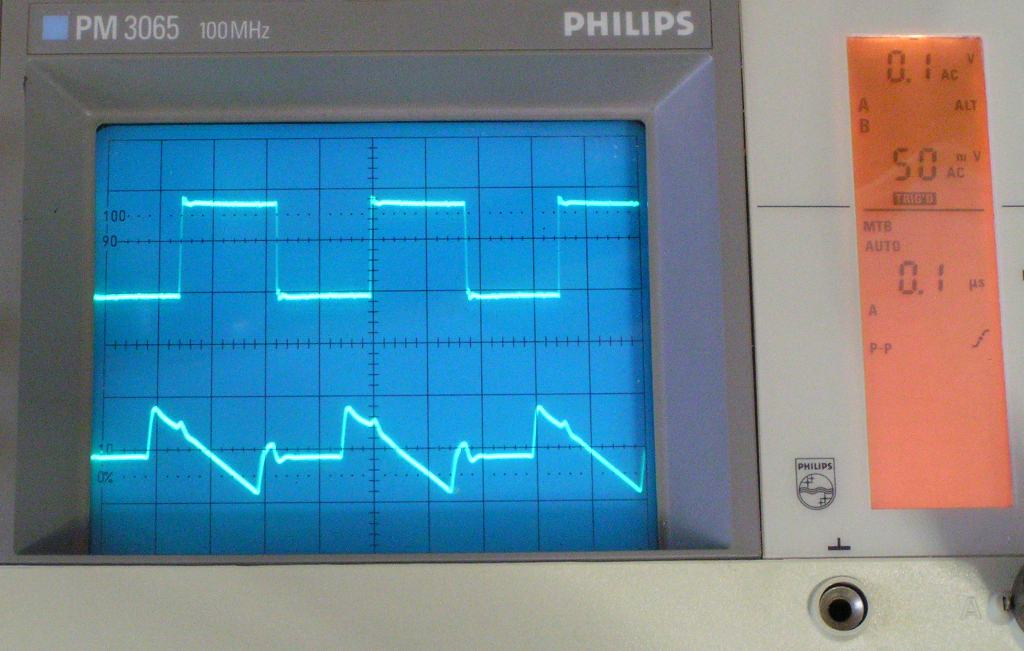

Well have a look here....
Upper trace: pin16 (dem)
Lower trace: pin bck
Doesnt look good.... Does it?

Did another attempt with 33pf 'free running'. This is the picture on my 50mhz scope....
Top is bck @ 2.8mhz
Bottom is dem osc (33pf)
Still doesnt look like a normal multivibrator...
Top is bck @ 2.8mhz

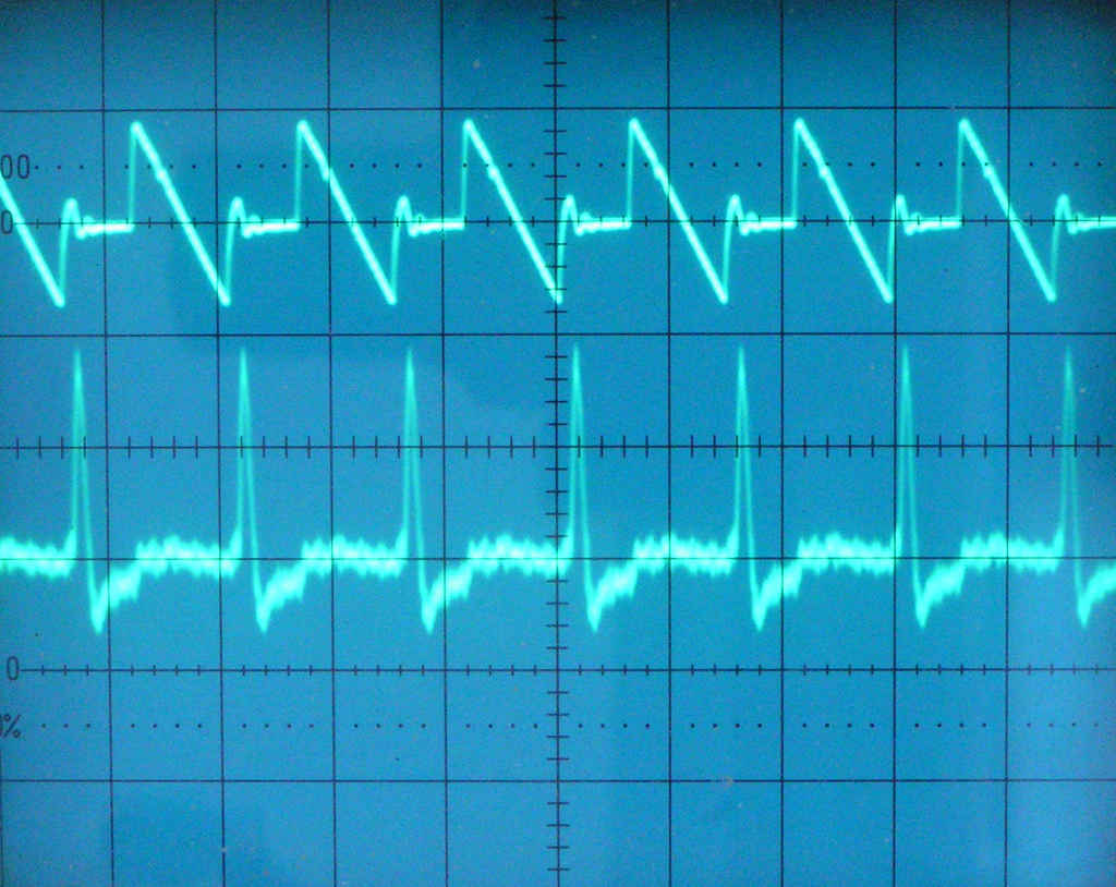

I attached an oscillogram of a DEM clock running at 2.8224 Mhz. The upper trace shows the DEM oscillator output (33pF synced with BCK). The lower trace shows the signal on one active divider output (filter cap removed). The switching pulse takes up around 40% of the total "switch closed" time and will now have significant impact on the value of the averaged active divider output current.
The second oscillogram shows DEM clock running at 44.1 KHz. The upper trace shows the DEM oscillator output (1.82nF synced with WS). The lower trace shows the signal on one active divider output (filter cap removed). The switching pulse is barely visible and only takes up a very small fraction of the total "switch closed" time and will now have very little impact on the value of the averaged active divider output current.
Similar happens with the TDA1541A output signal. The higher the sample rate, the larger the impact of stray capacitance and settling time on the sample.
