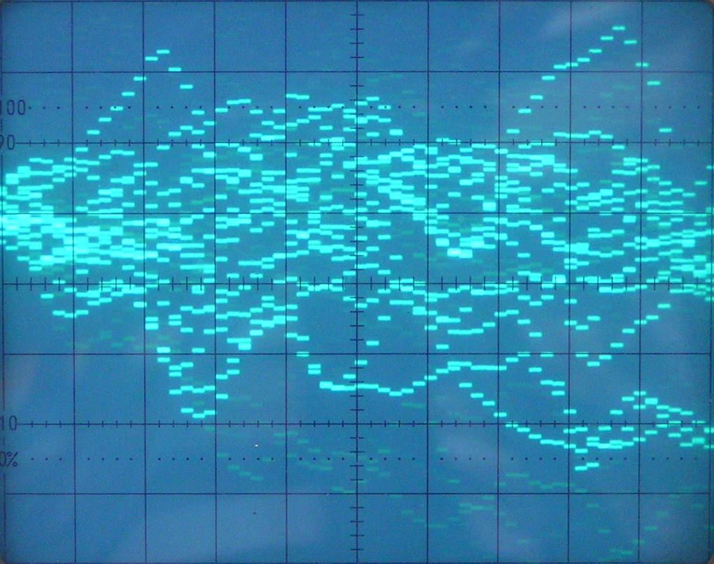

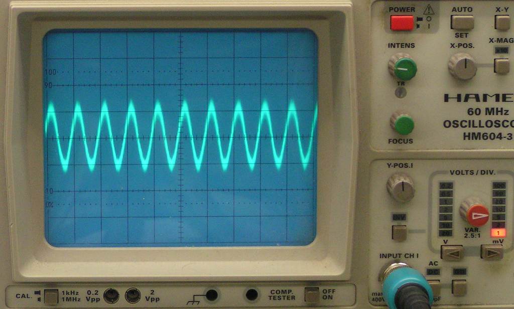

I measured a 1 KHz -60dB signal at the DAC output (NOS, no filtering). This is the "end result" note that it also contains interference due to a created ground loop as both SD-player and scope were mains powered and EMI.
The vertical setting equals 1mV / div (probe set to 1:1) so at -60dB I get approx. 2mVpp out of my SD-player. Full output (0dB) equals 2Vpp, so signal amplitude is approx. 1000 times lower. This means that the measured -60dB sine wave consists of approx. 65536 / 1000 = 65 steps or 6 bits.
I also added measurement of music reproduced by the SD-player. The signal transients between samples are almost invisible as jitter levels at the DAC output are extremely low (<40ps rms) and bandwidth is larger than 30 MHz. This in turn is required for accurately reproducing sample pulse energy and achieving high dynamic resolution.
The actual "smoothing" of the signal is done at the speakers (passive crossover filters and speaker mechanical properties) at the end of the signal path. This prevents divergence.
The connected audio equipment (volume control, power amp and speaker passive crossovers) are designed to remain stable over this large bandwidth.

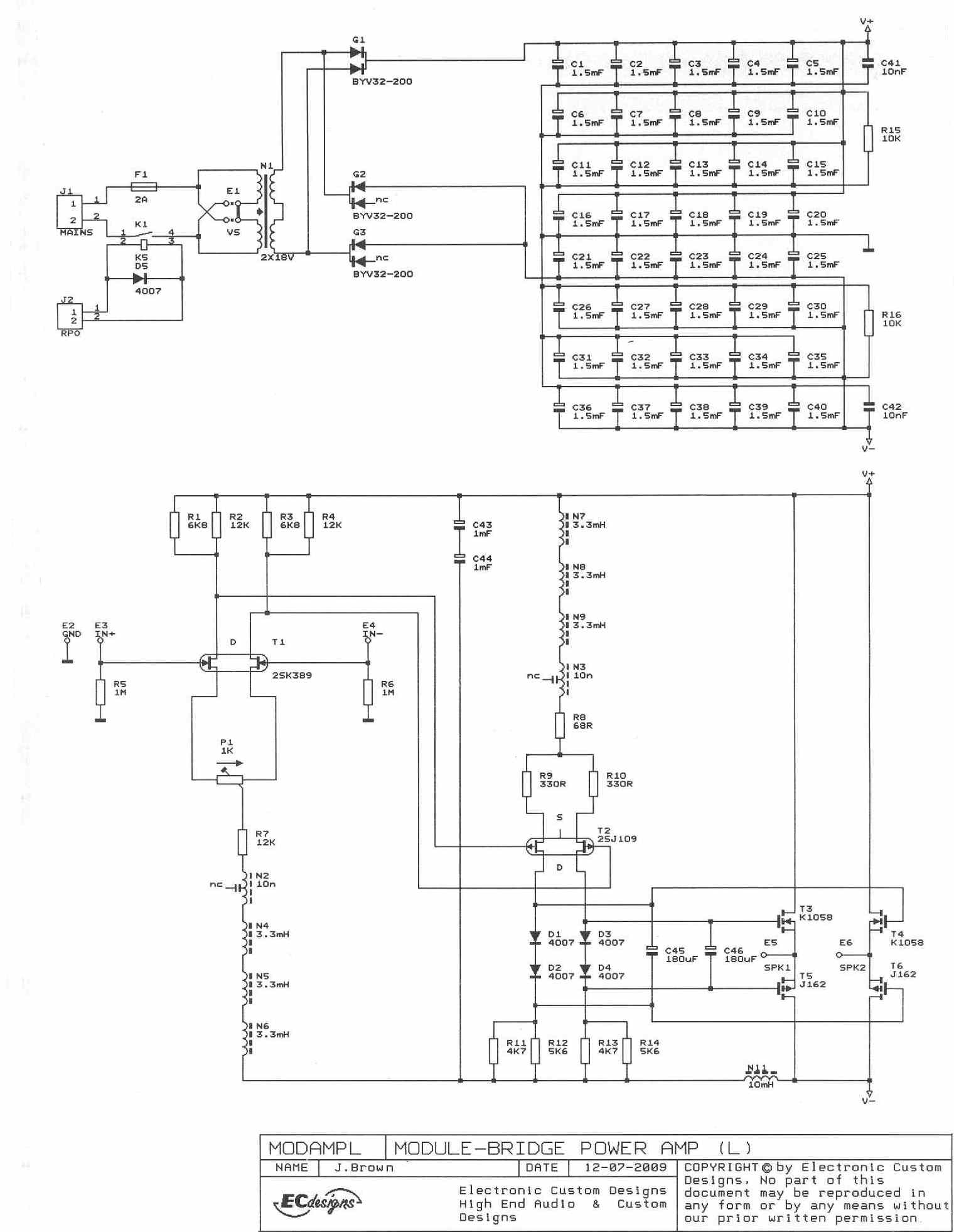

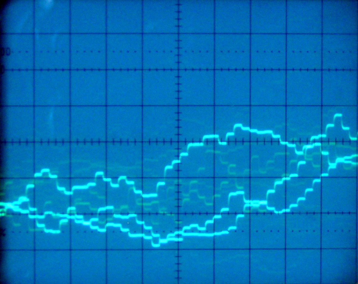

My objective is to keep the signal path as simple and straight-forward as possible.
Let's follow the signal in the ISD player.
DAC current output passes a single JFET current buffer and runs through the 500R passive I/V resistor into +5V. By doing so, all bit currents flow into +5V.
The voltage across the 500R passive I/V resistor is buffered by a discrete JFET unity gain buffer. The output at the buffer has large bandwidth (oscillograms posted earlier).
Next a hybrid coupling cap with DC compensation circuit is used to put the coupling cap in a "sweet spot" where distortion is lowest. This signal then enters a frequency compensated 10K motorized ALPS pot (low noise conductive plastic film).
Signal is then fed into a balanced FET bridge power amp that remains stable up to at least 10 Mhz. I added a concept schematic of this power amp.
Interlinks are made using RF litz wire.
The bridge power amp is connected to the speakers using RF litz wire (8mm diameter). I added an oscillogram of the power amp output signal.
The sonic resonator passive filters are designed to handle large bandwidth input signals. There are 4 main filter parts, two multi-segmented honeycomb air chokes and two hybrid caps that have an extra PCB bypass cap. Two speakers, a bass-mid chassis and a tweeter are driven by this passive filter.
The signal on the woofer looks analogue when measuring it with the scope. This is caused by the passive xover filter. In other words, no visible steps, just a smooth signal.
The signal on the tweeter has step shape, but the tweeter starts to roll-off at approx. 25 KHz, removing RF energy by speaker mechanical limitations (RF converted to heat / losses).
Finally the human auditory system performs required brickwall filtering on a signal that's already band limited to approx. 30 KHz by the tweeter.
This method places the filtering at the end of the signal path instead of after the DAC chip. It uses given speaker properties that already provide band limiting starting at approx. 25 KHz.
The resolution in time domain in your oszillogram is very small, if it was higher, one could easily see the settling time of the DAC. Where do you expect to see jitter in such an ultra low resolution measurement, how many samples on the scope screen, I did not count them ?
But that is not the point, just a notice.
Still the same very low resolution in the oscillogram, but now one can easily notice settling time.
It seems you have unintentionally created a situation where the power amp acts as substitute of what is usually found in DACs: the active I/V stage which badly affects settling time of the DAC, be there NFB or not.
Look at your pictures, obviously the power amp can not follow the short rise time of the DAC chip.
