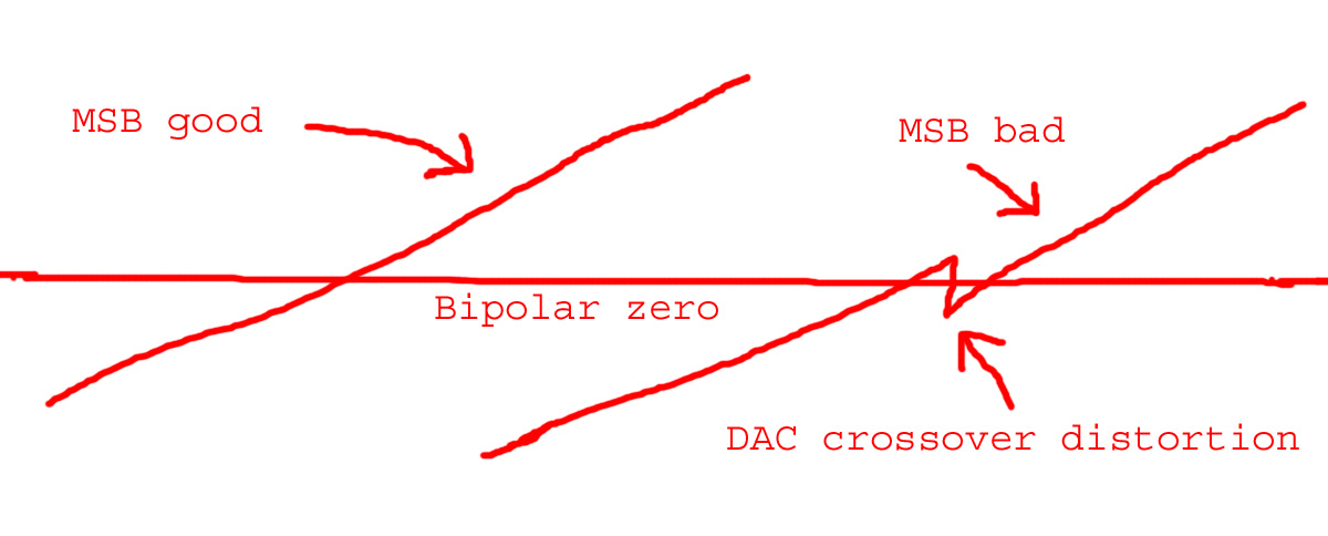

See it like this:
Not all tones of all instruments and not all voices have lots of harmonics, some are more like pure sines, especially in silent passages.
When your 1543 plays music, during the silent passages the pure sounds are smeared by added harmonics.
So the silent pure sounds are missing, the DAC fails to reproduce them correctly because of the added distortion.
No tricks of implementation will cure it.
The MSB error adds a step at the zero crossing of the signal.
It sounds like a classB amp with very little idle current.
The crossover distortion is always there but it is more or less masked during loud passages because the amplitude of the error is small in relation to the signal.
However, it becomes more and more noticeable on lower levels.
Ignore it if you want ;)

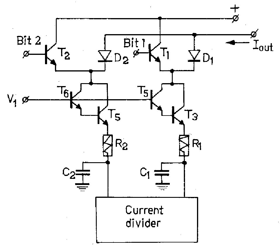

In order to achieve maximum performance one has to know exactly how the TDA1541A on-chip output circuit functions.
I attached TDA1541A on-chip output circuit. The diodes that are part of the bit switches that determine output compliance. The AC signal has to stay below 0.6V in order to prevent clipping of the output signal (ac voltage exceeds on-chip diode forward voltage).
I tried many external (I/V) circuits, and the best is still passive I/V conversion, no OP-amps no fancy diamond stages, just a plain resistor.
problem with TDA1541A however is that output compliance requires use of active circuits.
When looking at the on-chip schematics, one notices a Darlington at the output of each active divider (T3 ... T6). These are driven by the active current divider, followed by an RC filter (R1, R2, C1, C2). C1 and C2 are two of the external active divider decoupling caps. R1 and R2 are integrated. This schematic only shows two bits, in The TDA1541A 12 of these circuits are used (2 x 6 MSB for L / R channels).
The remaining 10 bits for L and R are derived using passive current dividers (emitter scaling) so these binary weighted currents aren't dynamically corrected.
The Darlington transistors connect to the output through diodes (D1 and D2). The binary weighted currents can be re-routed by T1 and T2. When T1 for example is switched-off (bit = 1), the current of that divider flows from the output, through the diode, into the current divider. When the transistor conducts, the divider current runs from +5V into the divider, so it won't be added to the total DAC output current.
TDA1541A +5V needs to have very good decoupling in order to prevent ripple voltage due to varying current flowing into the dividers when these are re-routed to the +5V.
Back to the TDA1541A I/V output stage, I figured, what if the external (active) circuit matches on-chip properties, then it would introduce similar THD "finger print" as the on-chip circuit. Thus no other THD spectrum would be added that would further clog-up the spectrum.
So that's what I did, I simply duplicated the TDA1541A internal Darlington and connected emitter to the DAC output (cathodes of internal diodes), basis was connected to 1.2V reference voltage in order to maintain approx. 0V DC at the DAC output.
next I simply connected a 700 Ohm passive I/V resistor between +5V and Darlington output. Works like a charm, 2.8Vpp output signal, clean sound. Problem however is that the connected power amp is referenced to GND while the I/V resistor is referenced at +5V. This means that when power supply impedance is not very close to zero, interference will be added to the output signal.
Here is where the PCB bypass / decoupling cap comes in handy. These forms a very low impedance, much lower than a black gate, ceramic or foil cap. In fact the effect on sound quality was clearly audible. These PCB bypass caps turn out to be superb for power supply decoupling as well.
Other irritating problem with the TDA1541A is the DEM clock that drives the DEM logic and determines bit errors. When this circuit doesn't work perfectly, bit errors / DLE errors will occur immediately. The DEM oscillator frequency also inter-modulates with I2S signals BCK, DATA and WS (on-chip crosstalk). This is not desirable and leads to smeared sound.
Well I have come up with a very simple and effective circuit. One resistor (exactly 13K) connected between TDA1541A pin 16 (pin 17 is not connected) and the existing DJA circuit, thus injecting 1.4112 MHz DEM clock that has same extreme low jitter as BCK timing signal. At this very high DEM clock rate, the 100nF decoupling caps become more effective (same cap and internal resistor value, higher frequency).
I also figured out a way to create high performance decoupling caps for the active dividers. Simply add a small piece of flexible 0.05mm thick PCB material as bypass (approx. 1 x 1 cm piece). The RF / HF interference drops to lowest levels I measured so far. These pieces of flexible PCB material (that are bit thicker than 0.05mm) can be placed between the small 100nF caps.
