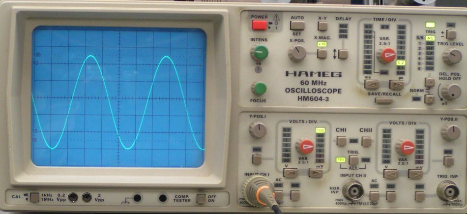

The oscillator runs on 5V (approx. 10mA), the 1.5V is used as reference voltage to bias the JFETs in the master clock.
The oscillator is basically a buffer with a phase shifter and a crystal filter in the feedback loop. This results in a pure, very low distortion 5Vpp sine wave at the amplifier input.
I already constructed a prototype with 8 crystals in the feedback loop (very difficult to tune), I now use simpler versions with 2 or 3 crystals that are less critical and more easy to build.
I picked the signal from the JFET input, using a second Buffer circuit.
I attached an oscillogram of a 2-crystal version running on a dirty 5V power supply and using a 1.5V alkaline reference voltage. I included the scope in the picture to verify settings. I used a 1:10 probe, and time base X10 setting. Frequency equals 11.2896 MHz.
The sine wave can be used to trigger a suitable high-speed comparator with high input impedance and low input capacity. but amplitude is also high enough to directly trigger connected loads (after unity gain buffering).

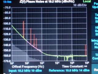

Thanks for the answer.
If you are interested I can help you to measure the Phase Noise of the master clock/Buffer, I have access to a Symmetricon 5021A Phase noise test set, In such way you can fully characterize the jitter of your master clock.
Attached some screen pictures:
