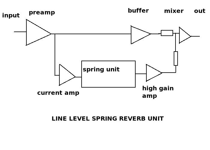

a "line level" reverb tank should have the driver and preamp circuits included. the reverb tanks in previous posts are the basic spring units themselves with no drivers/preamps, just the metal box with springs and magnetics.
just running the outputs of the soundcard into a spring unit won't work well, as there's a huge amount of loss in the transducers and springs.
usually with a spring unit, you have a preamp and spring driver. at the input to the spring driver, the audio path splits int two paths "dry" (original signal) and "wet" (the reverb signal). the "dry" signal then goes directly to the output mixer/buffer. the "wet" signal is amplified to get the required drive current to the spring's input transducer. the transducer is like a small electromagnet that drives the steel spring with audio. the steel spring vibrates mechanically and acts as a delay line. that's why there are more than one spring with different coil pitches, one spring has more delay than the one next to it so the echoes from each spring arrive at different times. also, being springs, the signal echoes back and forth many times along the springs. at the output end, a second transducer magnetically picks up the vibration of the springs and turns it back into an audio signal, which is amplified by a high gain preamp stage and fed into the mixer/buffer to be mixed with the "dry" signal.

i wouldn't try to drive one of the 8 ohm coils with more than a few hundred milliwatts, but at the output end of the spring, there's about a 30db loss from the input (if not a whole lot more) that has to be made up for to come close to matching the input signal if it's to be usable as reverb. that's why the high gain amp at the output of the spring. the signal path inside the reverb unit looks something like this:

See I doubt I can make one cleaner than what I already have with my pre-amps.
