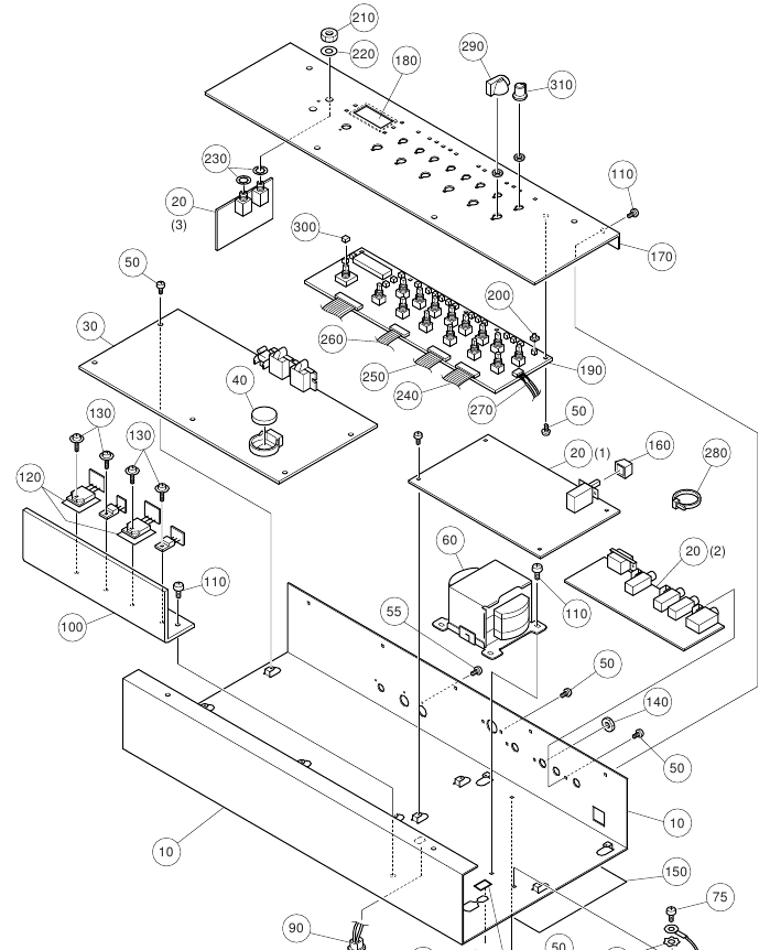

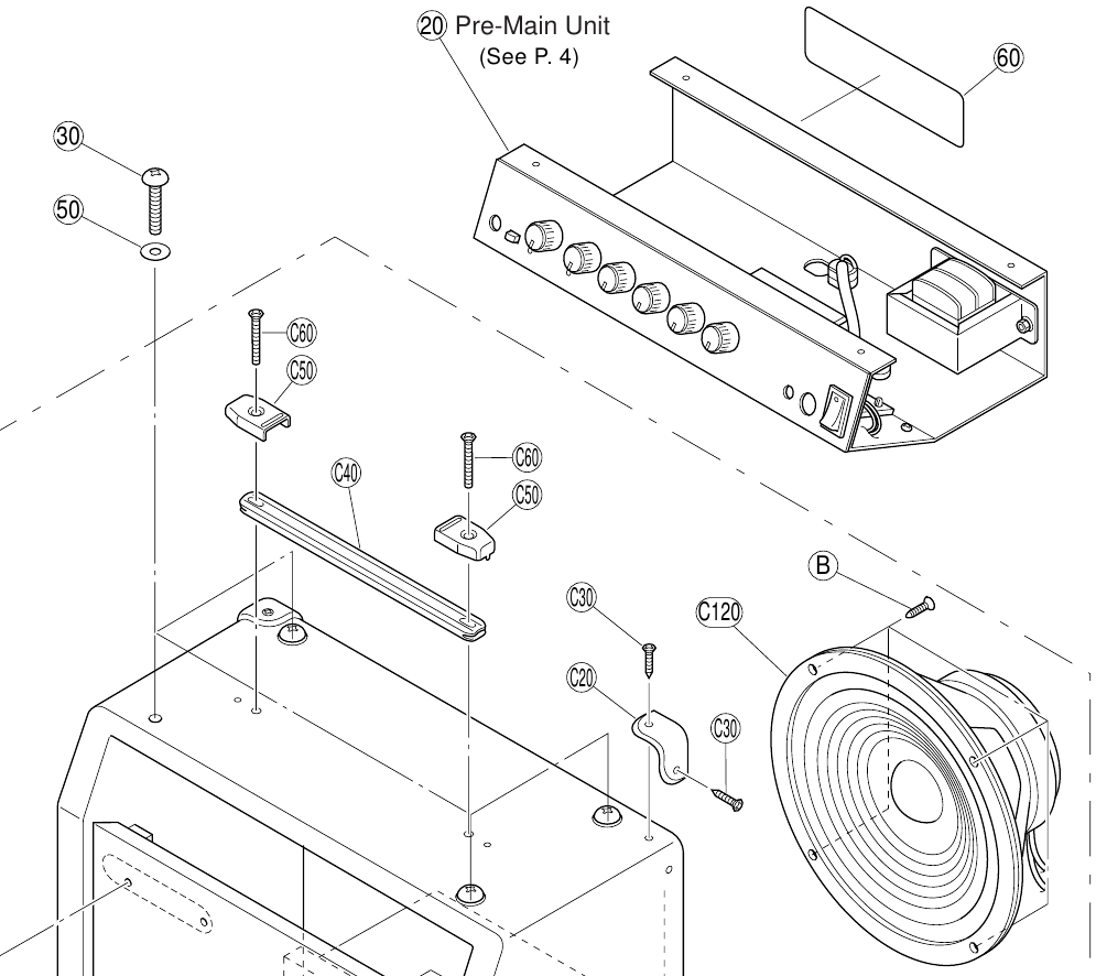

These two drawings show how it is done in a commercial amp. It is only a 25W unit using a chip amp, though. The entire chassis acts as heatsink. The top part is open to the wood. It is practises like these that lead to the posting of this thread. Just how much heat is OK and how far away from the wood the heat generating components are mounted seems to be a matter that is left to the designer/builder's knowledge and experience.

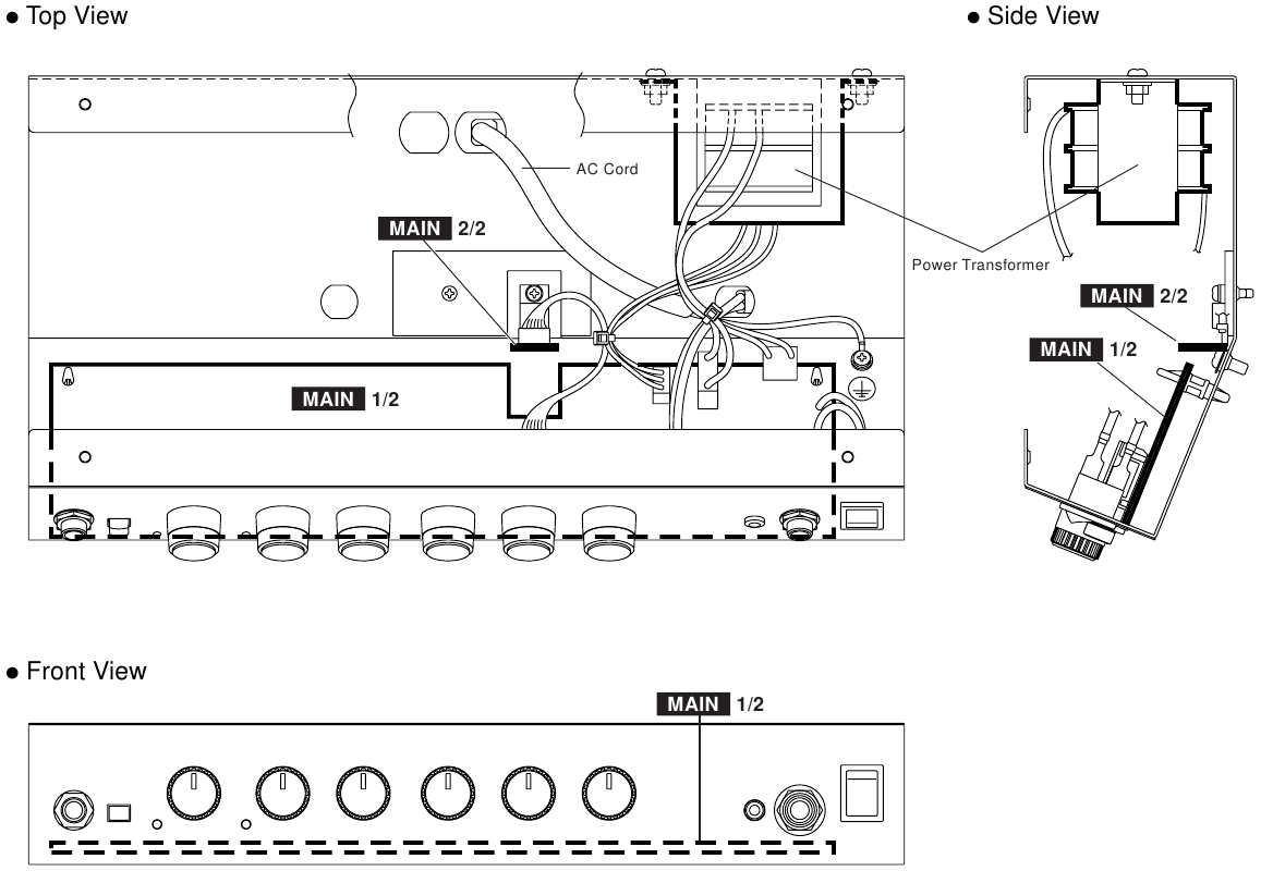

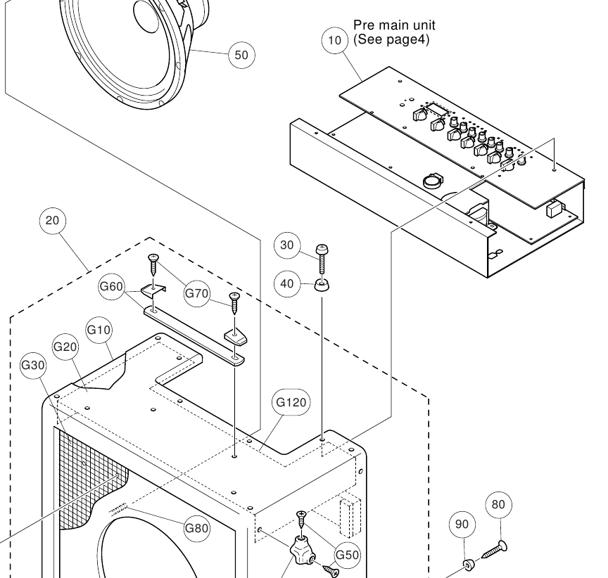

Here are two more drawings I have found. This one is from screen 17 of a Google search for "guitar amplifier service manual filetypeDF" BTW. These things are not easy to come by.
It is a 60W amp with sophisticated digital processing, therefore it has a lot of circuit boards. There is a heatsink, but once again the top is left open.
