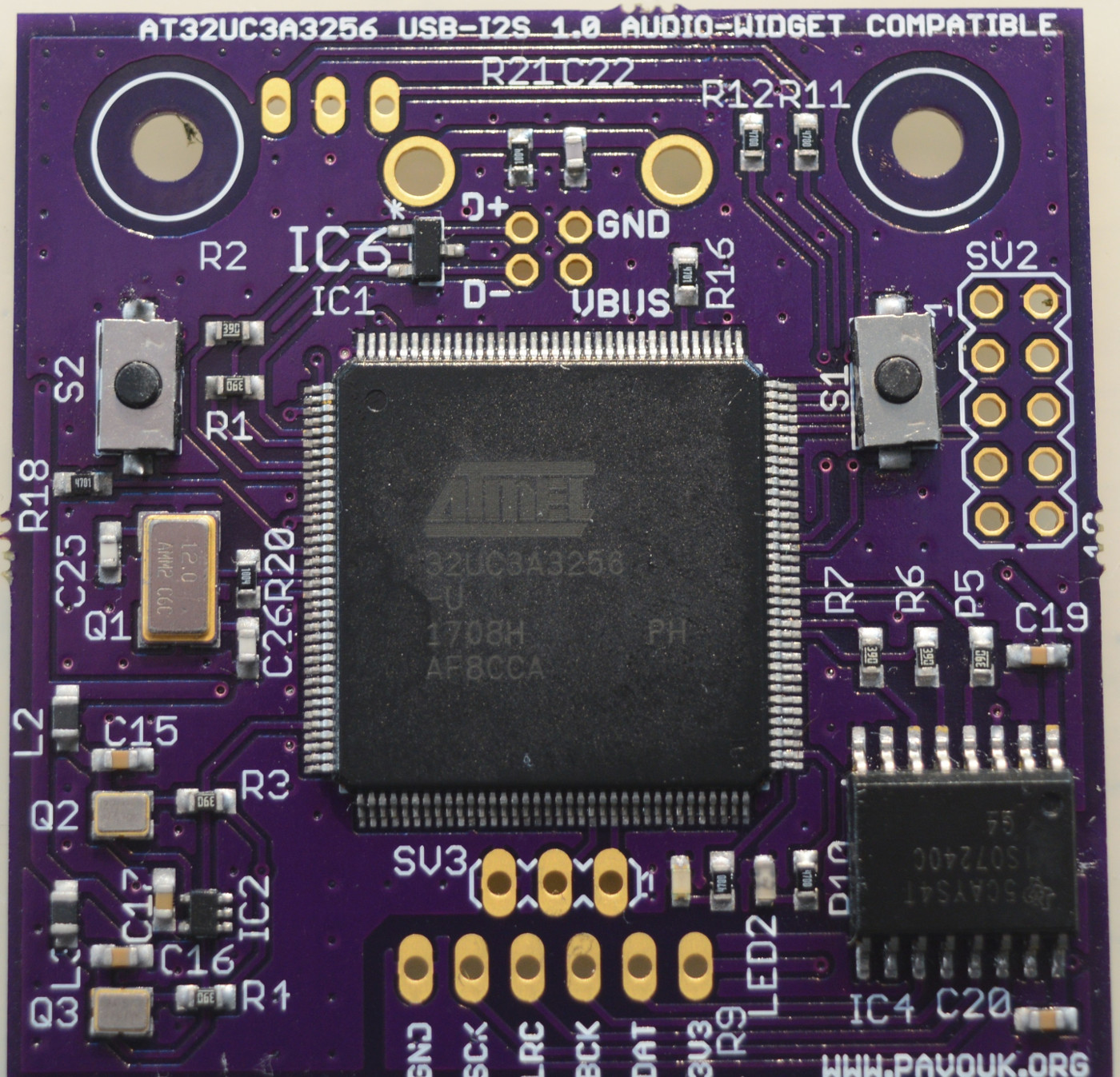

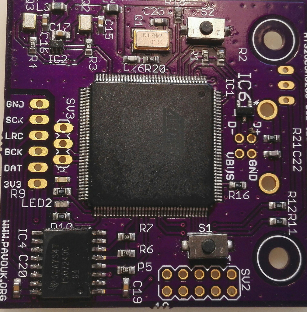

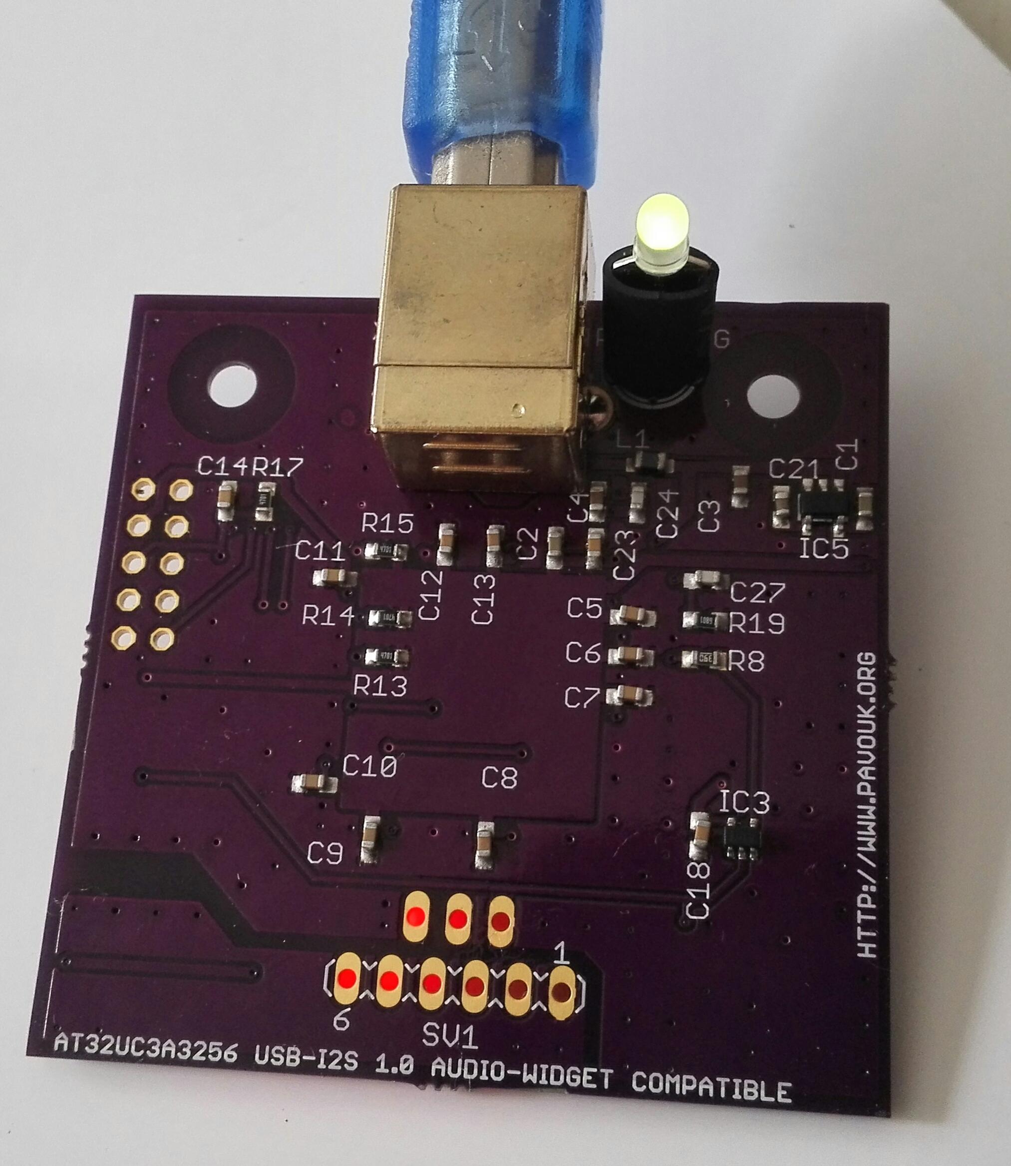

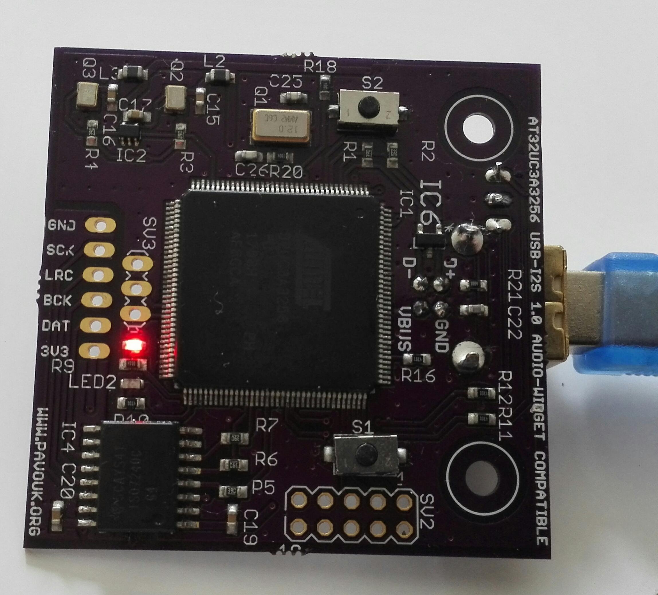

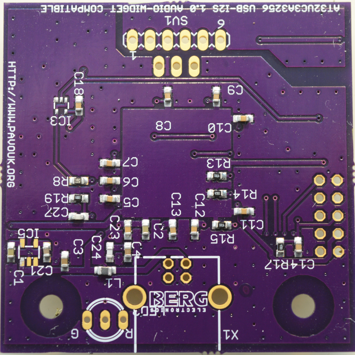

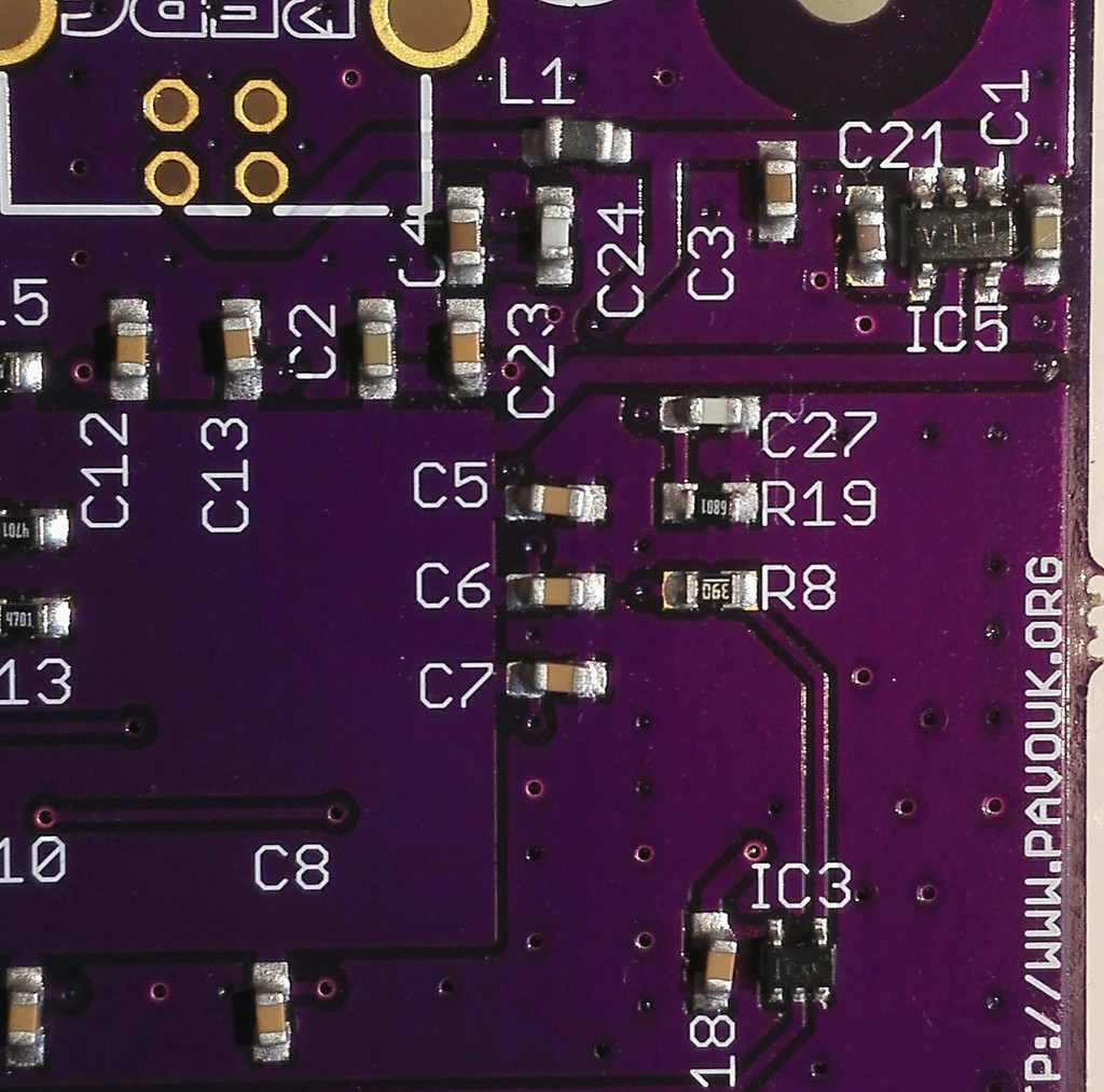

Only the missing parts left to populate on the first board now:
USB-connector 74LVC1G80 and the LP2992AIM5-3.3.
The 2 color LED I'll populate just before the USB-connector.
Well done, Mayday!
Thank you, that's kind of you to say
