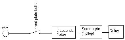

I want a nice frontplate, so I want a nice switch on it. The only nice thing I can find is a button. I want to turn the amp on by pressing the button for 2 seconds. Than the main relays switch on. Does anybody has a schematic for this 2 second delay? I want a 5V TTL signal.

Leave a bit more space for auxilliary boards such as turn on delay. You will probably find it hard to find a nice front pannel switch that can also handle the current safely - they usual solution is to use the the front pannel swithch to control a relay that can take the current. This is probably safer as well since you can then put a very low value fast blow fuse (<=1/4A) between the mains and the from panel switch - I think this is very often the commercial approach. Note this is IN ADDITION to the big fuses from the mains - not "an instead of".

I want to do it like in the image here below, but I don't know how to make the delay circuit. Do you have schematics for this?
