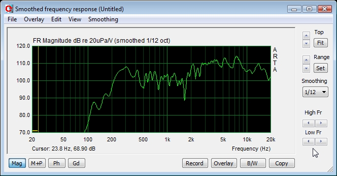

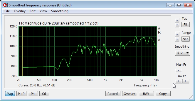

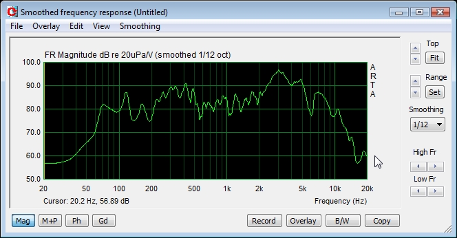

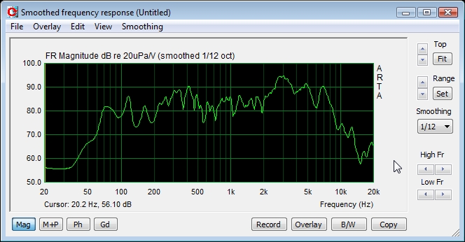

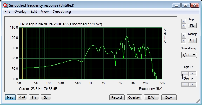

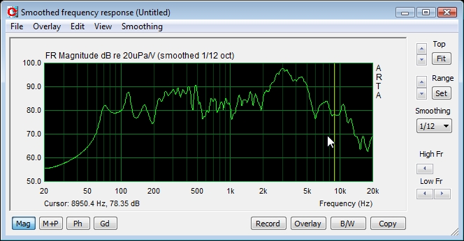

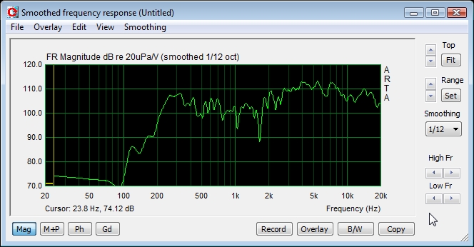

Here are the plots from 0 to 90° (driver in open baffle). Sorry for not knowing how to integrate them in ARTA.
Removed the main diaphragm, leaving only what I thought would be the tweeter section. Result: The aggressive pro sound is gone, speech intelligibility is far better, and the bump differs less between on axis and off-axis. Now I'll design a notch and listen again. The big Lowther voice coil gives clean sound at levels one would never expect from a micro-fullrange driver. Seems that I am in the center of the mass market now. Bad for a nobody.

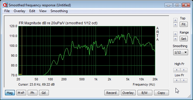

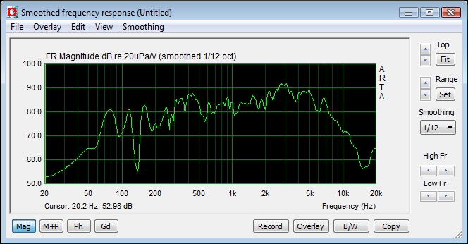

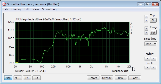

Here are the measurements of the current version:
Sadly the sound is very much on the aggressive side again. Meanwhile I tested the BMR, a fullrange driver developed by NXT that is also developed for ultra-wide dispersion. I would describe its sound character as the other extreme, kind of an easy-listening driver.

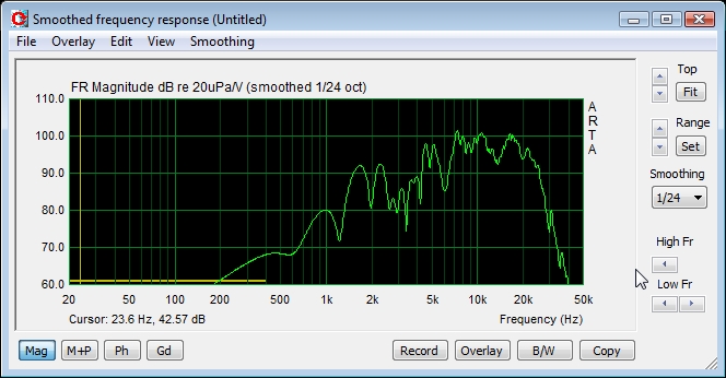

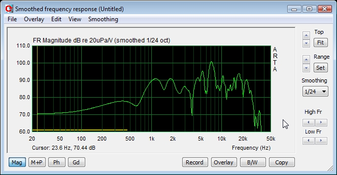

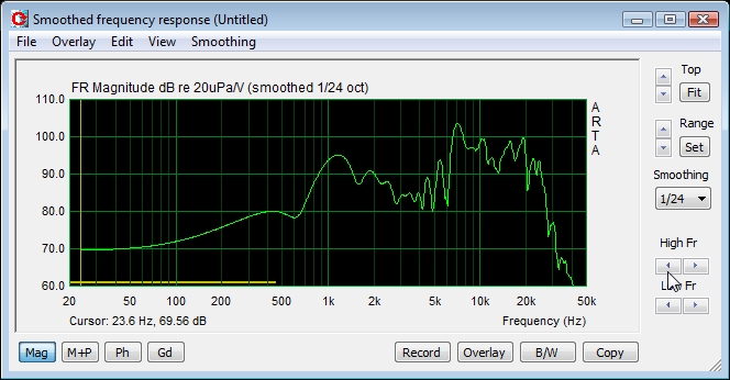

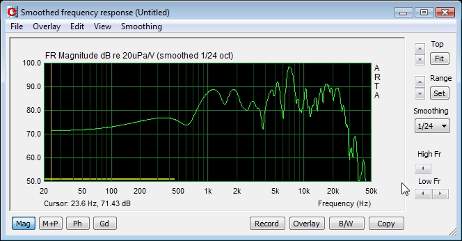

Mic distance is < 1 m.
I didn't like the massive smoothing of gated measurements (no idea whether this problem can be fixed, I'm no ARTA expert), so I posted ungated measurements.
Meanwhile I also amputated what was originally considered the tweeter diaphragm, leaving only what was originally considered the connecting element. The arrangement has no similarity with anything that is currently considered a sound transducer, but I like it best that way.
And yes, these are 15° steps.
Thanks. The graphs for 30°, 45° and 60° are exactly the same?

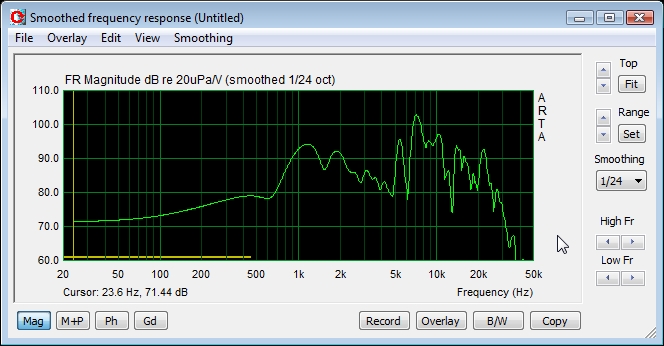

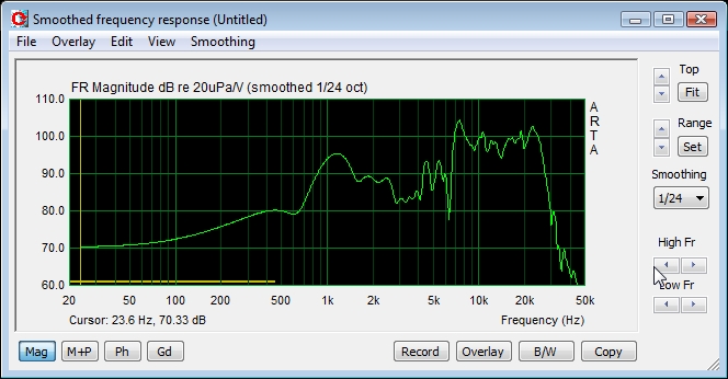

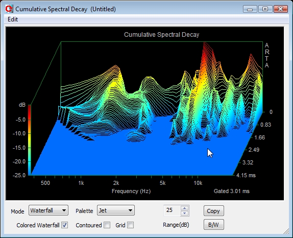

You would need to look at free field measurements to separate driver/enclosure effects from room effects. Gated measurements will help with that. Yes, it does reduce frequency resolution but so does 1/12 octave smoothing you used in the graphs above.

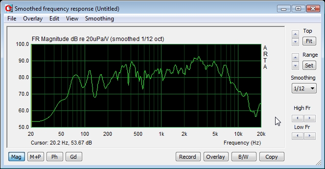

Gated responses of the "naked" version 0-75°, nearfield-CSD
I'm going to couple it to a very soft-sounding bass diaphragm, since coupling it to something hard always sounded untolerably harsh.
Any affordable driver that goes in the Spendor/Harbeth direction? I find Polypropylen quite muddy, and glueing it is not easy.
