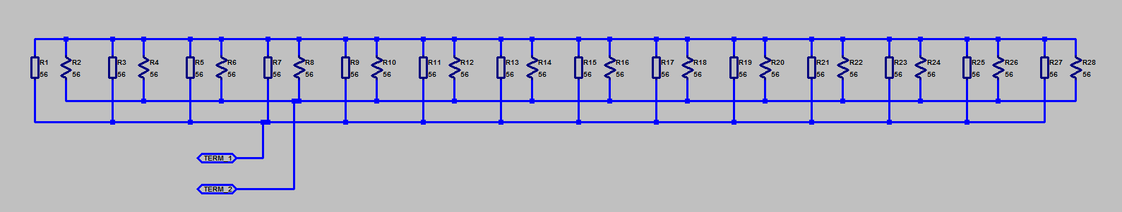

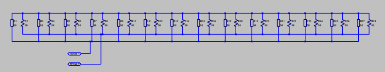

Does anybody have any tips or suggestions on how to create a noninductive load resistor (or low-inductance load resistor) using cheap 10W wirewound resistors in cement block packages?

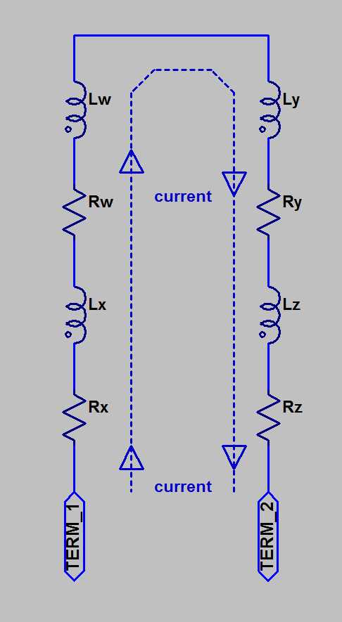

I am thinking I'll put N of them in parallel (reducing inductance by a factor of N) and then arrange the current paths to be in opposite directions. This will create a mutual inductance between adjacent resistors, and since the currents flow in opposite directions, the effective inductance will be reduced to (L - M) where L is the self inductance and M is the mutual inductance.
I just purchased qty=28 of 10 watt, 56 ohm resistors. I'll put 14 of them in parallel (giving a 4.0 ohm resistor), and connect that in series with another set of 14 ohms in parallel. End-to-end resistance is 8.0 ohms, and inductance is (hopefully) a lot less than (1/14th) the inductance of a single resistor.
Figure 1 below shows a schematic of my connection. Figure 2 illustrates the mutual inductance between a pair of adjacent resistors. Of course it's a distributed system but for compactness I've drawn it as two "lumps".
What do you think of the idea? Is there a far, far better way to get low end-to-end inductance when using wirewound resistors?

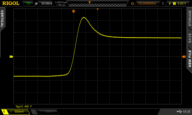

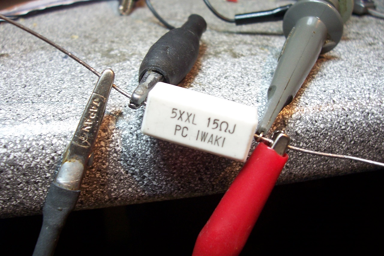

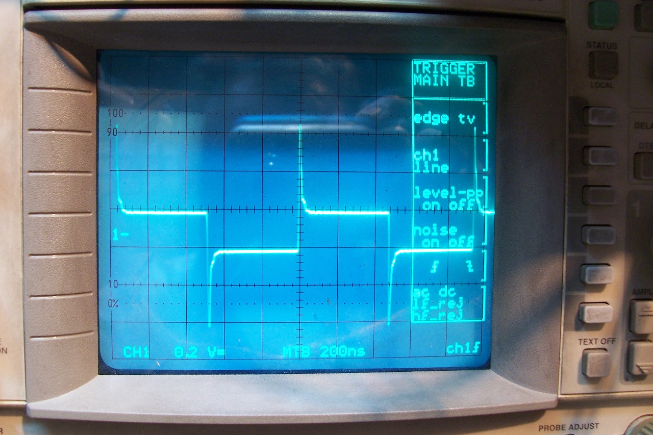

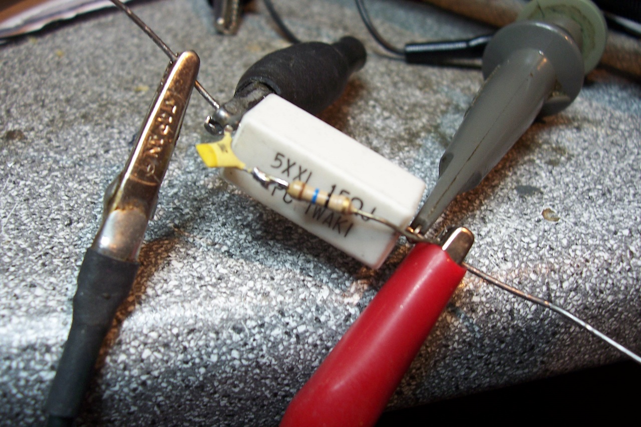

It won't work well, for the reason given by DF: the relatively small winding is enclosed in a relatively large ceramic casing, meaning the lines of field will reconnect inside, no matter what you do outside.
If you wanted to follow this "physical" route, your best option would be to wrap the resistors inside copper (or aluminum) foil, to make a short-circuited turn (and it would improve the thermal conductivity, which is important, because packing together many dissipation sources will be detrimental), but there is a simpler, and more effective option: compensating for the parasitic inductance is relatively easy, as the pics below show:
A 15Ω resistor is fed by a squarewave from a 50Ω function generator; the effect of the inductance is visible through the differentiating of the waveform.
A simple series RC network (16Ω + 2.7nF) placed in parallel is sufficient to provide a vast improvement. Note that this is a quick and dirty fix, with a E24 resistor value and a X7R ceramic cap.
With some tweaking, precision components (and perhaps a higher order network), the compensation could be perfect

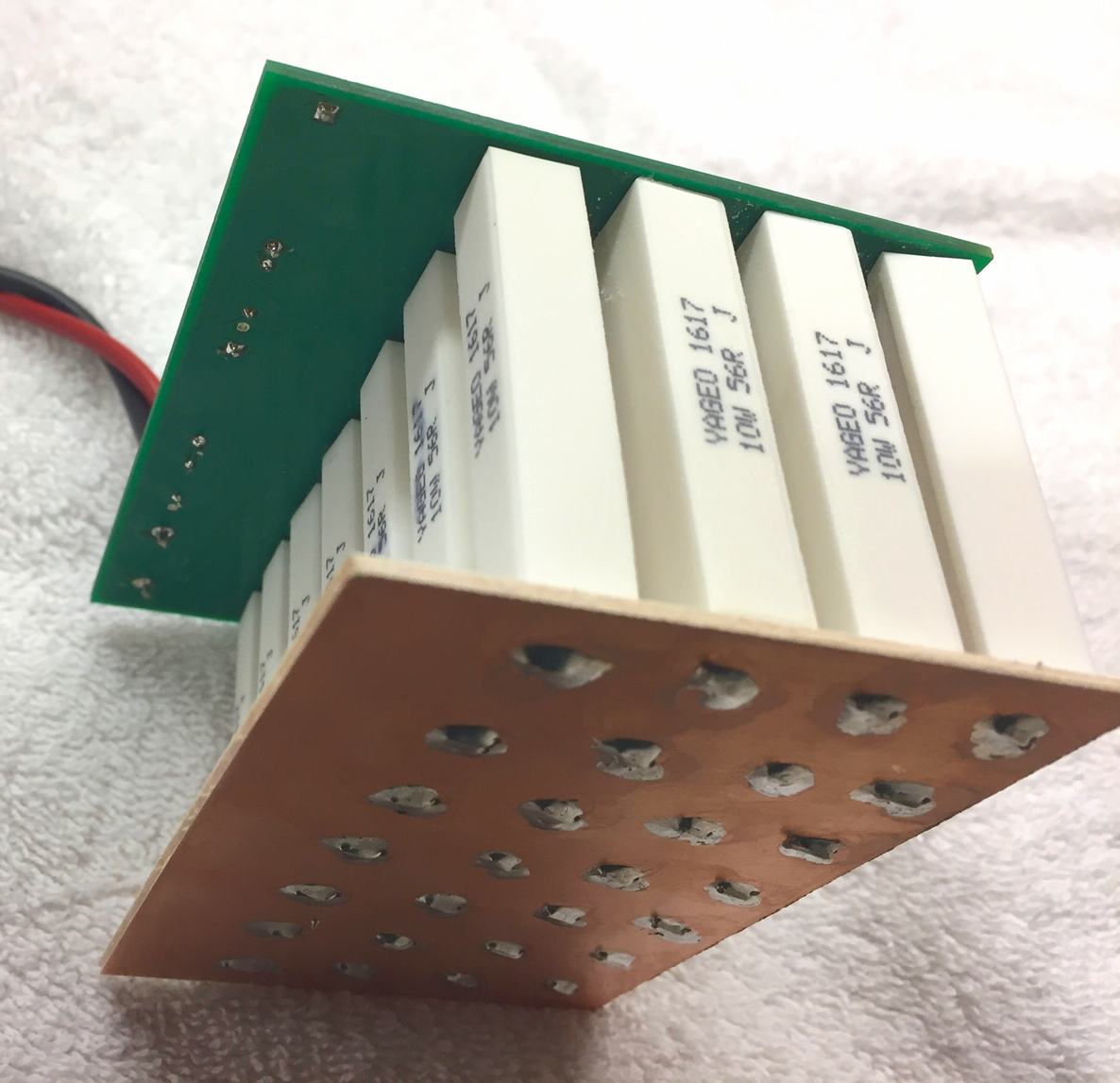

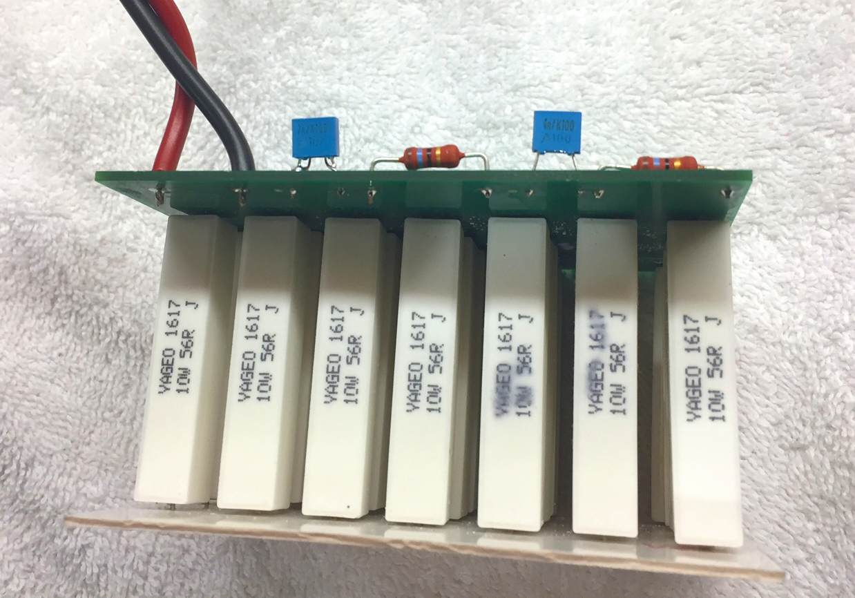

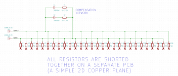

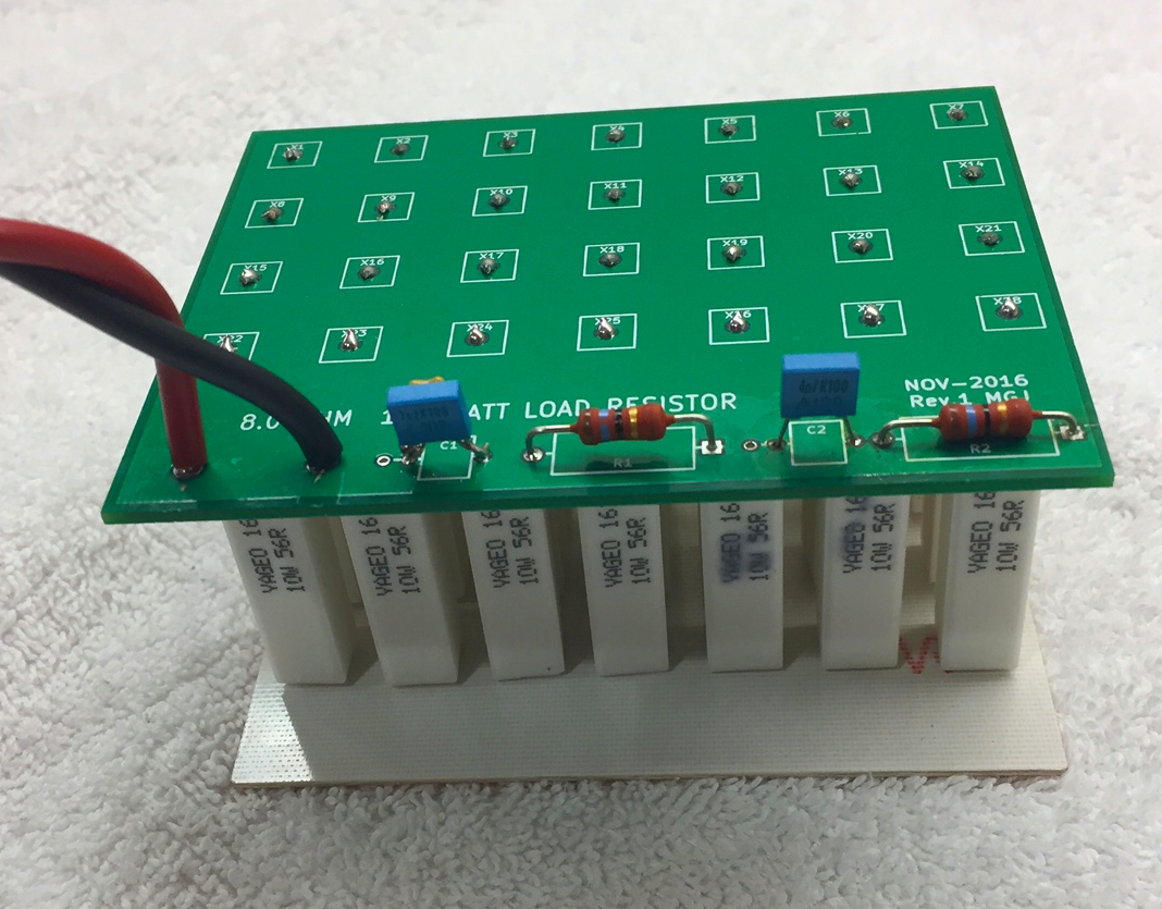

Built it and verified its lack of inductance
I was in a vile and ugly mood on Wednesday, November 10th, so to do something productive I decided to lay this out as a PCB and have it built at whichever fab gave the lowest price quote on pcbshopper.com . The winner was "Maker Studio" who charged me $15.56 for ten (dual sided) PCBs including shipping to California. Finished boards arrived five weeks later. And here is the end result.
Image 1 shows the schematic. There are three "planes" on two PCBs. The first two planes are on the PCB I sent to China for fabrication; the third plane is an un-etched, un-patterned piece of raw PCB stock; it's simply a shorting plane. The large X terminals on the bottom of each resistor, connect to this third plane.
Resistors are laid out "Cordwood" style, arranged in a checkerboard pattern. Resistors which fall in red checkerboard squares, have their top terminal soldered to plane TERM1. Resistors which fall in black checkerboard squares, have their top terminal soldered to plane TERM2.
A bit of twiddling around with a capacitance substitution box showed that the inductance of these wirewound resistors could be nullified using a (8R series 7.9nF) compensator. Thanks to Elvee for the suggestion. It is implemented as two parallel networks, for better power handling capability. I wanted a large margin of safety even when 75 volt, 100 kilohertz sinewaves are applied.
Scope photos of the array of 28 resistors, with and without the compensators, are shown in images 2 and 3. With no compensation, square wave input produces huge overshoot due to the series inductance of the wirewound resistors. After compensation is applied, the square wave response is acceptably good.
Photos of the first article appear in images 4-7.
I've got a couple spare boards which I'm willing to give away for free as long as you pay for the envelope and postage. Patterned PCB only; you have to source and cut and drill the plane3 unetched bare copper board yourself. Send me a PM if interested.
By the way it was a fun little brain-teaser to figure out how to thread a 4 x 7 array of resistor leads through a pair of solid & inflexible PCBs. Think about it for a minute -- it's not a completely trivial task.
