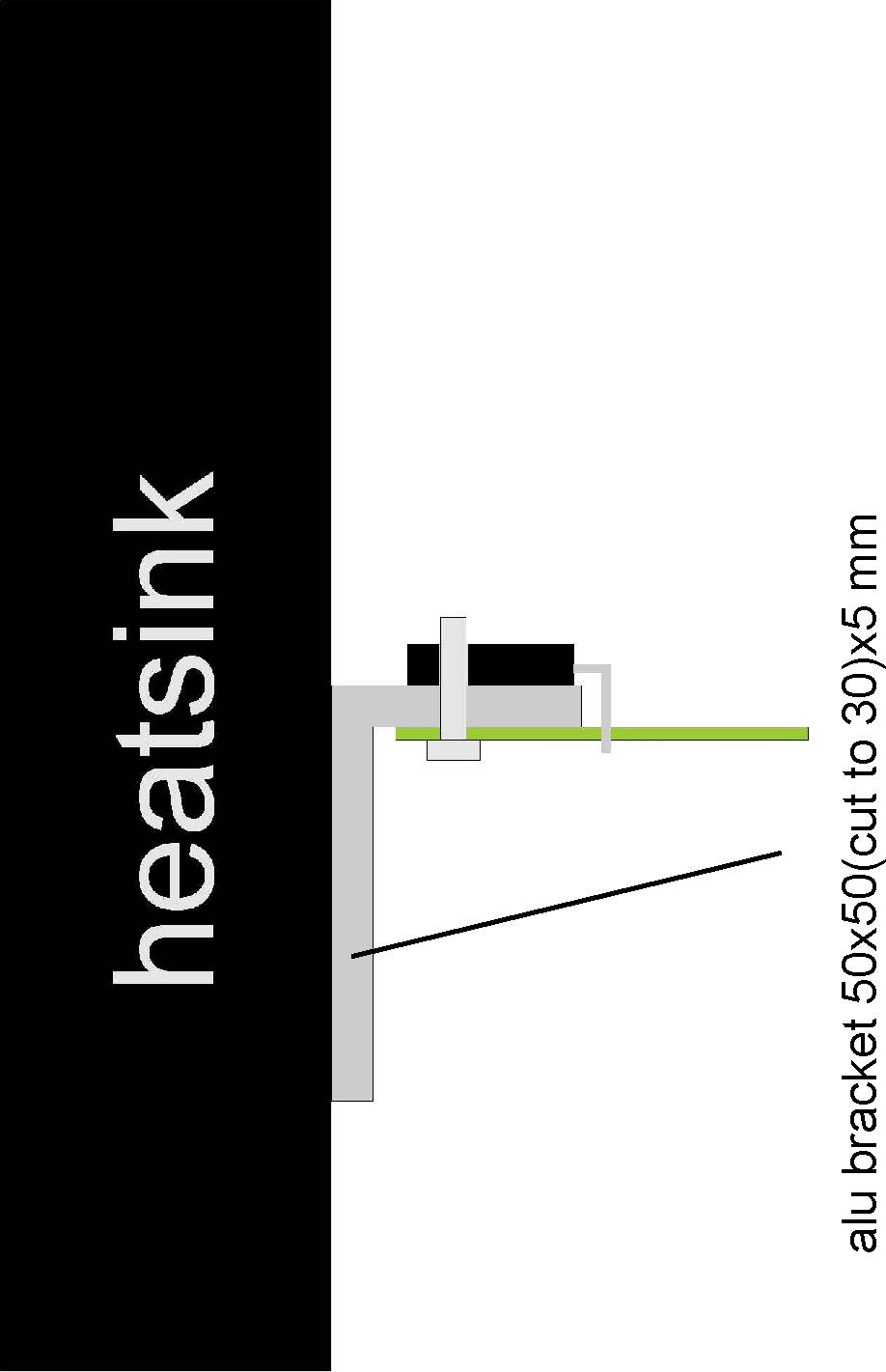

not only that he (jackinnj) can, he will (see photo below)... ;)
Second photo: suds PCBs & heatsinks 40x165x400mm (from other supplier)

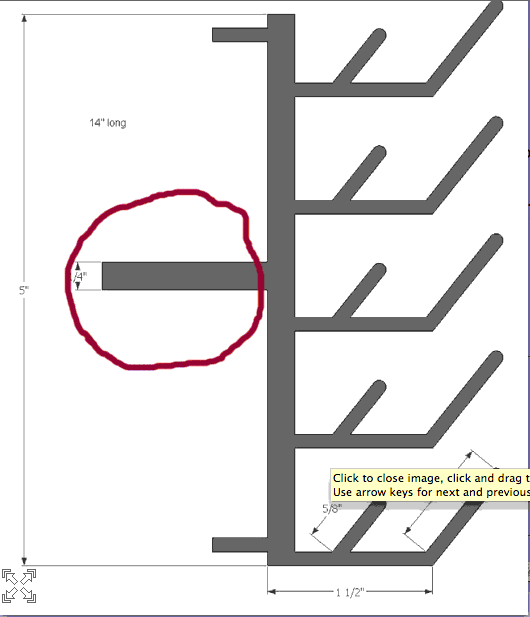

Hi, does your heatsinks work well with Sud's pcb??
For me with Sud's pcb is obligatory use a pcb with circle red part
