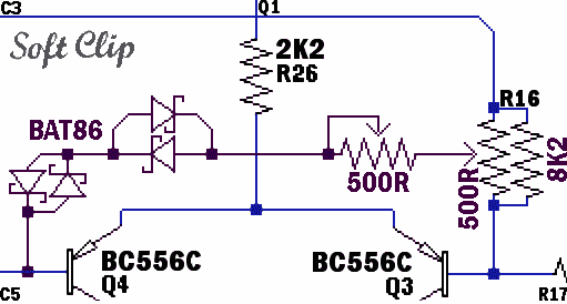

You're probably going to need the LTP soft clipper accessory fitted with one or two variable dials for adjustment. This device can restrain the situation so that the driver kick tonal distortion doesn't happen. The very quiet little clip (you adjust when this happens via convenient dial--just set it to block the bellering) allows the amp to recover from momentary overloads instantly and without the outputs sticking. I'd like to put an adjustable version of the LTP soft clipper on a sensible schematic for you, but I need to know if you're using the "regular" or the "cfp" edition of Circlophone?
The idea of lower HFE drivers looks good but doesn't help in practice. Outputs with higher HFE and still linear, would help. But those you've selected look pretty good. The actual problem is 150W to 4R with a single set of output devices. Simple answer: The LTP soft clipper accessory can be set for rapid recovery, to prevent the amplifier from getting stuck in a non-linear condition.Would that be fixed by choosing drivers which have higher HFE? Or different SANKENs for outputs?
Here is a new adjustable version (attached). The 500R potentiometer allows you to synchronize the soft clipper to fit your amplifier for instant recovery. The 500R variable resistor allows you to choose the force of the clip for softer or harder as needed. The dials do "when" and "how much." If you need it more aggressive, you can put a 470 ohm resistor in parallel with one of the diodes. All of the diodes are BAT86 or whatever sort you have used for D7. Low capacitance types are preferred. This accessory is easy to install and use.
