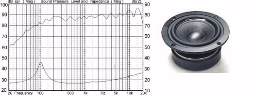

click on tweeters and scroll down to full range section. check this out:
Thanks guys this is EXACTLY what I was looking for.
I see you pointed to the W3-319 would this be the model you would recommend? (Looks like any one of them will do).

Well, not having heard any of them, I can't really recommend which one is better. The model I posted was the one I was looking into for a budget surround setup. As far as attenuation goes, you need an L-pad in line with the speaker. It's basically a high-powered potentiometer set up to keep the impedance (ohms) seen by the amp at the same level while attenuating the driver. You should be able to find them about anywhere. Don't know about the sub amp. I know that you can get 75 watters for pretty darn cheap these days. Look at www.partsexpress.com

Hey SteveG, where are the TB's for $4? Under 3" drivers I see them for $7, I'm assuming that the MCM brand 3" wideranges are just OEM's of TB's right?

Well, I thought that MCM was selling them for that. Maybe they raised the price back up when they realized that they would sell A LOT of them! Yes, the MCM brand are relabled TB's. If you look closely at the picture on their site, you can see the TB label. Sorry to give misinformation on the price! I thought they were down around $4.
