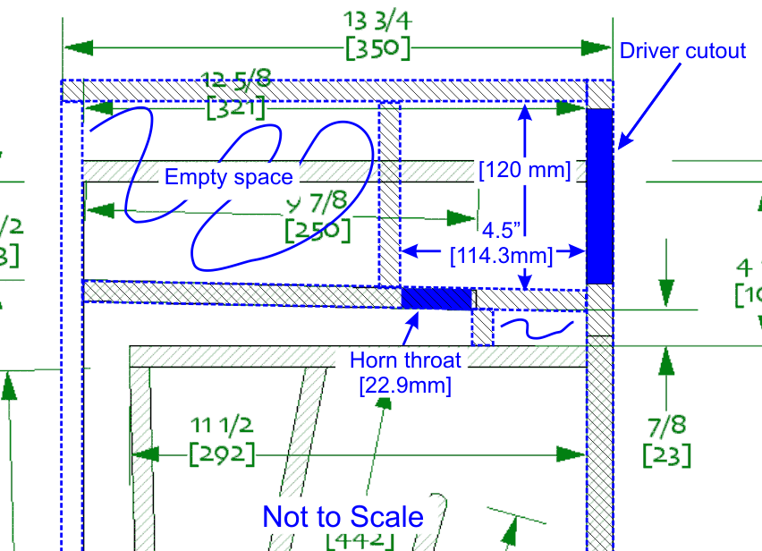

Widening the MKII is a good idea that will increase both the throat and the mouth area. However the plans that I have from the Planet10 website (http://www.planet10-hifi.com/boxes.html) show the width as 13.5 cm not 16 cm (?). Increasing the width to 20 cm should move the mouth size to about 11.2 Sd -- an improvement but I suspect probably not far enough.
The FE126 will still be a tight fit vertically (less than 15 mm to play with).

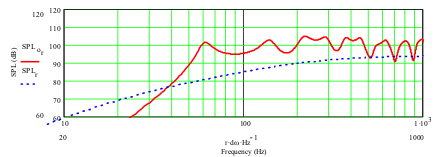

Just did some modeling of the FE126 in a MKII using King's MathCad worksheets (www.quarter-wave.com). I started with the 20 cm width and then tried 25 cm. Next I modified the CC by closing up the throat end and putting the throat at the back of the CC that shortened to 4.5". (The height of the CC must now be increased to fit the FE126). Further I adjusted the driver end and the throat end so that they both have an area of 1.8 x Sd. For the FE126 that's 65 cm2 x 1.8 = 117 cm2.

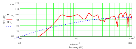

So what did this achieve?!:
The performance of the original modeled with a straight expansion attached.

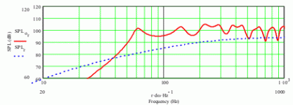

Now the results with the modifications attached (I think! - I'm still under moderation so I can't check immediately).
Modeling the horn as a straight, conical, or various hyperbolic-exponential expansion variants did not change the frequency ersponse much. The performance peak at approx. 60 Hz was raised to about 65 Hz and smoothened done a bit moving from a straight to conical to hyperbolic-exponential expansion.
The size of the mouth is still a limiting factor for the impulse response. Moving to a much better size of 18 Sd (or even better to 24 Sd) will improve this but not alter the freq response. Moving this high will require a change in the foldings as well (ie. abandon the MKII design).

The CC shape is up to the user and doesn't have to be box-shaped. Lengthening the CC without changing the area of the driver end and closed end increases the volume of the CC and can result in much more ragged (modeled) response. Increase the CC length to 6.5" here can be done by decreasing the areas from 1.8 Sd to 1.2 Sd. Further increasing the length of the CC here would require the area of the front and back of the CC to be unmanageably small (less than 1 Sd - smaller than the cone area of the driver).
As well in this particular design mod, increasing the CC will reduce the horn length and, because the horn is expanding it will also increase the throat area. I modeled the 4.5" to 6.5" CC change (with areas at the end moving from 1.8 Sd down to 1.2 Sd). Predictably the decrease in horn length slightly reduces the bass extension but surprisingly also starts to force a frequency rise from about 600 Hz to 900 Hz - probably not a good thing. Also the magnitude of the impulse response started to drop.

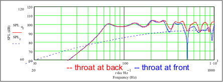

I built a pair of Ron's A126 Horns per the original plans, then modified the compression chamber both by increasing the volume and adding some diffractive and absortive materials.
As you alluded in your post #14, I'm quite aware that the math predictions and actual measurements don't always relate to what is heard, and have been known to say so, ( less than diplomatically.)
Your comments and graphs on the primacy of position of the throat in relation to the CC over it's shape are interesting - both the Hornshoppe and it's inspiration the BH MKI have the throat at the back of the rectangular CC. While lacking in lowest bottom octave, they both have far less of the coloration that I've referred to as "closed in" than I heard in the original A126, or for that matter the Buschorn MKII, or Fostex FE103BLH.
There's an interesting experiment for someone with a bit more time on their hands (and material to burn) than I currently have: build and actually audition two otherwise identical horns with the CC shifted to alter the throat location.

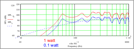

I just took another look at your graphs, FWIW, would modelling at a lower SPL, (say 90dB) have any affect on the degree of ripple? I get my hearing tested at work every year, and even though age and working environment have taken it's toll, my average listening is at the lowest volume since I used to leave the FM radio on all night long when I was a kid.
chrisb - The freq response curve stays the same but at lower levels (see attachment). Your hearing is not linear though (hence the addition of loudness buttons on receivers) so it will sound different. Another contributer to a different (better) sound will be the lower levels of IM distortion.
